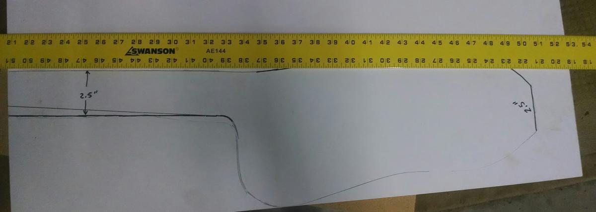

Ron and Bob, Thanks for the compliments and encouragement. I used another breast collar to make a pattern for the OSU collar. I did change the cinch tie down piece on this collar. I have been making them shaped more like the pulling collar, but thought I would experiment with something different. I will take your suggestion and try a little more taper. I made the pattern for the pulling collar by checking it on one of our mares. She may not have been the best choice (kind of thin in the neck area). If I understand correctly, you think it curves too much where it connects to the center dee. I plan to connect it through the handhole, but have not ridden with it. I will wait until it sees some use before I make another like it. I am looking forward to seeing my next saddle too. Randy -

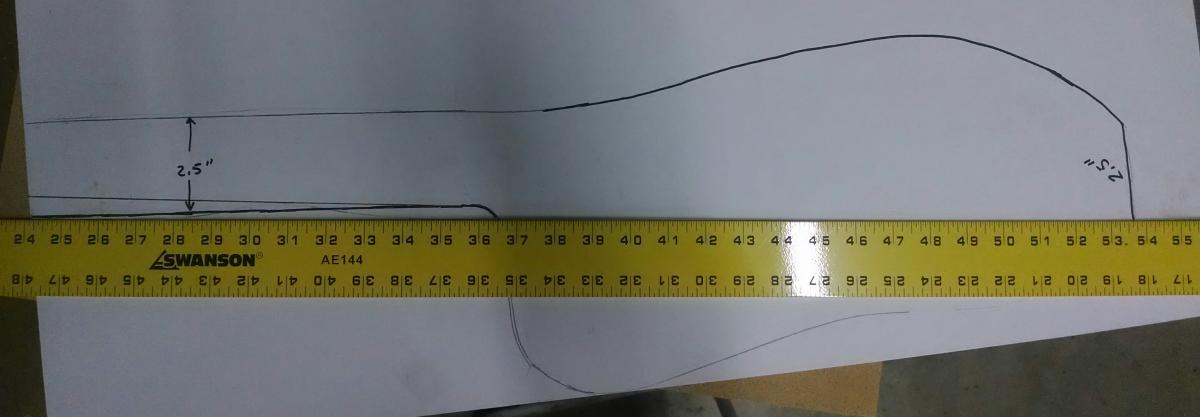

I just finished a couple of breast collars. I use these to practice sewing, stamping, etc. in preparation for building another saddle. The one is my first attempt at a pulling collar. I was made to match my first saddle. The top piece is saddle skirting and the back is latigo. All stainless steel hardware. The other was made for a friend of mine who wanted me to 'put my OSU stamp' on his breast collar. I informed him that it wasn't a stamp. I used his as a pattern and used the basket weave to match his saddle. This baby is heavy (double thick saddle skirting). I am considering getting "Crafter's License" from OSU and selling these. Comments are welcome. Randy
