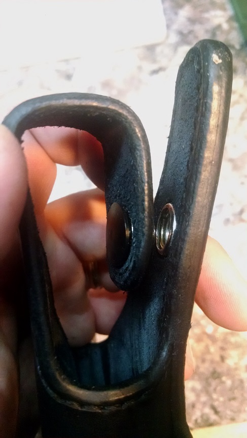

This is how I do mine, and I haven't had any complaints. I started out doing the half of the thumb break on the backside (side closest to the body) as just one piece of leather. I used to attach the snap and stiffener in the same fashion you did. I found over time that having one piece of leather got floppy. I use 7/8 oz leather. I then decided I would try to make the body side of the thumb break two layers of leather thick. I got this idea off an old Don Hume duty holster I had laying around. What I do now is I extend the reinforcement piece (or the belt loop piece if the holster doesn't have a wrap around reinforcement) up to the top of the thumb break on the body side. On the inside half of the leather I punch a 9/16 inch hole. This size hole fits a line 24 snap perfectly. Before I bought the actual punch, I used to use a 1/2 inch copper pipe cap that I sharpened. It worked okay for about six holsters. I attach the thumb break stiffener to the outside half of the leather with the snap and rivet(s). The thumb break is then sandwiched between two layers of leather. Heck, I may not even need a stiffener in there, but I really like the solid feel it has. The advantages are the snap protrudes into the holster about 1/16 inch beyond the surface of the leather. This reduces snap bulk in the holster, and I think leads to a little less pressure of the snap on the slide of the holstered gun. Also, I don't have snaps with posts long enough to hold in two layers of 7/8oz leather, so only going through one layer is advantageous. I've tried the plastic snap protectors and just don't like the bulk they add. The other thing I do different is I don't use the reinforcement piece as the only part that makes up my thumb break. I can use my main holster pattern to make a thumb break holster with or without a wrap around reinforcement piece. I see the body side of your thumb break extends upward past the slide a ways, but I assume that is to act as shield between the hammer/beaver tail and the body. When possible, I like to have the body side of the thumb break stick up above the slide only slightly. The reason is it minimizes printing on the cover garment. However, I don't like the snap to be too far down from the top of the slide either. I have ordered stiffeners from High Desert Leather (HDL) and recently The Blue Gun Store (BGS). Both companies were good to work with. The HDL stiffeners were longer than my personal preference, so I drilled a hole in the center. I used the new center hole for the snap and the existing holes for the rivets. This allowed the snap to be my preferred distance from the top of the slide. The BGS stiffeners are slightly shorter than HDL's and very stiff (HDL's are a little flexible). I will be adding a drilled hole to BGS's stiffeners as well. For now, I don't buy in sufficient quantities to order from some of the other thumb break suppliers, so I modify the ones I can get. I like the body side of the thumb break to be trimmed back so that the thumb (and meaty part of the hand next to the thumb) doesn't go over the holster. The idea here is that a full grip can be obtained on the holstered gun and not have leather stuck under your hand. This can make it difficult to smoothly draw. As far as determining the length of the strap piece that comes over the gun, it sounds like you got the right idea: leave it long until you are to the point in construction where it can go over the holstered gun. I then use the snap on the body side to make an impression. If the strap is not going to be stitched, I subtract about an 1/8 from where the snap impression is. I then stretch the strap during wet molding, and leave something thin (like a 3/4oz leather piece) under the strap but on top of the rear of the slide. This seems to make it snap shut perfectly when all dried (at least on Glocks). If the strap is going to be stitched, I tend to go where the snap indicated the hole should be on the strap, or maybe add a smidge. Stitched straps tend to not stretch, and seems like they can shorten just a little too. And yes, the placement does need to be a little more rearward. I have a holster with the same issue that will forever hang over my bench as a reminder to myself. As my leather works specialty to the left reads, "Learning from my mistakes". Hope this made sense. It's just how I do it, for right now... -

Here are two holsters I finished today. They are both hand stitched. I'm particularly happy with the light bearing holster (only took me three tries). The light is a pretty nifty Streamlight TLR6, which is a light and laser combo. The leather is 7/8 oz Hermann Oak. The thumb break has a stiffener from High Desert Leather sandwiched between the leather. I drilled a hole in the center of the stiffener to accommodate the snap post (it came with just the two holes - one on each end). The inside layer of leather of the thumb break sandwich has a 9/16inch hole punched in it so the snap can be mostly recessed, thus minimizing some thickness of the snap (and allowing the snap to attach to one thickness of leather). I am also very happy with the slot for the trailing belt loop. I recently had Texas Custom Dies make me a slot punch. It makes the slot 80% easier than drilling two holes and connecting them.

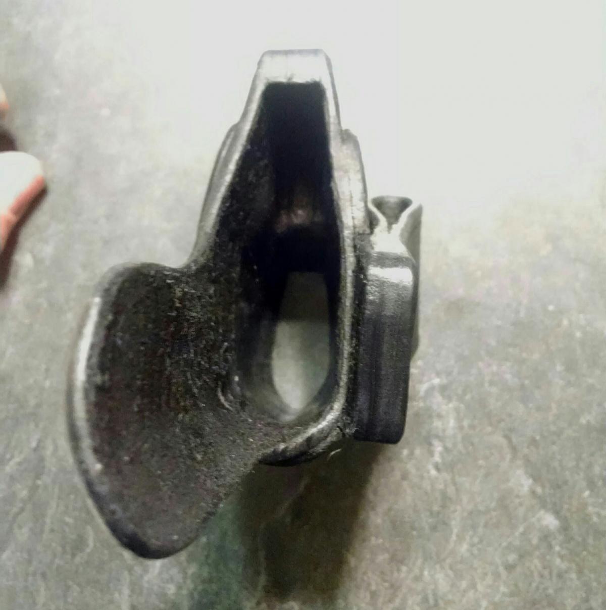

This is one I made for a friend. He told me he wanted a IWB SOB holster that had the grip down. I researched it on this forum, and learned the concerns (tendency to point the muzzle at your hip after the draw). I explained all this to him, but he wanted it anyway. He's a trained and competent gun handler, so I made it. After I got into the project I realized it was a pain. The holster can't be canted much or the grip would be too close or below the belt line. This was a problem unique to the IWB. He's had the holster for four months and reports good comfort and concealabilty. Holstering is difficult for him (maybe with all SOB holsters?). And he said where the belt loop attaches to the holster is a bit floppy. I figured it's main function was to stabilize the holster vertically, and the belt over it would keep it tight to the body. I never posted these pics before, because I wasn't all that proud of this design. I didn't even charge for this one. I told him I'd consider it a prototype and wanted honest feedback for in return. In summary, try to explain why a SOB holster (IWB or outside) is safer with the grip up. Have him simulate the draw both ways with his hand. It requires concentration not to flag your body with muzzle when the holster carries the pistol grip down, and that's when there's no stress. -
