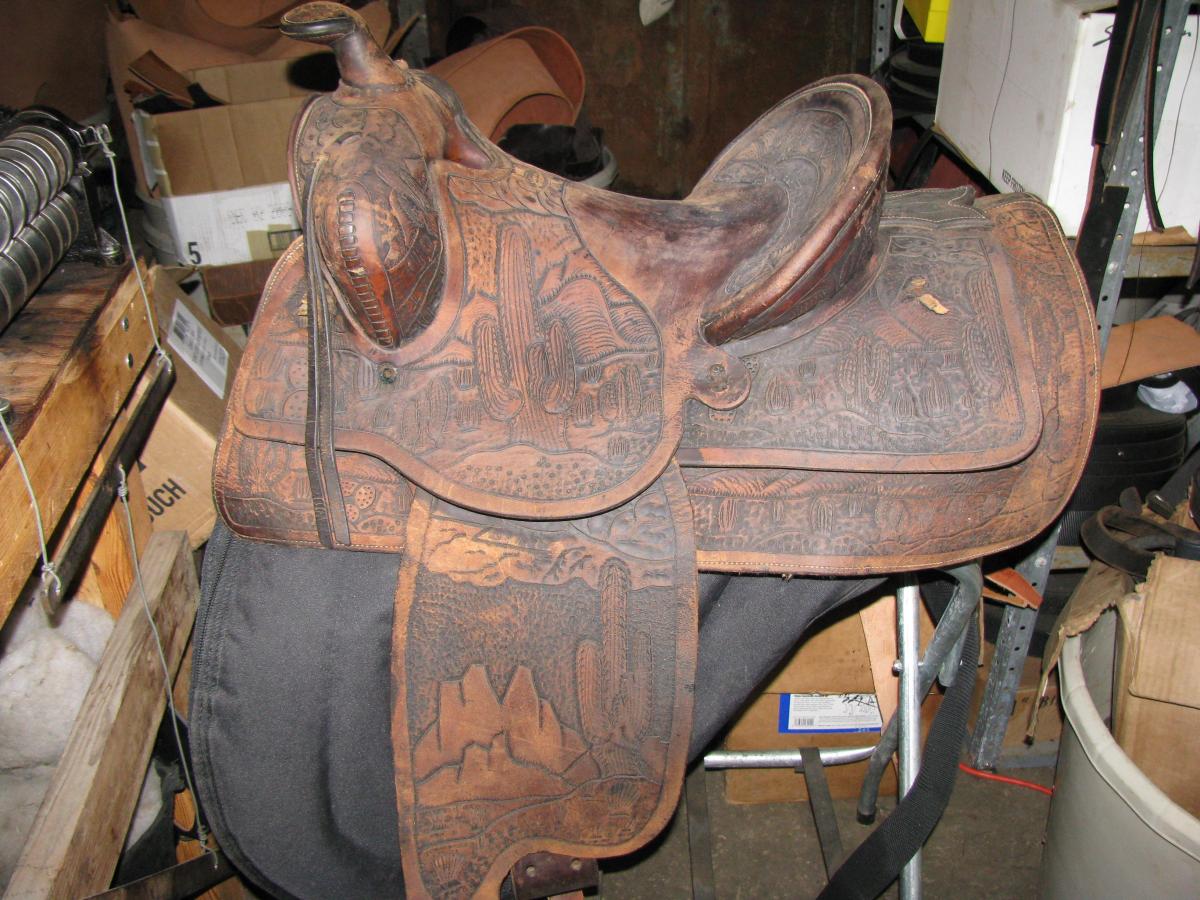

Here is a Keyston Bros saddle that came to me just this way a couple years ago. I'd never heard of them before. The owner had "cleaned" it before he brought it, and did irreversible damage to the leather. I did what I could, and it ended up not looking too bad. -
Just going by the look of this saddle I would guess it being made in late 60's to mid 70's, but definitely not 75 years old. I also would say, like toot, about $300-400. Even though it's a roping saddle, serious ropers aren't going to pay a bunch for it, because it's got some age on it, which means at the least, a couple different things. Even if the tree is in good condition, it doesn't have the strength of a newer saddle, and second, it's a look which is long out of style. Ropers like to be in style as much as anyone:-) Horn caps are smaller and horns set straighter, seats are flatter, and the roping saddles have a little more swell. That's for the arena saddles anyway. Look like a doggin' saddle. All of this does NOT mean it is not a good saddle, it just means it's probably worth about 300-400 bucks. But it's actually worth whatever you can get out of it, so I'd ask more to start with:-)
