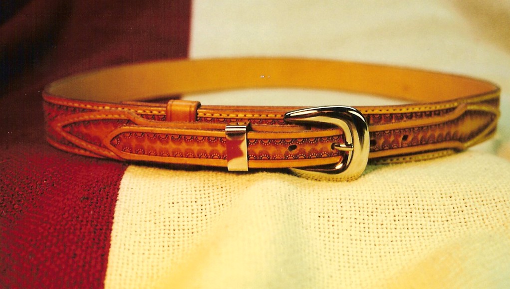

two ranger belts
robert replied to robert's topic in Purses, Wallets, Belts and Miscellaneous Pocket Items
Hi Cecil.. not sure i can explain, but maybe a pic along with the words will help. the end without the keeper laces into the keeper, on the back side. then the front 3/4" billets buckle together. Does this help? -

two ranger belts
Thanks all for the nice comments. Mike, the stamp is a Barry King. It appears to be a size 1.25 based on his latest catalog, but I wouldn't swear to that, as the size isnt marked on the stamp. I have two of his baskets - they are soooo clean and nice - I quit using any of my tandy basket stamps once I got these. Thanks for the comment on the knife work - an old saddlemaker in the area did that on his belts, and I just copied the idea. It adds a nice touch, and distinguishes the belt as hand crafted. Ryan, i will give your method a try - since your only "resist" is oil, does it turn out significantly darker? Russ, thanks for posting that tutorial in basketstamping - that is how i do it, except i dont use a protractor - i just sort of eyeball it. I learned that method from Chan Geer and it works really well. -
two ranger belts
it's right - the back layer of the other end laces through the keeper on the backside. the buckle set will have silver keepers for the 3/4" billet... does that make sense? thanks for the nice comments!
