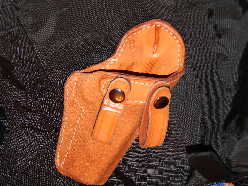

The saddle tan gave it a reddish sort of tint (based upon my color preception)... Thanks -

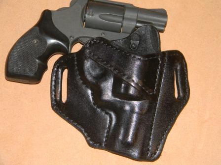

Learned that saddle tan doesn't look that good on ostrich. Good thing it is a pocket holster… Tried to do an avenger style. dont have the belt angle right yet.... another one for the learning ben.... J frame revolver ok. Seems to be a little too high above belt. No flop but with a lesser belt there could be.... What do you think?
