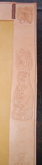

This was my latest project for a friend of mine. He has this real nice dark wood desk that he wanted a desk protector for. This was the final product. Since he was not concerned about writing on the surface there were lots of options for the backing material. I did leave the inner edge of the top and sides loose so that a heavy paper could be inserted for a writing support surface. The carvings are Native American Totems. The top and sides are from 5-6 oz leather. The back is suede buckskin. The top and sides are butted together and hand stitched. The suede was machine stitched to the sides and top (my first machine stitching project) on an Artisan TORO 3000 using a Schmetz NM:180 Size: 24 794 D needle and Linhanyl #277 thread top and bottom.

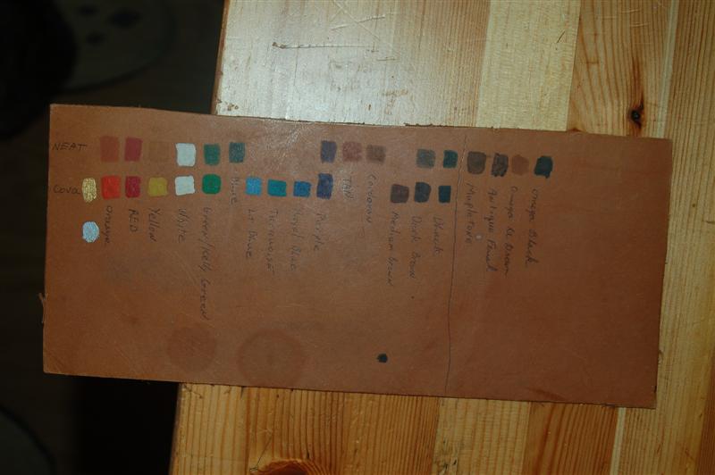

When dealing with dyes and finishes, I have found it helpful to make a test palette using scrap leather of the same quality used in tooling. Here are the palettes that I have made to use as a reference. -

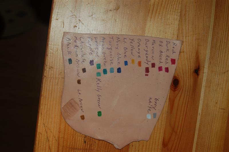

I have found that making color palettes using scrap leather of the quality and tanning that I normally tool an invaluable tool to understand the results of the dye. Here are the palettes that I have at my bench for reference: File 1 is a palette I made back in the 70s. I have kept it as a reference and to see the affects as the leather darkens with age. File 2 is a current palette of the Oil and Alcohol base dyes (Tandy & Fierbing's) File 3 is from the new Tandy Eco Flow Highlighters File 4 is of finishes that I use or preservatives in the case of Lexol (Non Darkening Blend) The two books I have for reference are: Coloring Leather by Al Stohlman (Stock No. 61942-00) published by Tandy The Main Technique of Coloring Leather by Peter Main, published in 2006 by The Australian Leather Craftsman Publications (available from his web site at www.petermain.com) Both books have good. Peter's explains the techniques of going from a light shade with spirit dye to a darker shade with the same dye. Both have very good comparison charts of dye colors and thinned and straight, over coloring (one color over the other and then reversing the combination actually yields slight changes), and finish affects. Don't be afraid to experiment. I look forward to seeing some of your work. We all want to help and grow this art form. -
