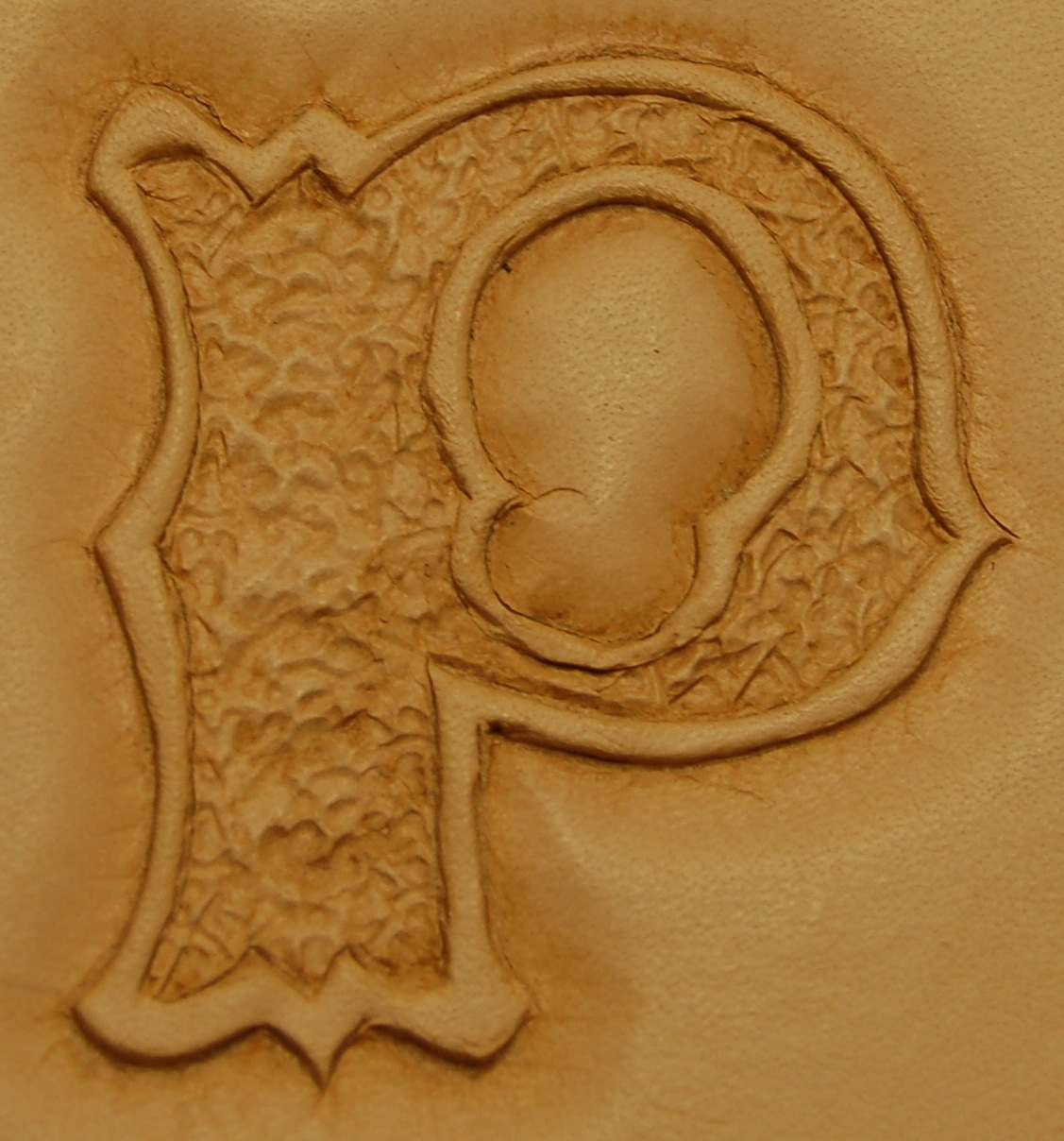

Tom You are correct. The letters are from Al Stolman's How to Carve Leather, Page 48. I used Craftool E 294 series for the internal pattern. Hear are the close-ups of all three letters and of the Totem. At this close inspection, I can see my mistakes and areas I would do differently in the future, e.g. better use of the E tools to match the interior cut lines, smoother beveling of the outer lines, attention to detail at the points. As a software engineer there was a saying that the software would be done when they pried it from my dead cold fingers. Oh, well, time to let it go and get on with the project.

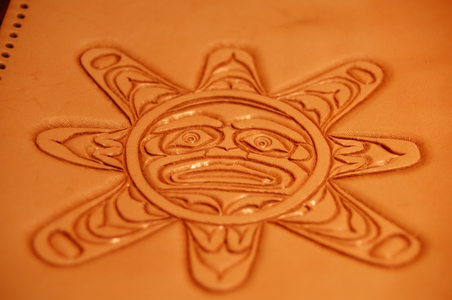

Here are my latest two Totems: Sun and Moon. I have no modified the guidelines that I had earlier in this thread. I have now combined what Bob does with what I have do. The basic guidelines go like this: 1. All Form lines are beveled away from except where form lines merge or run next to each other (Black next to Black) 2. In the case of form lines running next to each other, the separation line is enhanced with a modeling tool and edges are rounded off. 3. All White ares are beveled into. 4. Where White areas are separated by a thin black line, then both sides of the line are beveled into the white area. 5. Tool the White areas first. I am still working out what to do with the tertiary areas and lines. My best guess is that these areas are left up to the artist to resolve depending on the totem they are working and the "Look" or "Feel" of the overall totem, e.g. use a shader, figure, or matting tool and is it textured or not (depends on if the final totem is colorized) I don't want to have a set of guidelines that then inhibit creativity, but I do want to try and keep the Art Form but expanded it from a 2 dimension art form into a 3 dimension art from that is available on leather, similar to what the Totem Pole carvers did. Let me know what you think.

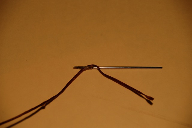

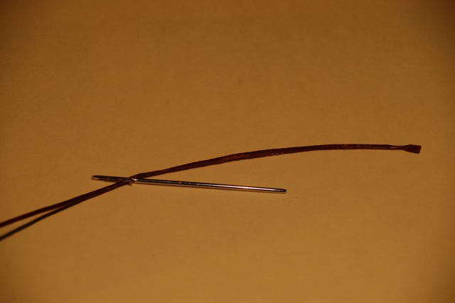

Sorry for not sending these sooner. I use simulate sinew for all of my hand stitching. This sequence of pictures shows how I: 1. loop the sinew back over the tip of the needle; 2. Move that back across the needle and eye to form a closed loop; 3. The last thing I do is to hold both runs of sinew while rotating the needle to twist the loose end around the sewing length to help lock the needle in place. I hoe this helps. -
