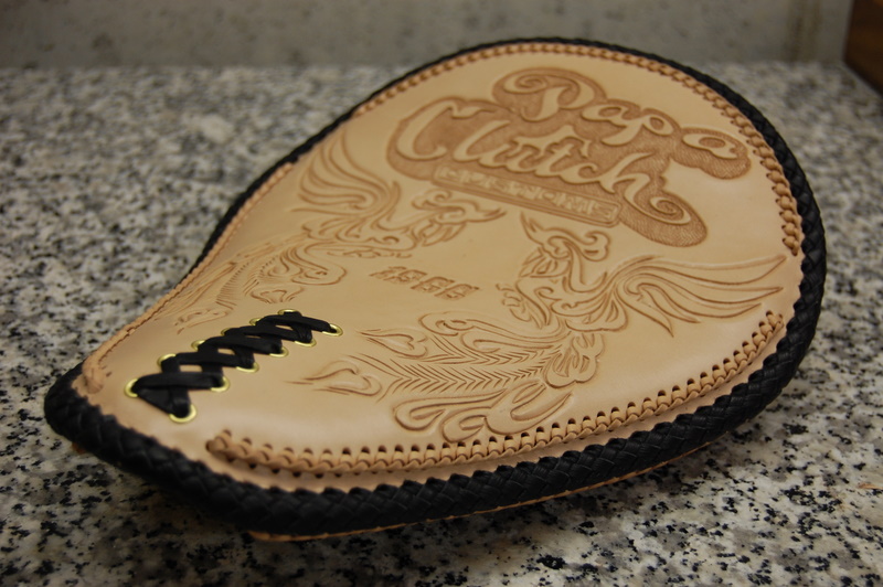

  5. Hey Spinner, I always tie my seats together temporarily (I tie them together in about every third hole) and cut the temp ties as I lace it together. The are only two pieces. The close fit is due to the thinner padding 1/2" to 3/4" and a pattern that fits correctly. Dave
  6. Thanks for the nice words guys. The lacing holds the top and bottom together...no hinge action though, That basketweave lacing is as hard as a rock.... there's no flexing there. The seats are assembled with no glue by the way David Theobald

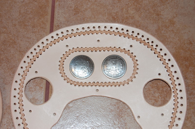

  12. I finished the seat assembly and lacing tonight Hope you guys like it Dave Theobald

  14. Hey all, I've been working on a bike seat for a dealer out west.... Here is how it is going so far. Feel free to comment....I always try to answer any and all questions. David Theobald
