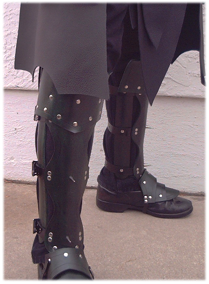

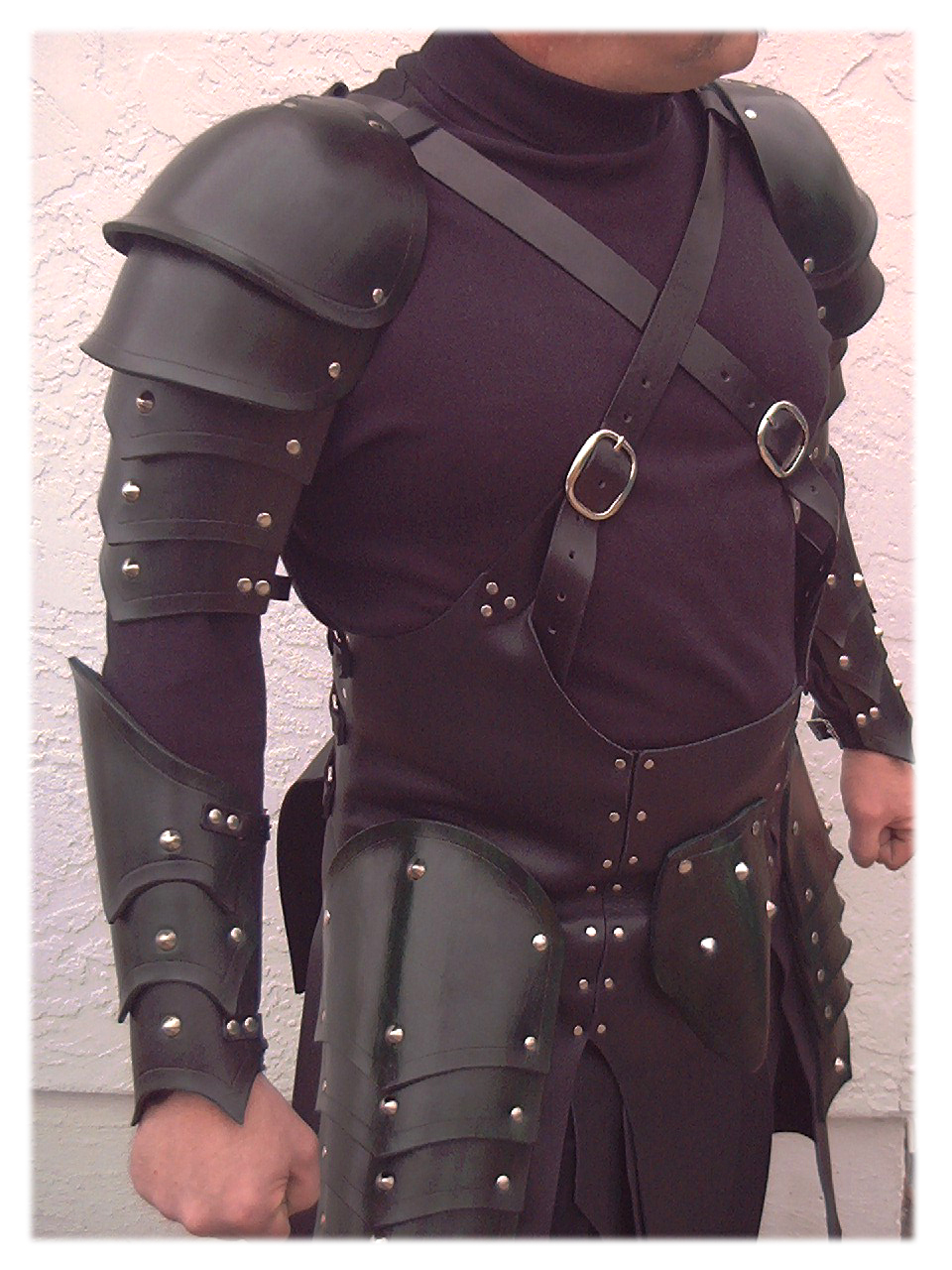

  4. I just wanted to share some pics of the completed Drow Ranger leather armor costume. I had never worn a wig or makeup for any of my pictures, so I was really pleased to see it all come together. This armor will be seen at Cirque Du Soleil, Florida "Festival of the Masters" show in September 2008 in the color green. This armor is black. www.cirquedusoleil.com This is my artistic interpretation of the look, created by the honored fantasy/sci-fi artist Todd Lockwood, for the Drow Ranger Drizzt Do'Urden of the novels by R.A. Salvatore.

  14. I use saddle skirting, which is usually about ten-to-fourteen ounces in thickness. I've found the thicker, stiffer leather tends to keep its shape better after being wet-formed. I wet-form my plates with tap water, temperature doesn't matter, and it hardens the leather well enough to take a beating. After I wet-form and dry my pieces, I apply a finish to the front and back, so that the formed pieces won't soften or lose their shape if your armor happens to get wet (sweat, weather, blood, gore). ELAD
  15. Azmal, Love your fantasy armor on Deviant. It is some of the best I've ever seen, and I've seen a lot and made a lot. Great use of texture and color. I think your tooling skills are quite adequate for "blinging" out your armor. It looks to me like you're an armor-artist before a leather-artist, so that's where your focus should go. On the Lion armor ~ as mentioned above, most people won't notice the little differences on your tooling. Can't wait to see your sketch come to life. Keep up the amazing work ~ you rock! ELAD
