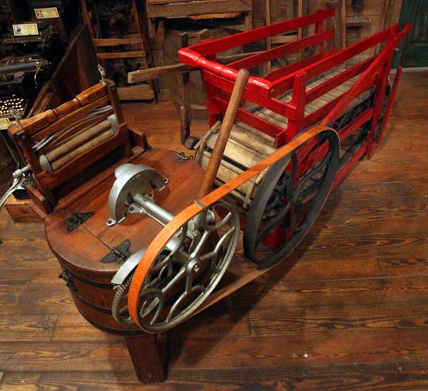

I am thinking that if i were to build a shop for off grid use, I would line shaft it and power it by an engine that i can also use to keep the grass down, fertilize the garden and then eat after. A standard clutch with no motor will work with a line shaft. As a matter of fact they have motors with a stub out the other end for a line shaft pulley so the machine can either be used line shafted or electric. Now for my power unit i give you the age old idea of the goat treadmill (this one powers a washer): Also can be powered an additional way. If i'm gonna feed the bastard anyways he may as well work for it: -
