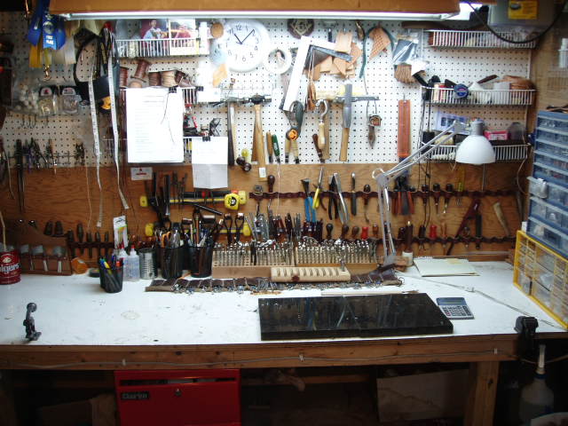

The first two are pictures of my old shop that was in my basement, the last two are of my new shop with lot's more room and better layout.
Got to my web site, www.cornelius-saddlery.com there are some pictures of my shop there that may give you some ideas.
