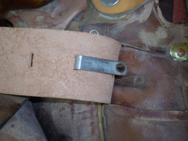

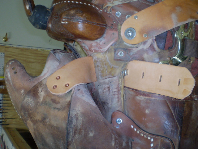

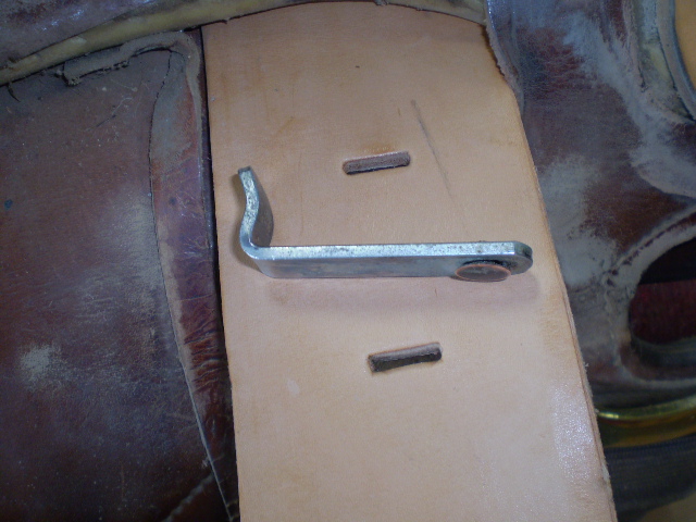

I thought I would post some pictures of a Monte Forman Ballanced Ride saddle that came in for repair. You don't see too many of these anymore, they came out in about 1954 and started in the Falls Saddle shop but several saddle makers and saddle companies produced them under the Monte Forman name for several years. They became very popular in the 70's and 80's as I recall. I had one for a time but traded it many years ago. I am not sure if they are still made or not, maybe someone else has more info on them. Anyway they are kinda different so I thought I would post some pictures for those who may have never seen one. This way you can ID one if you come across one. The main thing is these saddles have a swivel, two piece stirrup leather. You can see by the photo the swivel just under the front jocky. Then there is another short stirrup leather that goes over the tree and then is secured by a small metal "L" shaped bracket or hardware piece. When pulled tight this bracket prevents the leather from coming out of the tree and is what is used to adjust the stirrup length along with the leather coming from the swivel. The main thing that these saddles do that most will not is they have a great amount of stirrup movement. You can touch the neck all the way back to the tail on a horse with your boot and never take it from the stirrup. Be glad to answer any questions I can. Randy Sorry about posting this twice, don't know what happened.
