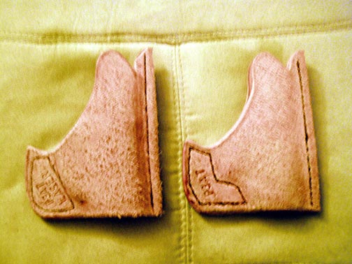

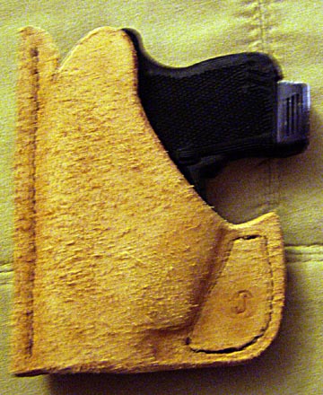

Good looking holster, and I'm not worried about you stealing my thread. Thanks for the picture, as it answers my question about the rough out leather looks with Tan Kote on it. Thanks, John -

Thanks for the advice. I haven't tried Tan Kote yet, but I will on my next rough out holster. I just wet and burnished one of them, and the other one I used bee's wax and rubbed the other one with the back of a piece of cloth backed sand paper. It's probably similar to the denim. both came out reasonably well, but I probably won't bother with the bees wax in the future. One question I have tho is, I use the rough out to help locate the holster in the pocket, but will it work as well if I have Tan Kote on it? John -
Hi all, here are photos of my first two pocket carry holsters, and I am going to put these at my friends gun shop, and see if they will sell. One is for a Kel-Tec P3AT with a C.T.C. Laser, and the other one is for the gun alone. They are just simple rough out sleeve style holsters with "horns" top and at trigger guard to help keep the holster in the pocket during the draw. I still have good days and bad days when it comes to stitching, but I am working on it. Sorry about the photo quality, but I am working on that too. It's not that I don't know better, just sometimes I don't do better. Maybe 1 out of three ain't too bad? Here are the photos, let me know what you think. John
