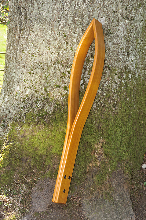

With lots of encouragement from JIMSADDLER, BARRA, and THE CAPGUN KID (see other stitching clam threads) I've just finished my stitching clam. It was made by steaming four veneers (approx .375" thick) of "Pacific Coast Maple" that were formed in a bending jig. It's 36" long and 3.375" wide which is perfect height for stitching while sitting in my deck chair. The "throat" is just under 4" at the widest point and about 19" in length. I couldn't have done it without my forum friends. Thank you!

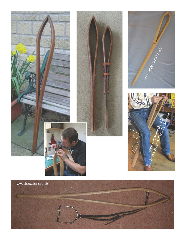

This image shows a collection of stitching clamps I found on the internet. They are similar to what "The Capgun Kid" was describing in his other post. You'll see one clamp is made in France by Vergez-Blanchard and another is sold through Bowstock in the U.K. Cheers, Lippy
