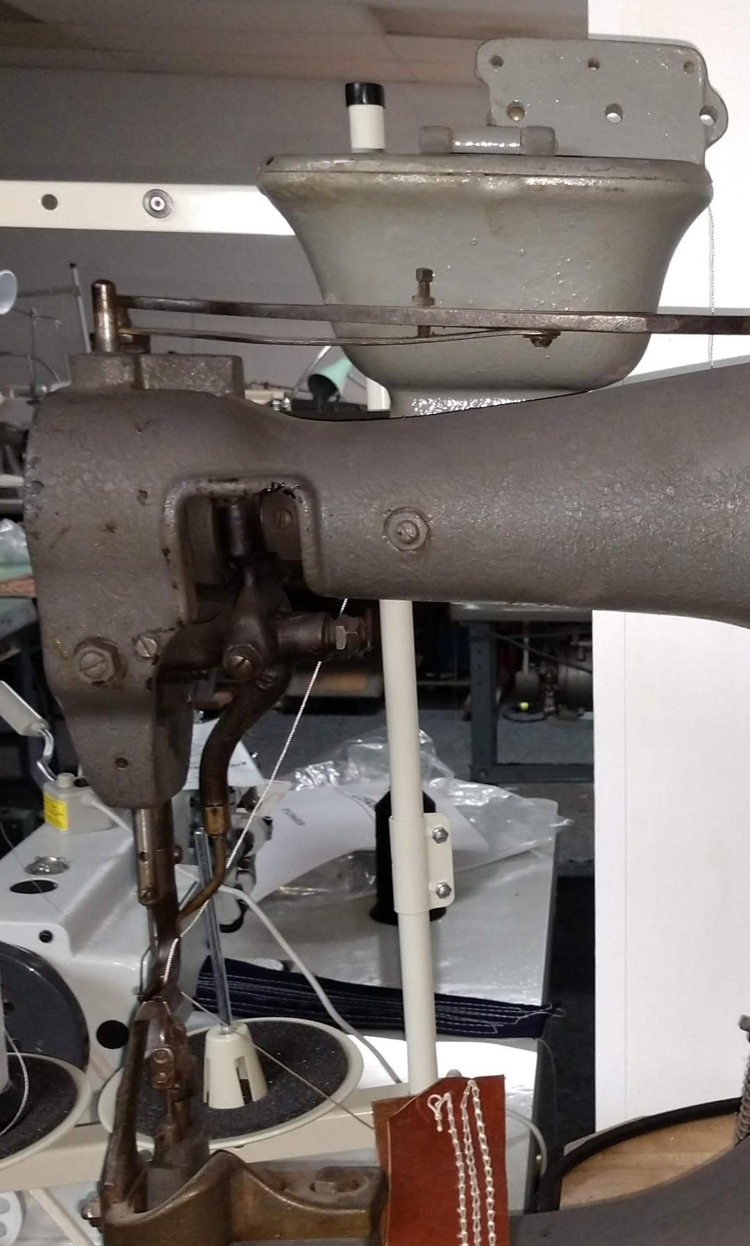

  2. @Steve855 It's called a drip pan all it does is keep the oil off of your pants & floor that drips off of the machine.
