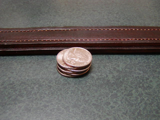

As stated, you may make a belt from any combination of weights of leather. What you have proposed would certainly be suitable for the heaviest handgun. Whether you use 9/10, 8/9, 7/8 or any of the heavier leathers, I would suggest that you either (1) delete the liner at the tongue, or (2) utilize billet straps for the buckle and tongue (ranger-style belt); otherwise it will require a specialized buckle to connect such a thick combination. Any of the veg-tanned straps you mentioned would probably be suitable for belt-making purposes. You really don't want pre-beveled or finished edges, as you will need to dress the edges after construction anyway and that would actually add more work for you. Unless you are dealing with the heaviest applications, you might want to consider using a primary strap of 8 to 10 oz. weight, then a lining of around 3 to 5 oz. weight. This results in a very sturdy belt that is somewhat easier to wear and use for most purposes. As for the idea of pre-forming the belt around an object, that might work pretty well. I like to finish all of my products with neatsfoot oil, which provides flexibility in the finished piece (it also profoundly effects dye colors, so some experimentation with scrap may be a good idea in order to get the colors you want in the finished piece). Attached photo shows my heaviest gun belt, which is a 1.5" width strap of 9-10 oz. with a 1" width strap of 9-10 oz. sewn over it. The 1" strap is used to form billets for the buckle and tongue. As you will see in the photo, the resulting thickness if equal to 6 U.S. quarters stacked up alongside (about one-third inch). This approach is probably an over-kill for most uses, but it will certainly carry the heavier handguns easily.
