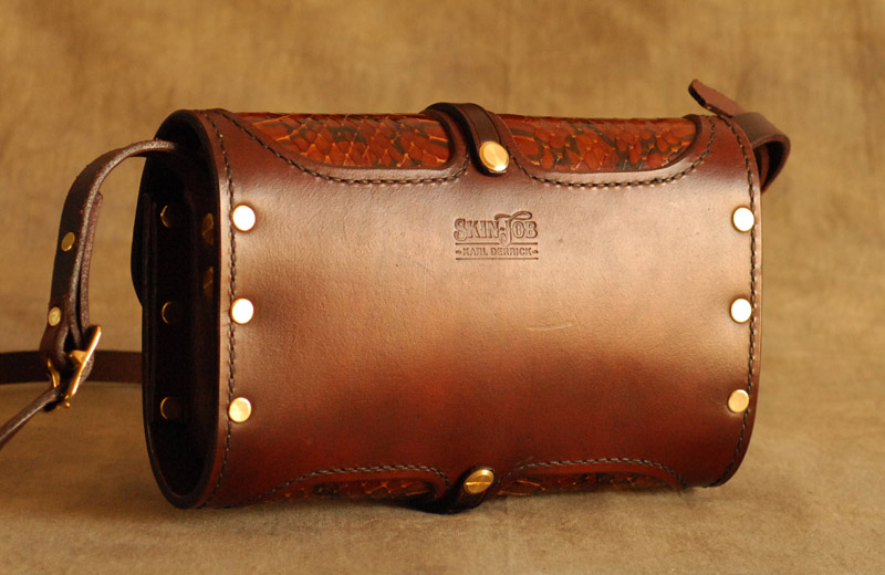

Thanks so much for the nice words about the bag, but more importantly, the good wishes to Megan on her recovery. I'll pass them on. Heartfelt thanks everyone. The maker's stamp is indeed a work of art. It was designed for me by my friend Andy Mock, of Arm Leatherworks, a member here. Take a bow Andy The stamp itself was made by Jeff Mosby at Grey Ghost Graphics. Here it is in all it's glory. I bloody love it, I do. Cheers, Karl
Thanks very much you guys. I appreciate the encouragement. I gave it to Megan today, she was delighted. Really happy. The design is original, but please feel free to copy it. I'm not precious about this stuff. I didn't make a pattern, just busked it. The construction method is as follows: Assembled it measures 8 inches by 6 inches by 2 inches thick. She likes her purse slung diagonally across her body, so the shoulder strap is 46 inches long as is, adjustable to a foot shorter. It's a fully lined, one piece tubular bag with a rivetted-in panel at each end. I drew out rectangle 8 inches wide, by 18 inches long on 8-9 ounce vegtan, rounded the lid flap corners by drawing round a large shot glass rim. I cut this shape out of the 8-9 ounce and then cut the same shape from 6-7 ounce for the liner. I got a whipsnake skin Megan liked the colour of, and worked out the maxiumum panel sizes for the size of skin and drew these on and cut them out of the heavier piece. I placed the outer on the liner and traced the window shapes through onto the rough side of the liner. I cut the snakeskin into panels around a half inch bigger all round than the window sizes and glued them down with rubber cement (Thixofix). I edged and burnished the inside edges of the windows and them dyed the outer and liner panels. When dry, I traced the stitch lines on around the panels with wing dividers and did the same with the outer stitch line on the perimeter. I use a half and half method of stitching; I punch the holes with my Pearson and then hand-stitch with waxed linen thread. I chose black linen thread to pick up with the black notes in the snakeskin. Once stitched, I trimmed, sanded, dyed and burnished the entire outer edge. The straps and end panels were cut from a tough, prefinished belting leather, edged and burnished. The straps are a half inch wide, the end panels 2 inches by 5 inches with a half inch wide strip each side for attaching. The panels are cased, the strips grooved at the base, bent at 90 degrees and left to dry. The whole fully-lined bag main panel, now stitched and burnished, is cased evenly and curled into final shape. Once in place, I wrapped kitchen paper towel around it and taped it into position to dry overnight. Cut to next morning; I cut the tape and rivet the side panels in place. The shoulder strap, attachment straps and front buckle straps are attached with Chicago screws so they can be replaced when worn. The whole thing is given a brisk rubdown with a rough towel, rubbed lovingly with Skidmore's and treated to a good coat of carnuba wax. One more good rubdown to get it glowing and we're done. Took me about four and a half hours, total, not including drying time. That's it. Cheers, Karl
This is a bag I just finished for my Wife's Aunt Megan. It's her Birthday, but we're really celebrating the 'all clear'. She may very well have beaten Thyroid cancer. We're delighted she's still here, and I thought I'd make something a little special. The bag is about 8 inches wide and 6 high, chestnut dyed vegtan and some lovely whipsnake I got from our own Patrick Weill (thanks Patrick!). It was a bugger to make, and still looks to me like a handbag made by a holster maker But I'm pretty happy with it, all in all. Cheers, Karl

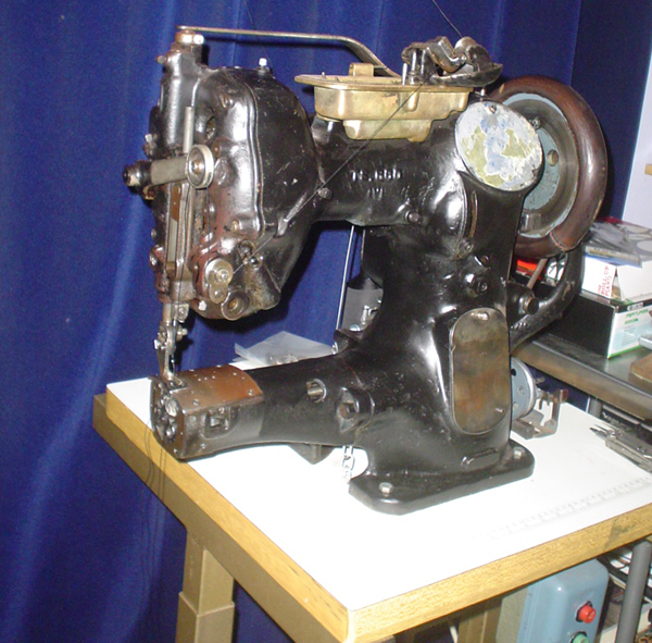

I am being nice Ray, honestly. I spent the day with him making him jump though hoops. I found I can open the bobbin case, swing the bobbin out, remove and replace it and install and thread the new bobbin and the whole machine without any tools at all, just my chubby little sausage fingers. It became a kind of demented challenge..... I also found out I can safely triple back stitch with it at the end of a run. If that isn't strong enough I don't know what is! It's a remarkable machine. I must publicly thank UKRay for letting me adopt his strange cast iron child Cheers, Karl
It would serve me a lot better if I had a bloody manual for it Karl
I have had the great good fortune of acquiring a lovely BUSM 'Pilot' harness stitcher and I need a manual for it. Anybody have one or know where I can get one? Cheers, Karl
