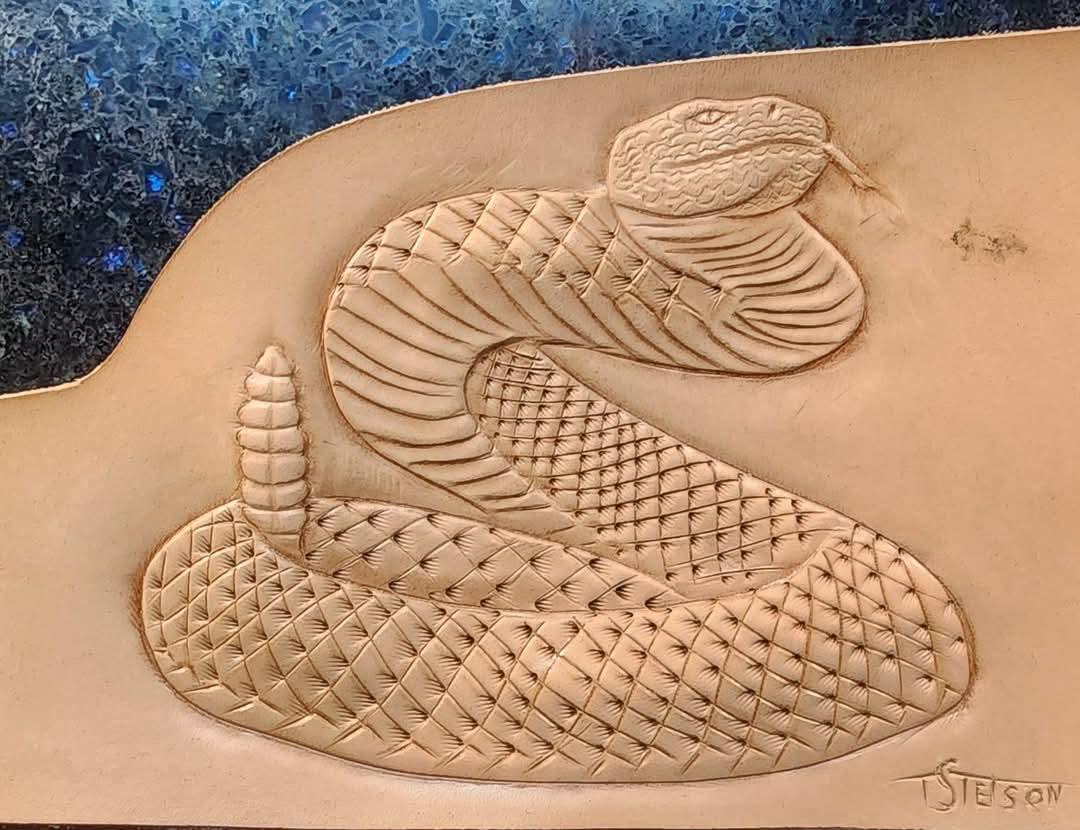

Thanks it was fun and challenging. Its a cool effect too. when I saw jurgens in Florence a few years ago I was dumbfounded and didnt know how it was put together. Then I learned how its done and its simpler than it looks. Its on learn with illume if youre interested.
It took me a week to do but im happy with it, my dad is a nebraska fan so, I figured it would be a good Christmas gift. This challenged me on many levels but I like how it came out, and that rarely happens haha. Hope you like it, cheers!
