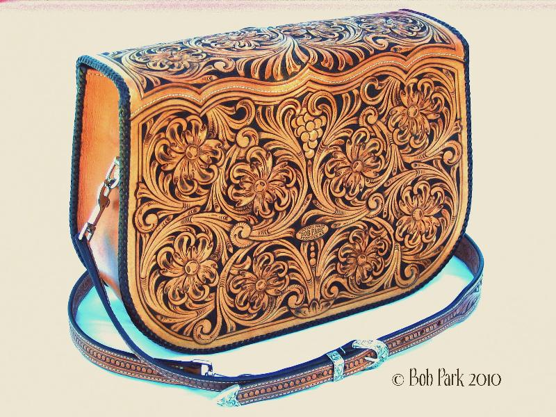

  7. Thanks Troy. The flower center does have a slight dome to it. It's one of my favorites.
  8. Here is a personal organizer which was made for a horse show roping award. All comments and critiques welcomed as always! Happy Holidays! Bobby
  9. Thanks Marlon! The stitch line at the scallop joins the flap to the back but does not show through to the lining. I like to break the work into pieces as it is easier to utilize my leather, it's easier to tool a smaller piece of leather and lastly it creates some visual interest. Thanks for looking and Happy Holidays! Bobby
  10. Thank you so much Tina. I struggle with things like that sometimes, LOL. Do I make the measurement perfect so that I 'm consistent or do I do what is visually correct? In this case I agree with you and if I were to do it over I would center on dots also. Hope you have a great Holiday! Bobby
  11. Thanks for all the wonderful comments, everybody! Your kind words are inspiring! Happy Holidays! Bobby
  12. It's kind of deceiving because the purse doesn't look that complicated....and it's not. However, I install stiffeners in certain sections which you can't see....that adds some time and making lined interior pockets is a very slow process for me because I skive and turn all the edges by hand and apply a fabric lining on them so that no flesh side is exposed. And of course, all those turned edges are then stitched and the interior is finger cut. Then the Mexican round braid takes forever. The lace has to be beveled and the braid itself takes about an hour for every two inches. When I'm finished braiding, I rub it all down with a rub stick which takes some time also, so there are some tedious steps that you might not see in a simple sewn purse without a fancy interior. Bobby

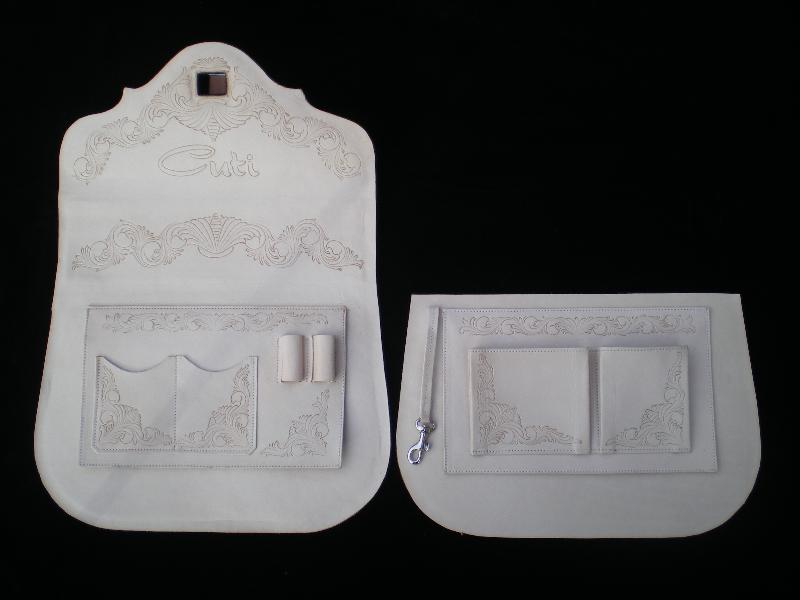

  16. These are photos of a purse I finished recently. It is lined with calf and has interior pockets on both sides (photo shows the interior prior to assembly). The pursed is laced with kangaroo in a Mexican Round Braid. The silver was custom made for this project. As always, your comments and criticisms are welcome! Happy Holidays! Bobby
