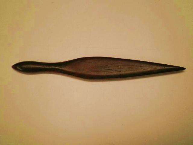

Ben, congratulations on a beautiful maul from Ed! I know how much you appreciate the gesture as I too have been blessed by Ed's kindness. I was going make a separate post but decided it would be appropriate to show another example of Ed's workmanship and generousity here. Mine is #3 and is a beautiful work of art! I'm having a hard time leaving it on the bench. I find myself packing it back in the house where I can keep my eye on it, LOL! Thank you Ed! I would also like to tell everyone about another item which Ed is making. It is a terrific little rubstick and he calls it the "Snake". He tells me it is an old time design and I had never seen one before. It is a very handy shape and size (about 5" long) and I'm really excited about it! (I defintely need to apologize for my lack of photography skills.....it doesn't do justice to either piece)
