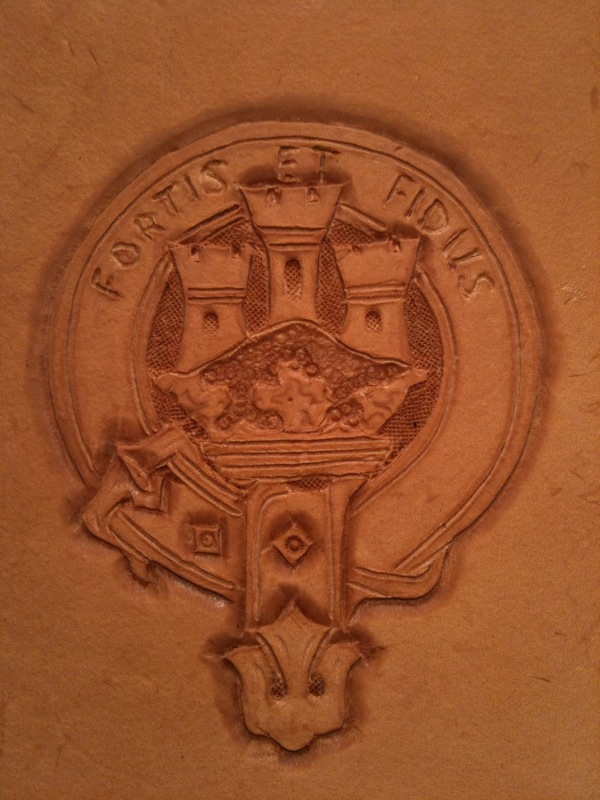

  21. Thanxs Max. Yeah lettirng was only 6mm high, so I just used a craft knife to to cut out.

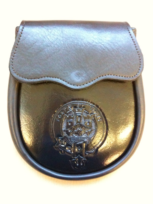

  22. Customer requested his Clan Crest on sporran. It looked good before dying. but once I put a gloss on tooled leather it brought it a bit more. critque away!!
  23. well done and keep up the good work!!!!
