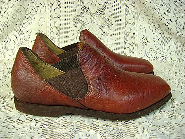

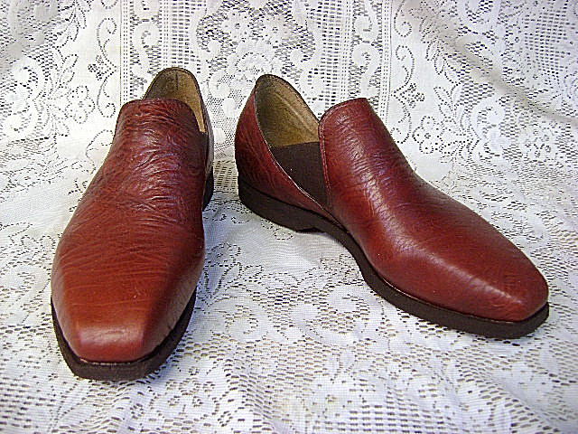

  5. Thank you DS, It's basic shoe repair the way I was taught. Beside the new heels and sole gaurds, which are a thin rubber layer glued on top of the existing soles, these also received new heel liners and sock liners with new padding. Then they were clearned, inside and out, with Aristocrat Leather Cleaner and Conditioner, and allowed to dry with cedar boots trees in place over night. Two light coats of Lexol were then appliled and when dry, finished off with Meltonian Cream Polish.
  6. These were repaired and then became models for a new look at an old style. Comments welcome.
  7. This style of shoe is called a Romeo. I've always thought of it as an 'old mans slipper". Recently I had a request for some for Ropers here in Arizona, who apparently like to wear this style in the truck between events. I'll put the before and afters of the pair that served as my models in the Gallery. Comments welcome.
