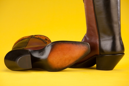

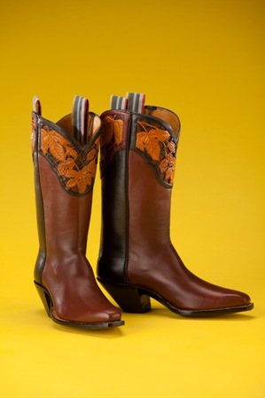

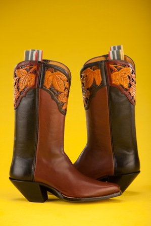

I was asked to show these, which was my entry to the Art of the Cowboy Makers show this past June. Please excuse the repeat if it is.

It's funny to think about it, but my Black and Tan boots have been picked up from the Pro Rodeo Hall of Fame and are on their way back home to me. I've missed them!
