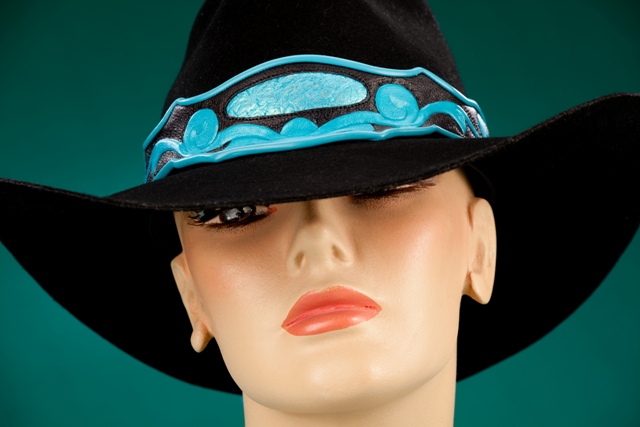

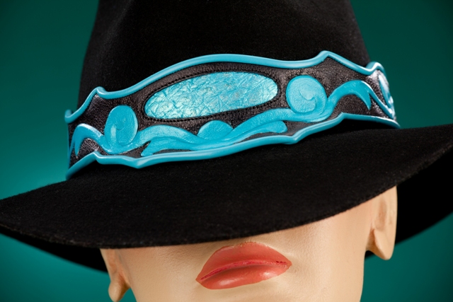

Thank you very much Ladies. It is kinda striking, isn't it? I guess turquoise and black isn't too dated. That was my worry, and that it would get dissed because of it. But it's classic I guess. Your comments are appreciated. And DoubleC, show your work (when you get a hat that is). -
My customer asked me to make a hatband, whatever I wanted. Well that may work for some, but I needed some kind of direction. She said she liked my leather feathers, and scrolls, so I asked for a color, and she said turquoise. This is what she got. She loved it!

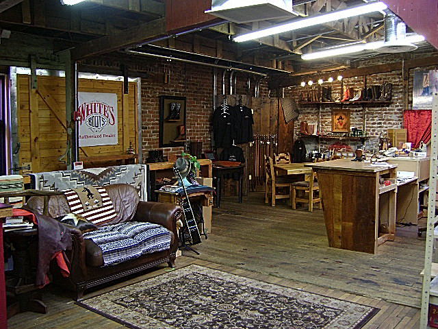

I'm about as busy as I was afraid I would be 6months ago. I moved into my new "cool old space" last June, with a helper/repairer/ pardner. Let's just say things don't always work out, so now I'm on my own. Managing pretty well, covering overhead, buying some groceries, I'm happy with the growth of the business. But now it's that time before fire season starts up in this area. The time when I get lots of 'fire boots' to tune up and resole, as well as assist with placeing orders with White's Boots, in Spokane, as an Authorized Dealer. So it's seasonal, and it's physical work, requiring good hand strength, and a dig in attitude. I'm willing to teach someone with some knowledge of shoe/boot repair. The suitable candidate will have a good hold on his "baggage", and a fundamentally sincere, cheerful, sence of humor. I'm located in Prescott, just an hour and a half up the hill from Wickenberg, AZ. If you're going to be in the area this coming week before the SW Leather Workers Trade Show, give a call and come up for a visit to discuss this opportunity for the right person. Paul 928 442-1213
