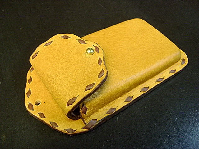

  6. Thank you. The mold itself was two layers of butt leather from bends. They're about 12-13 ounce, and I glued them together and rounded the edges as I wished. You could use skirting too, of course. The leather for the case was molded from a 2 oz. split off of a side that I ordered from W&C, using the technique in the Stohlman cases books. If you don't have these in your library you're cheating yourself, and doing it the hard way.

  8. Thanks. I use the split most of the time to lay down a base layer on new lasts before I build them up. It ocurred to me I could use it for a soft molded form. It was easy to lay over the leather mold. BTW, Wickett and Craig will send it along at no extra charge when I ask them to split a piece to my selected weight. At 2 ounces or more, it's a real handy thing to have around the shop.
  9. I was asked to make this cell phone case and I just finished it in between boots. Deer tanned cowhide applied over a split leather molded form. Lined with Kangaroo and buck stitched with roo as well.
