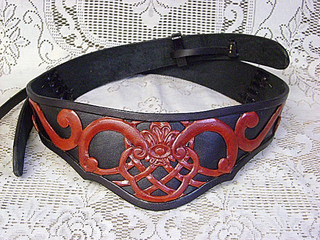

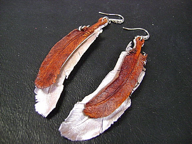

  4. My wife was involved with the production of the Cristmas party this year, where she works in HR/Training and Developement. (I don't know why you need to know all that, except for the quiz at the end.) But here is a belt I made for her. It is 5-7 ounce milled tooling leather (my favorite). The front and side panels are joined with a butt seamed & appliqued lace technique. Dyed Black and British Tan the filligree edges were especialy nice this time, thanks to leather friend Spinner, who made a special little filigree burnishing tip for my dremmell. Thank you Spinner. The earrings are my first using feather leather. They're really light weight. Please don't tug. The smaller one is British Tan, with the other a Pearlized Metalic.
