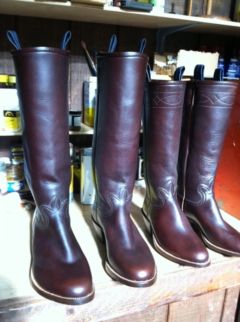

  4. Sorry, don't have any pictures of that, well that's not true. I do have a recent order of two pair of veg/chrome retan work boots I used it on, attached. Have not used it on new tooled leather, but I have used it on tooled belts that come in for shortening and such. It may darken it a little, but it's really more like it refreshes rather than "darkens", like you'd get from neatsfoot oil. For new tooled veg I usually use the Bee Natural Saddle oil, but I wouldn't hesitate to use the Obenauf's oil any time. I usually dye after tooling, let it dry and then oil. The Leather Preservative (LP) has 4 times the beeswax and propilis as the Oil. I'd use the LP for water resistance and Oil for softening and conditioning.
  5. Furthermore, it leaves no oily residue, softens dry hard leather and water proofs. I've been using it for several tears now, and even like it for furniture. And it's formulate to melt at 98.6. Rub the LP in by hand. Good Stuff!
