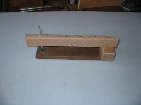

I like it! You could slide flexible tubing over the ends of the handles when in use to prevent the thread from getting caught up. That clamp has potential. I used the hardware of that clamp to make my stitching horse. A lot of stitching ponies are quite flimsy. That clamp is anything but flimsy. You could also put a hinge across the bottom and remove the top screw which would give you a deeper throat. Jim

Sometimes there is just too much leather to fit in the stitching horse. Or maybe you need to work on a completed piece. i don't know what others do but this was my solution. I added an upright, bolted (used wingnuts for easy removal) to the side of the workbench/seat. I can tie off an item or use spring clips to hold a large piece of leather out of my way. I built the stitching horse and bench a few years ago this was just an add on. Oh yeah the Luxo lamp is a big help. Jim
