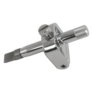

Contributing Member fredk Posted October 16, 2023 Contributing Member Report Posted October 16, 2023 (edited) Tandy sells, or sold, a wee handy device to help hold the blade whilst sharpening https://tandyleather.com/products/craftool-keen-edge-sharpener Edited October 16, 2023 by fredk Quote
