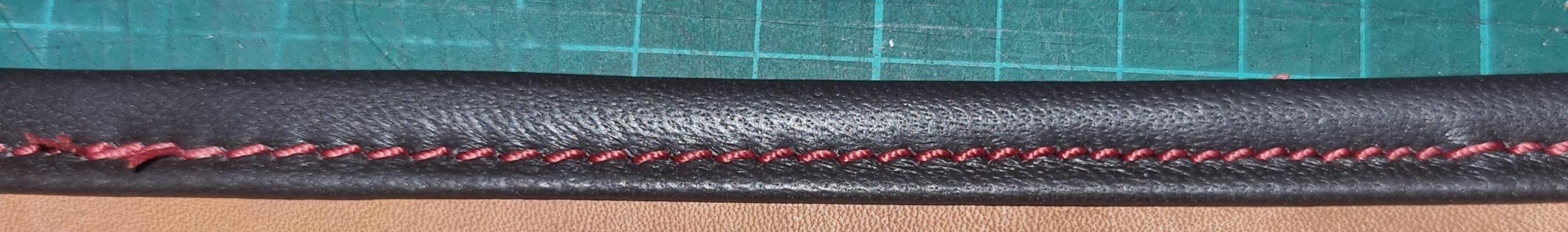

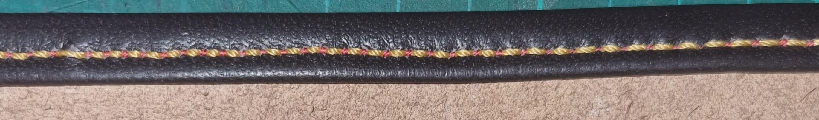

toxo Posted November 26, 2025 Report Posted November 26, 2025 Still trying to get the binding sorted out on my 341 clone. Got the swing away binder holder and the alternate front plate and feed dog but still can't get it to work. First let me explain what I'm trying to do; Want to use thin leather rather than tape. Have lots of upholstery leather in lots of colours for contrast. Want a double fold to leave a nice turned edge. First problem was couldn't get the swing away attachment to get into position without removing the bobbin slide cover. Then, after a lot of fettling o get the binder in line, I thought I'd cracked it. Then I turned it over and found this. Two things here, Firstly note my secret decorative stitching and secondly, the holes in the black stuff are from a previous attempt. The problem now is what to do with the holder to get a balance on both sides. I'll keep trying but wondering if the holder needs modifying or do I look for another? I have to say there's precious little help online. Not even a cut size for a given thickness of material for singl or double folds. As usual all the Youtube videos use the basic easy stuff. Any advice would be extremely welcome. Thanks. Quote

kgg Posted November 26, 2025 Report Posted November 26, 2025 3 hours ago, toxo said: Take a look at these pics. What I'm seeing: First photo: i) Stitch length seems different The stitch length seems to be smaller on the right then on the left. ii) Loose stitch on the left. iii) skipped stitch on the right side. iv) Distance to the edge of the binding fold over varies slightly. This probably is being cause by the leather piece either not having a straight edge, not being feed into the binding folder just right, a slight downward pull being applied as the item goes over the backside of the cylinder arm causing a slight shift or a pressure foot slightly off. Are you holding both threads when starting the seam??? Are you using a table top attachment while binding?? It would help in feeding the leather into the binder. As a note I set my binder so it is just leaves a very small space, a couple of mm, between the forward position of the pressure foot and the binding attachment. Any photo's of your binding setup may help. kgg Quote Juki DNU - 1541S, Juki DU - 1181N, Singer 29K - 71(1949), Chinese Patcher (Tinkers Delight), Warlock TSC-441, Techsew 2750 Pro, Consew DCS-S4 Skiver
