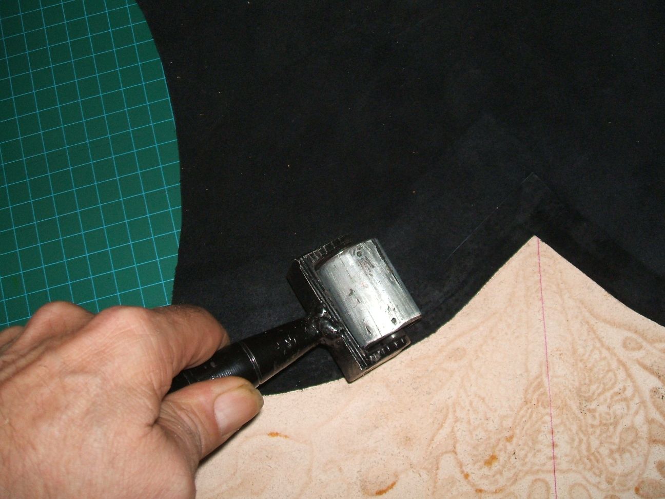

Now we need to glue those strips of pigskin on to add strength to the seam.

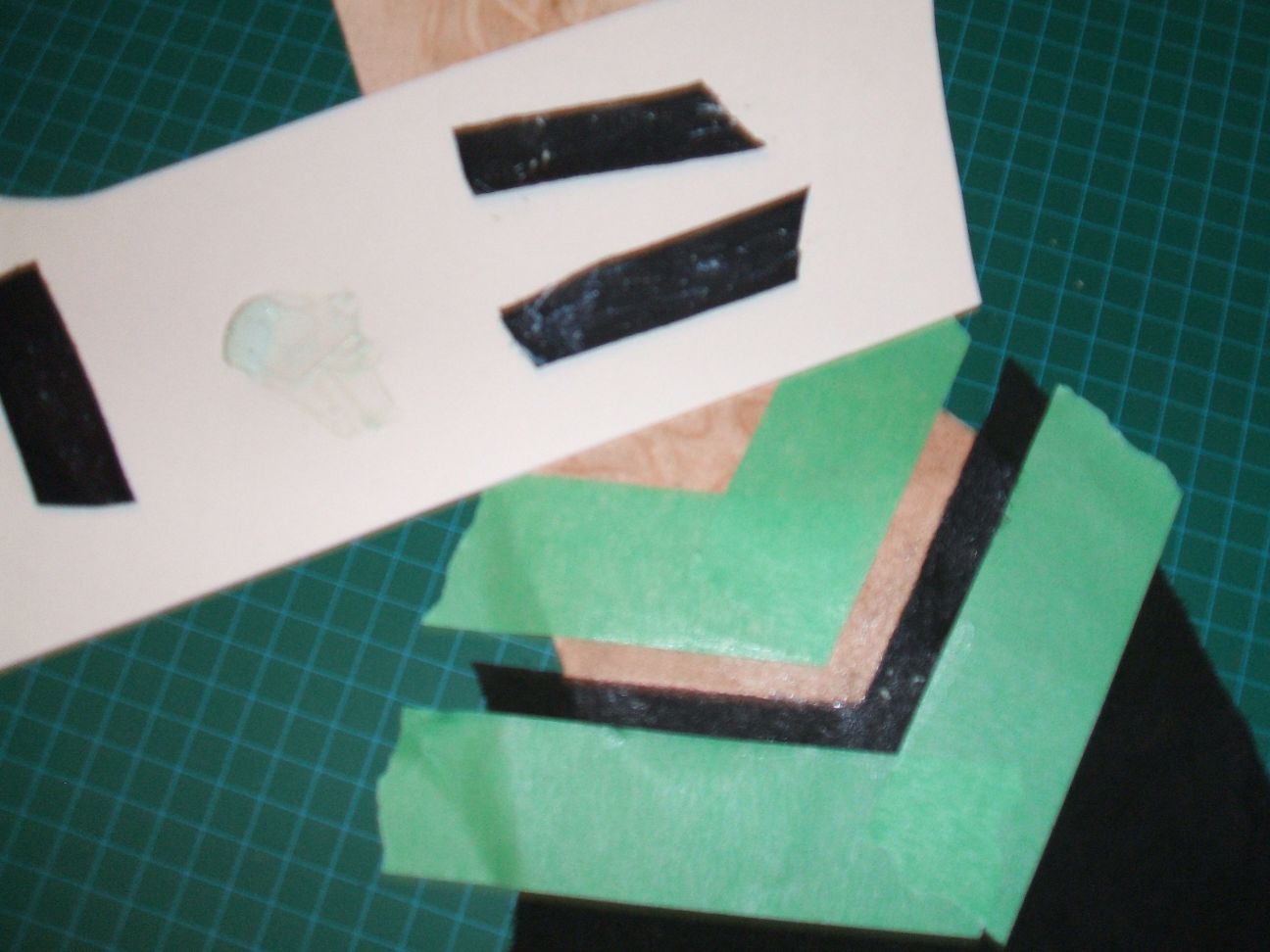

I stick painters tape to the leather to make it easier to only apply the glue where I want it to be.
Once you've layed out the tape, use a wider paint brush and apply the glue, again don't go overboard with the glue, as you really don't ned that much, just enough to leave a thin filem
Then apply some glue to the strips of pigskin, cut them to length first.
Pull the tape off of the leather, then starting in the middle of the back, press the strip down following the curve of the seam. Once you've got both pieces pressed onto the seam, use your roller to bond the pieces together.

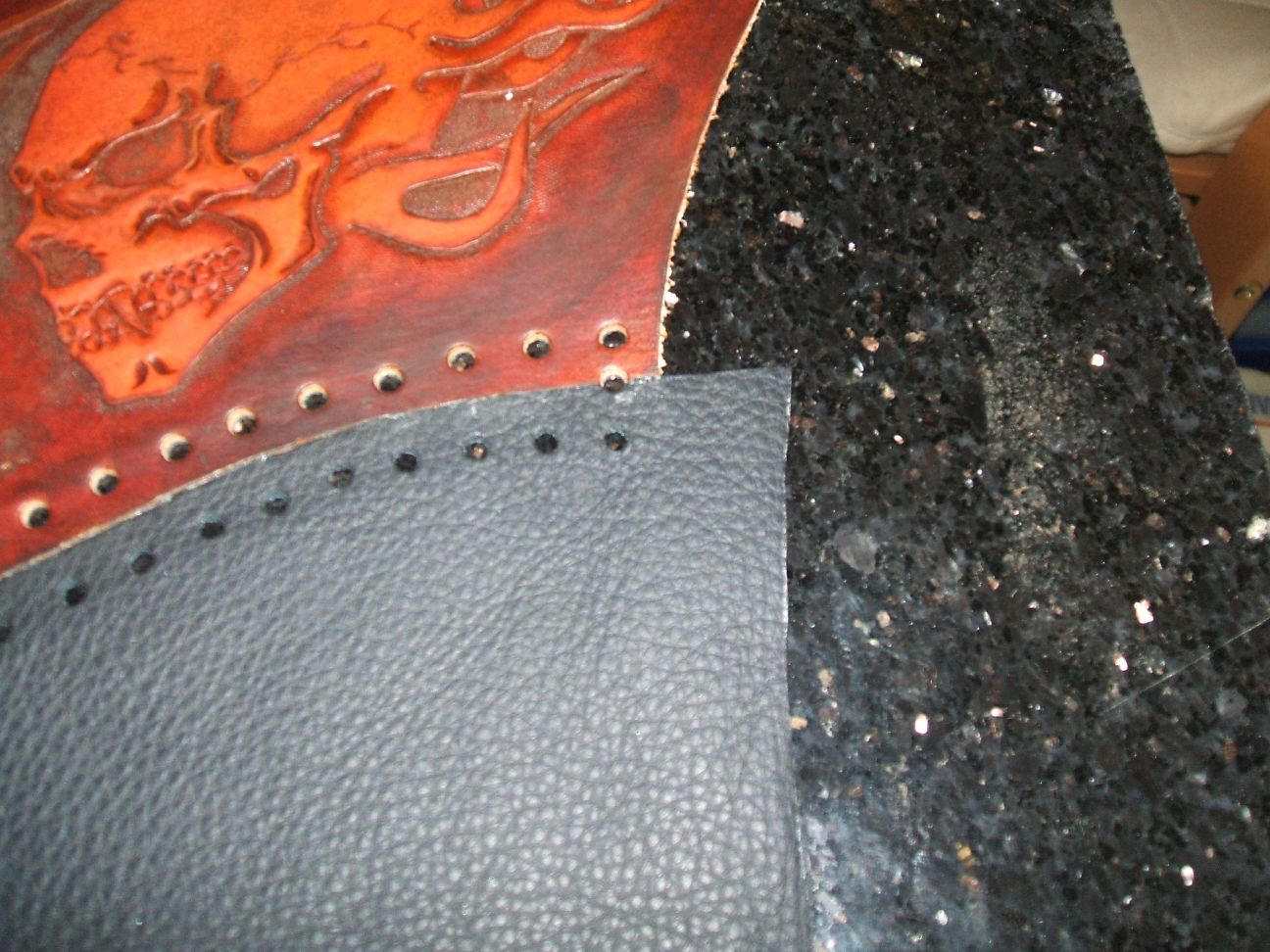

The last step for now is to mark where you will punch the holes for lacing.
Start from the outer edge of the shoulder piece and make a mark 3/16" in from the edge. From there place a mark every 3/8" apart until you get to the centre of the vest. Do the same thing on the opposite side. If you notice that one side is a bit different, this again is not a big problem, as you can adjust the spacing a bit as you punch the holes. I wish it was an exact science, but as yet it is not, very close though.
Now you are ready to punch your holes and do some lacing. Bear with me, and I will have the steps for doing this later tomorrow.
  • Ambassador

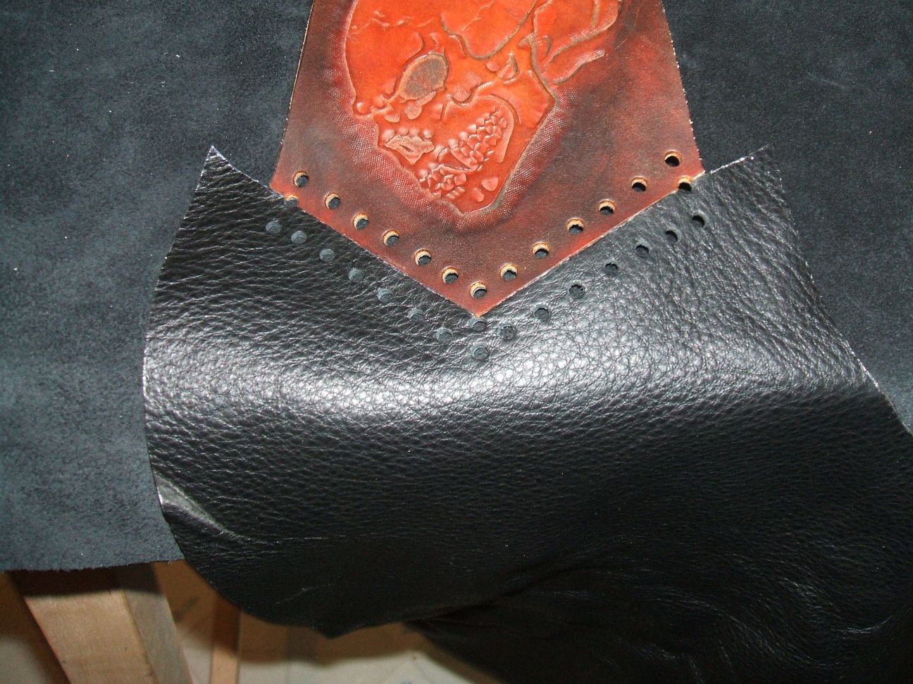

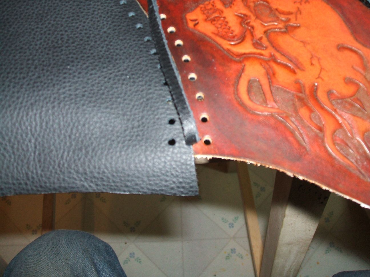

Okay, here we go with punching the holes. Use a punch that is 1 size smaller than the lace you will be using.
Start by placing punching a hole in the middle of the seam, this will be your starting point. Then following your marks, punch all the rest of the holes. You want them to be 1/4" on either side of the seam, this will give you a laced seam that is 1/2" wide.
Then when you get to the middle of the back, you will have to be a bit careful as to your hole punching, you do not want them to be too close, but then you do want them to be about the same distance apart. You will also have to punch a few holes that are not marked, like the one at the very bottom of the "V".

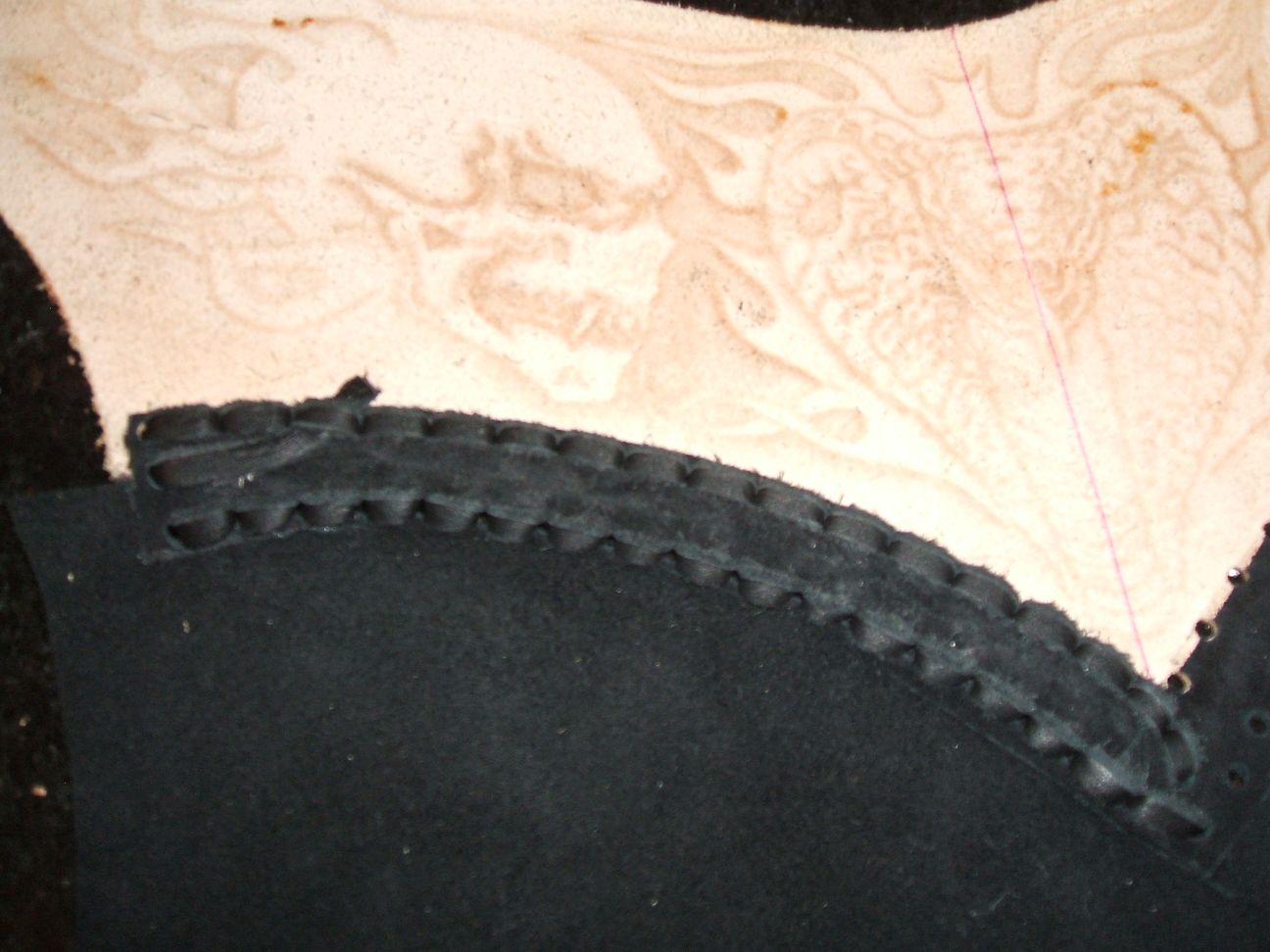

Now we can start to lace. I'm going to use 1/4" lace that I have cut from the same garment hide. You do not really want to use a diferent lace as this tends to look a bit funny. If you need help to make your own lace, I have done a lace making tutorial that can be found on the Main Front page of the Leatherworker.net website.
You will have to cut a piece of your lace 7 times the length of the seam, on this seam you don't want any splicing as it is a structural seam.

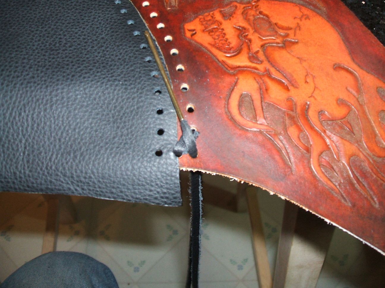

To begin with, you run your lace through the middle hole at the outer edge of the vest. Leave about a 1" tail on the backside, this is to be glued down in such a way that it will be held in place by one of the following laces.
Then, using a lace roller, roll the tail to make a good bond.
Now, run your lace through the second hole on either the top or bottom of the seam. Whichever you decide is okay there is no reason to use one over the other, just be sure when you start the other side you do the same as this side to keep evrything the same.
Pull the lace all the way through and snug, not real tight, just snug.
Then on the backside, run your lace throught the first hole and pull it snug again. This will not cross over but be in a straight line. Then on the front, cross over to the second hole on the front, and run your lace through again. Again just make it snug, not real tight, as you don't want it to pull the leather and make it wrinkle.
Then again from the backside, run your lace through the first hole like you just did previously, pulling it snug. Also you want to be sure that the lace is not twisted in any way, if it is, just give it a little tweek with your finger to straighten it out.
Now, cross over the seam again and run the lace through the third hole, then on the backside, back up through the second hole, on the front across the seam into the third hole, and so on untill you've reach the middle of the vest.
This is what the backside should look like, and also this is how your tail should be secured when you reach it.

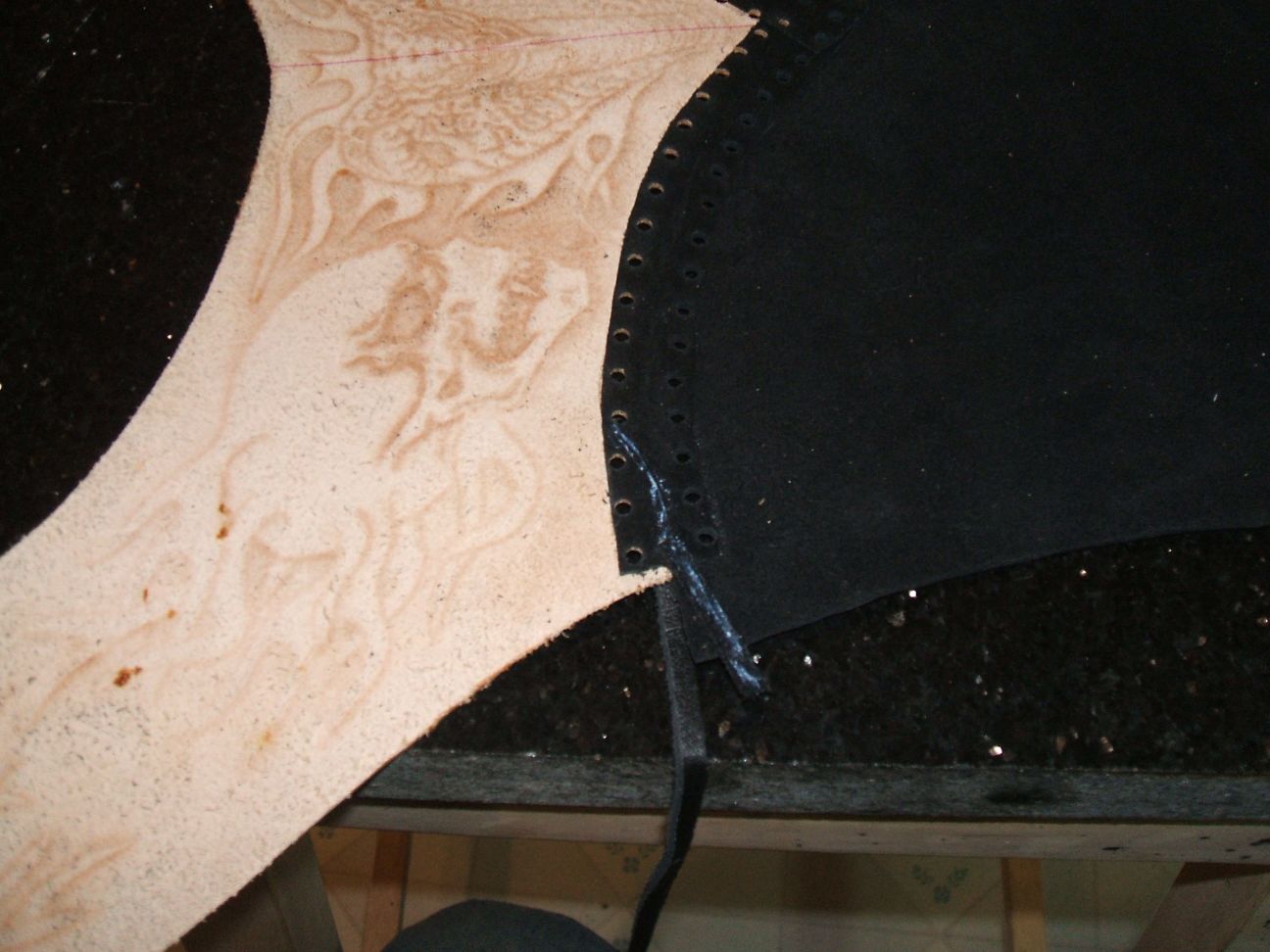

To attach the yolk of the shoulder piece to the front panel of the vest, is basically the same as what you've just done on the back panel.
Like the back, apply glue to the edges and fit together. Then mask off the area that is to have the strips glued down to and apply the glue. Also apply glue to the strips.

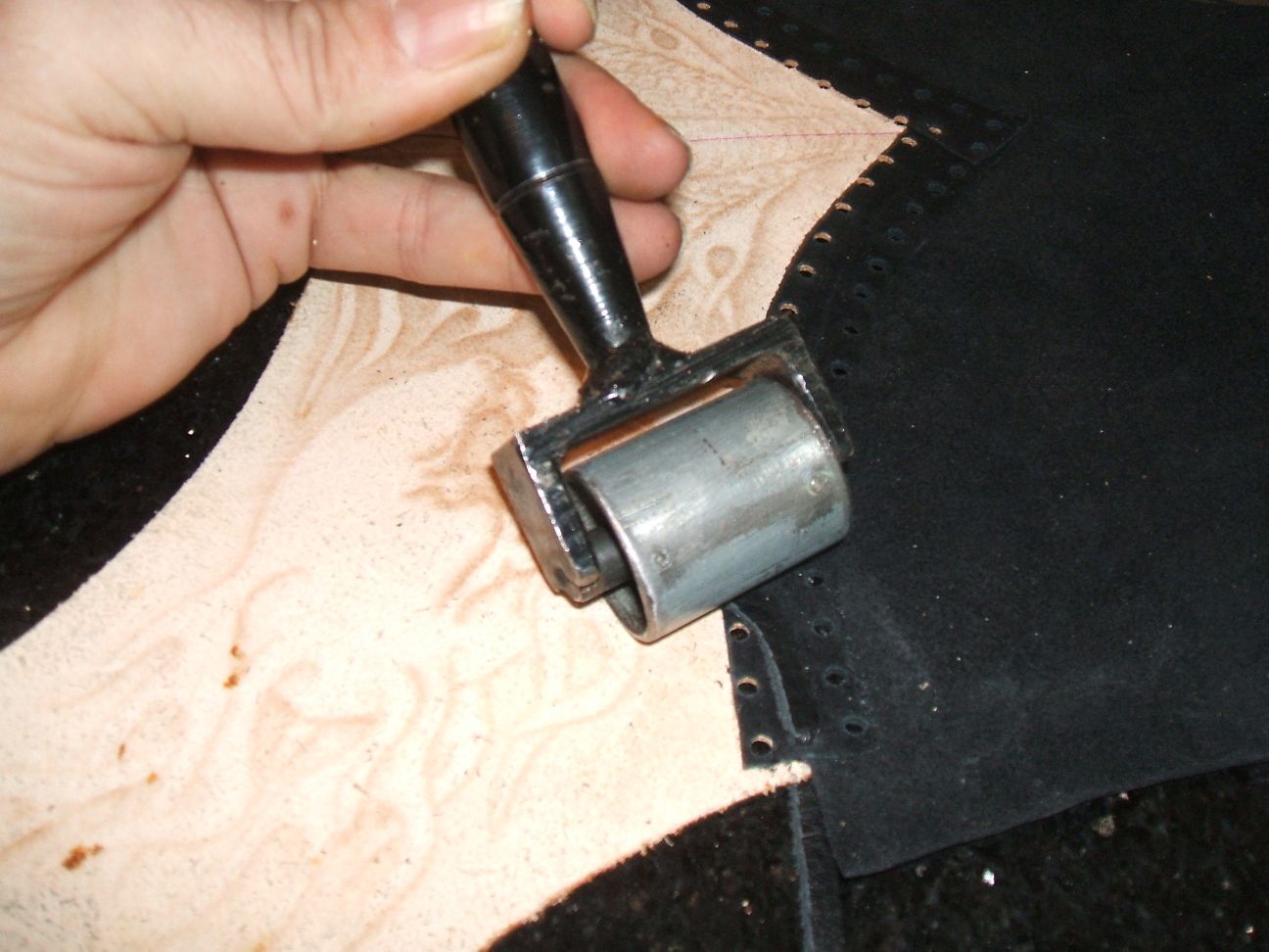

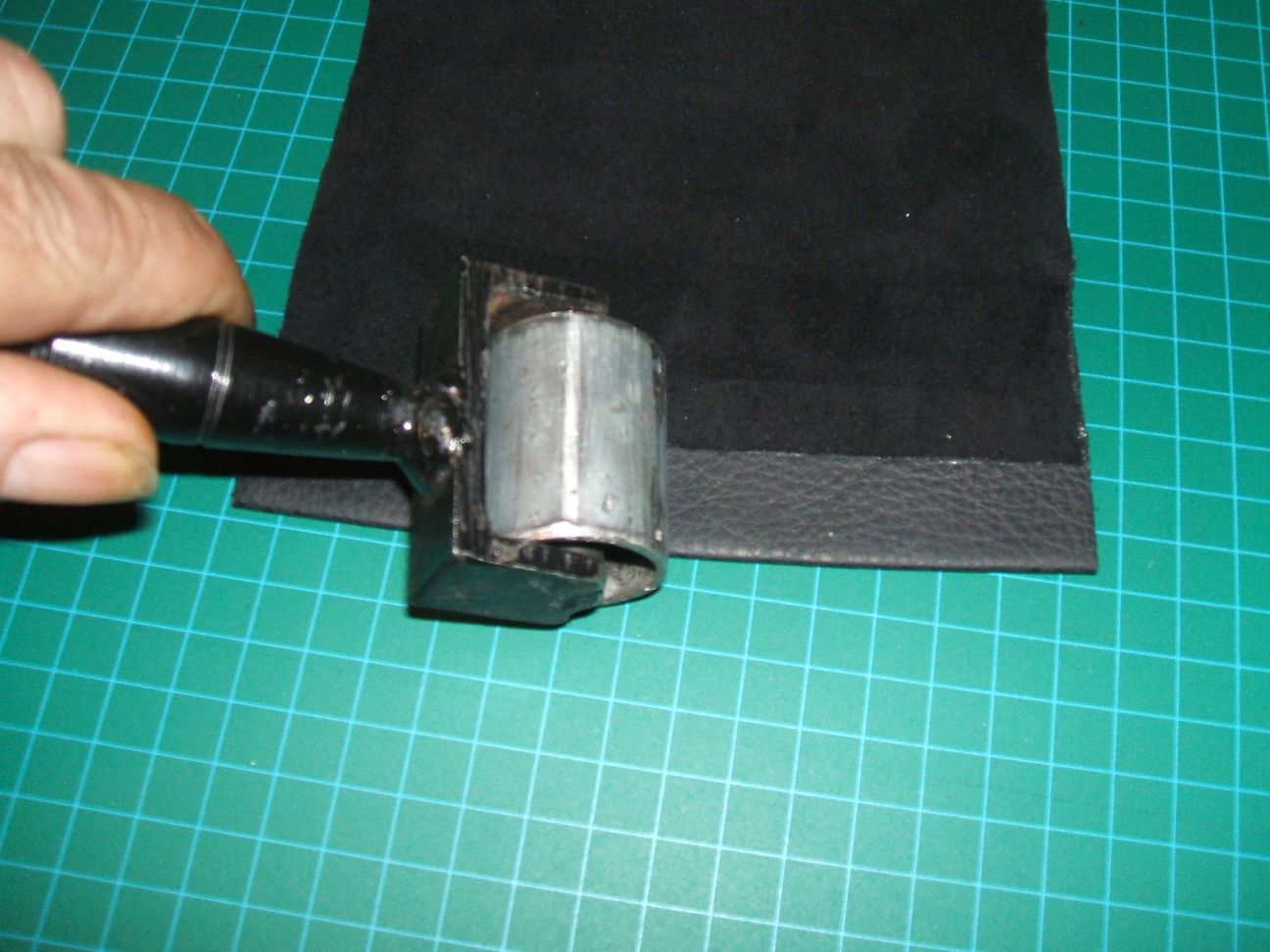

Be sure to roll the strips with your roller to be sure the bond is good.
Now you can mark and punch your holes. This is again the same as the back, 3/16" in from the edge, then 3/8" apart. Punch a hole in the middle of the seam bot h at the beginning. The hole in the middle by the "Point" is not needed on the yolk.
Now lace the seams one at a time from the outer edge in. When you reach the middle and the end of the lace, sand and glue the tail down just like you did on the back panel. Roll the lace from the back, and your ready to do the other side.

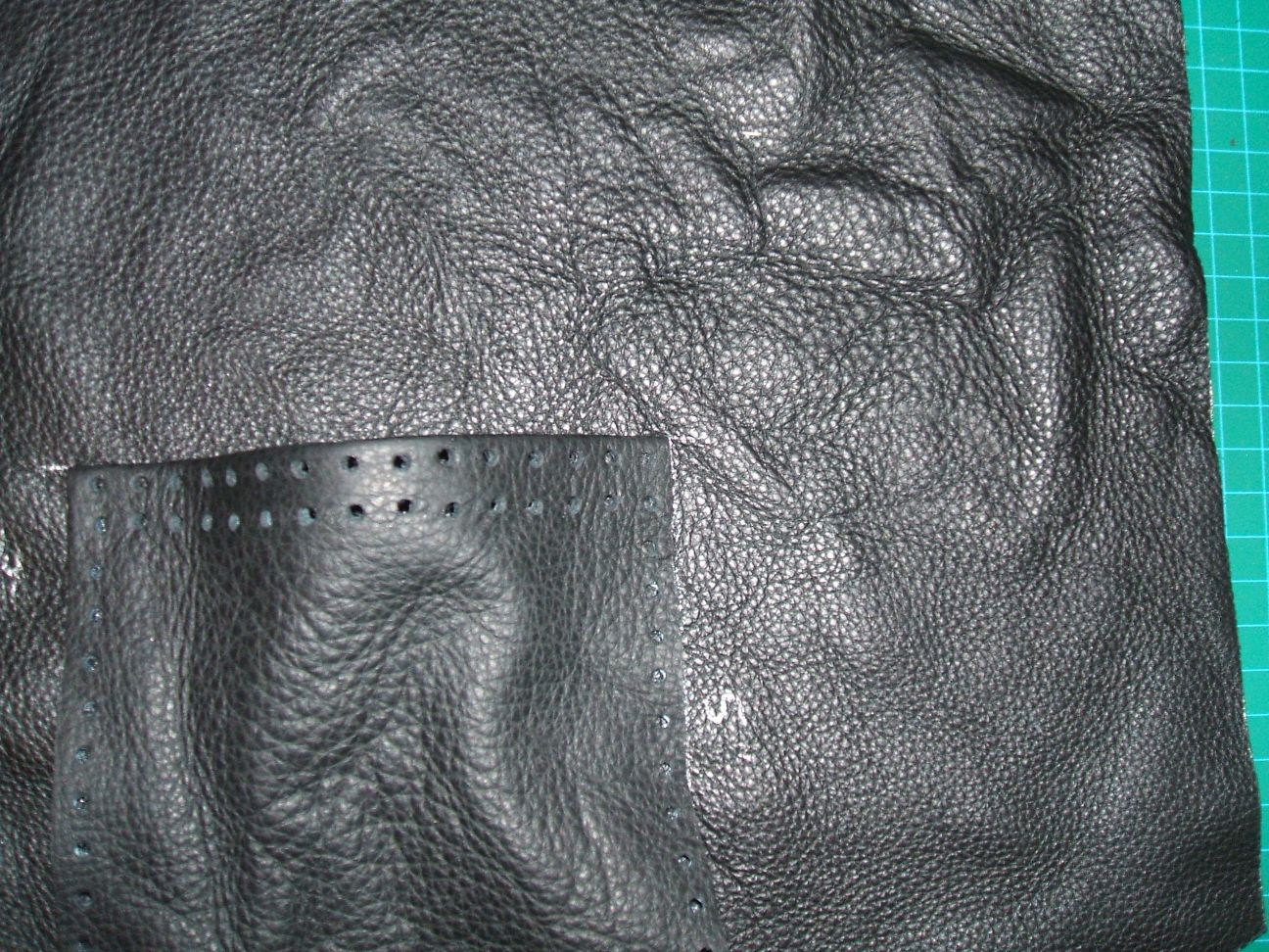

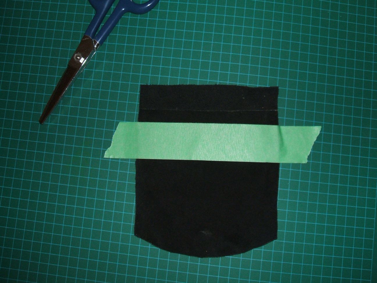

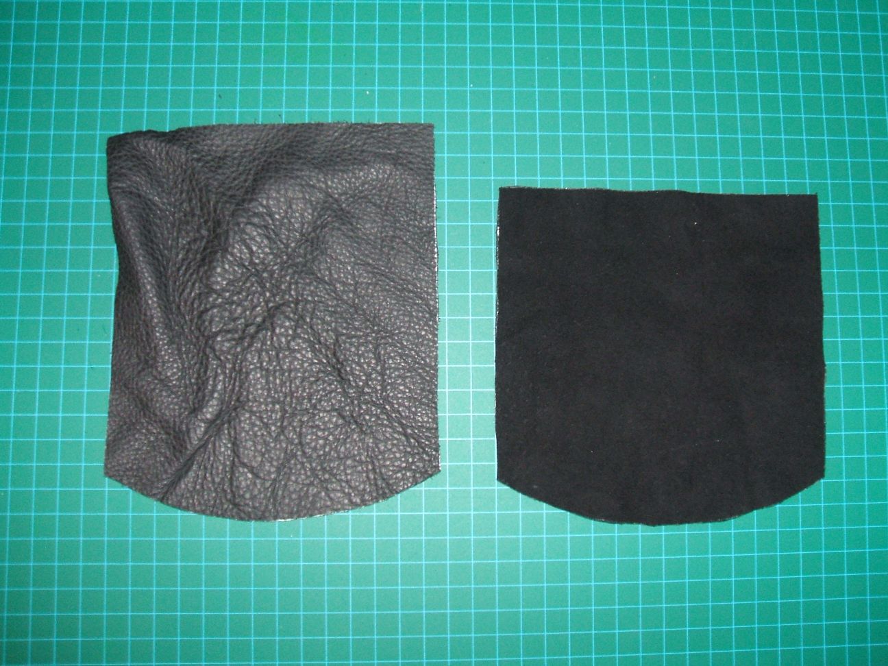

Let's make a pocket now. This is fairly simply to make, yuou'll need some "Pigskin Suede" to line the pocket with.
Using the pocket template, cut out a piece of your garment hide, then cut a similar piece of suede except this is 1" shorter as seen in the picture. You can cut 2 of each as there is 2 pockets.

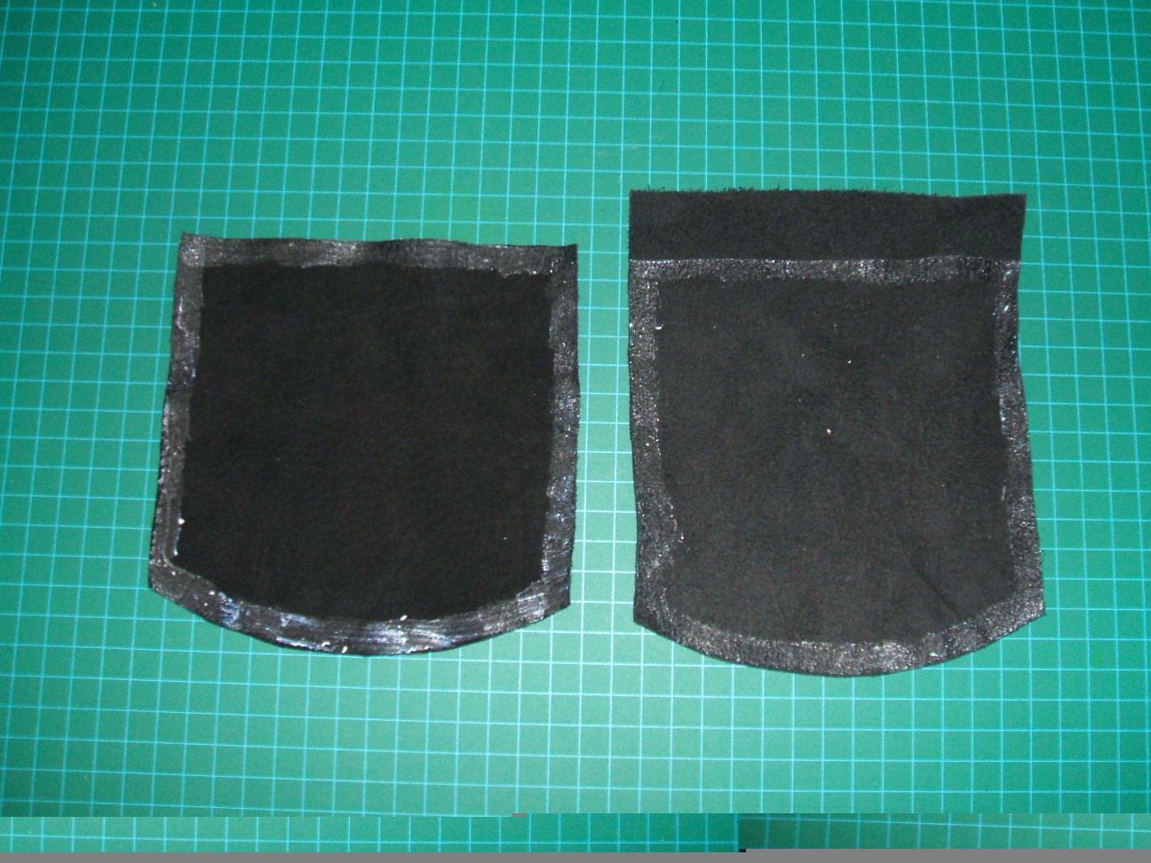

Then place a bead og glue all around the edge of the suede liner, and also the edge of the pocket front. On the front the glue bead only goes across the top of the pocket 1" down from the top. Once you have placed the liner onto the front, press them together untill they align up and roll with your roller. If there is any overhang of liner, just trim it off with your scissors.
Now place a strip of painters tape 1 1/2" down from the top of the pocket. Apply glue to this whole top area, once tacky, fold the top over the edge of the liner and press them together. This is to keep the top of the liner from beeing exposed.
Now with your roller, roll the seam good to seal the bond.
I've made a template that I use to mark the hole for pockets, but all is the same as the rest. Across the top you want the holes spaced 3/8" apart but only 3/8" above each other, not the 1/2" we did on the other seams. This is because the lace running down the side is also 3/8" apart so the first laces will match the top laces. Only punch one row of holes down the side and across the bottom of the pocket.

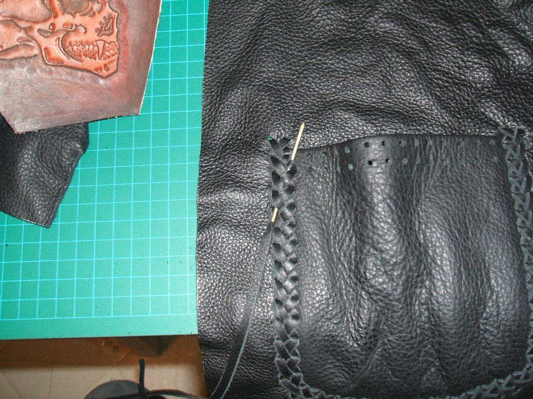

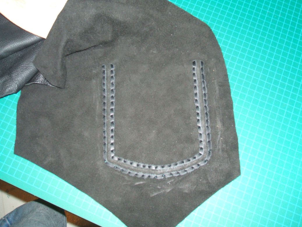

Now we can lace this pocket to the vest.

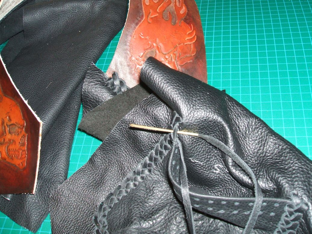

Start your lace into the hole shown in the picture, then in the top of the corner, sand a small area towards the opposing corner and apply a bit of glue to the lace and the sanded area. Press this down and roll.
Run your lace up through to the front through the hole shown, and just before you pull it snug, place a bit of glue on the vest and also the lace. This will help the lace from being pulled out at any time. Now just continue lacing as before, being carefull not to pull your lace to tight on this as it will tend to pucker the leather.
A little lacing tip here: Use the edge of your thumb when pulling the lace to align it with the hole, This helps prevent the lace from twisting as you pull it through.
Once you reach the corner where the holes have been punched a bit farther apart, make sure that when you push your needle through, it comes out on the proper side of the last lace.
When you reach the centre of the pocket, sand an area that is about 1" long so that you can glue the tail down as before. This will be covered by the next lace we do. Be sure to roll all of these glued spots, it realy does help it to bond.
Now on the other side of the pocket, you want to do the exact same thing you did on the first side. Sand a small area, glue the tail down, roll the glued tail, then glue the loop of the first lace on the backside. Then continue to lace until you've reached the end.
At the end of the run, just push your needle through like shown, you want to run it under about 4 or 5 laces back, then cut the tail and tuck any little nubs back under.
Here's the back of the finished seam.
And here's the front of the finished seam. Remember to roll the lace from the back of the vest to help lay the lace down nicely.

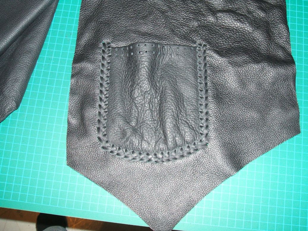

Now to lace the top of the pocket. This is a bit tricky to start, but I think you will get it by the pictures.
Starting on the side closest to the front of the vest, push your needle through about 4 laces back and bring it out just before the top lace. Pull your lace slowly so that the tail is left under as many laces as possible.
Then run your lace through the first open hole on the top of the pocket. On the inside of the pocket, push your needle up through one hole back, this hole already has 2 laces through it from the side lacing. When you've crossed over and back through to the inside again, you will have to go back one hole on the bottom of the top, into the hole that has 2 laces, just like the last stitch that you did. Continue to lace from here as normal. Once you've reached the end, again you will have to run your lace through holes that already have 2 laces in them.
To finish off, run your needle down the side under about 4 or 5 laces, cut the tail and straighten out any nubs left showing.
Here's the completed laced pocket.

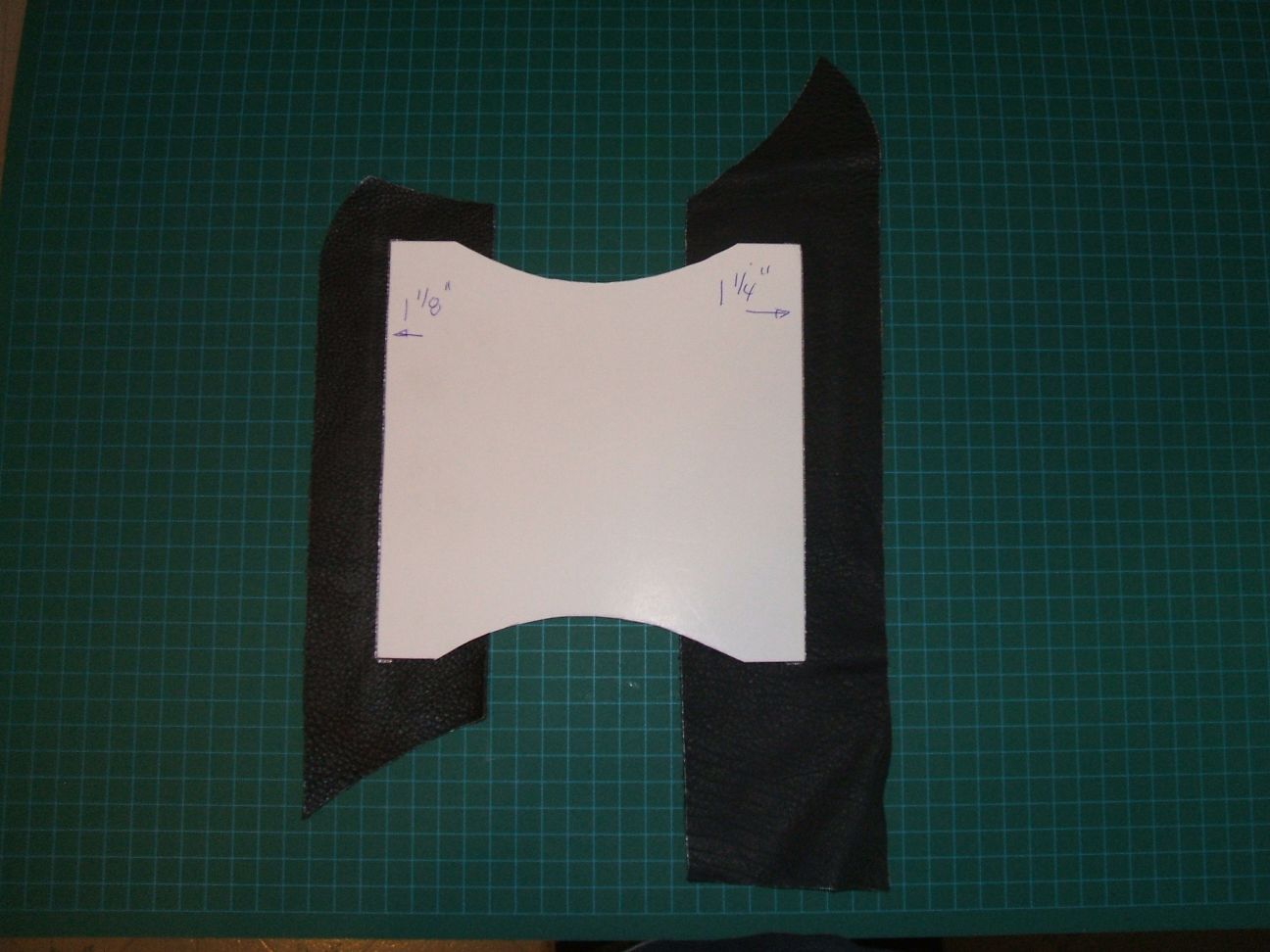

Okay, here we go with the side adjustment parts.
First off cut the pieces required from your garment leather, be sure you make a "Right" & "Left" hand side. You don't want all the pieces the same, once you've marked one, flip your template and mark another.
If possible, you want to lay this out on a gridded cutting board, it just makes it a whole lot easier to line it up. On the left side (shorter side) you want to measure in 1 1/8" and place a mark. On the right side, you want to measure in 1 1/4" and place a mark. Now, laying it out as shown in the picture, line the bottom of the curved part up with one of the lines on your cutting board, do this with both pieces. Then measure down from the highest point of the left side piece 1" and place a mark. Now you have the location for the top left corner of the inbetween piece, as shown with the piece of white paper. Once you have the template in place, mark all along the edge, and a small mark at the tyop and bottom.
This is what they should look liked marked.
