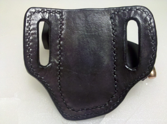

Members RobDude30 Posted December 2, 2010 Members Report Posted December 2, 2010 Here's a mag pouch I just finished. Made of cheapo 7/8 oz Tandy leather, hand stitched, vinegaroon for color, and Resolene for the finish. I feel pretty good about my edges on this one -- used a little wax for the first time during the burnishing process and think it helped get a much nicer finish. Practice, practice, practice! What do y'all think? Quote

Members Dwight Posted April 5, 2013 Members Report Posted April 5, 2013 Rob, . . . I've never used vinegaroon, . . . what is the total process one has to do to get it right? Thanks, May God bless, Dwight Quote If you can breathe, . . . thank God. If you can read, . . . thank a teacher. If you are reading this in English, . . . thank a veteran. www.dwightsgunleather.com

Members camano ridge Posted April 5, 2013 Members Report Posted April 5, 2013 Dwight, go to this site and thread: http://www.cascity.com/forumhall/index.php/topic,11991.0.html it's about a 9 page thread it covers vinegaroon in depth as well as walnut stain and coffee dye. There is a lot of information from Chuck Burrows and Will Ghormley. I don't find vinegaroon all that tedious. Basically just disolve steel wool in vinegar. The big mistake is people don't let it stand long enough before using it. Let the steel wool disolve in the vinegar for about 4 weeks befor using. Some people strain it off befor using, I haven't. Test a strip of leather it should start to turn almost immediately. It may turn a blackish gray at first but once you put oil on it it darkens up nicely. THe big thing is after you have dipped the leather in the vinegaroon give it a few minutes to work then dip quickly in a baking soda bath to neutrilize the acid. Then rinse with water. You will get an even black and it chages the color of the leather through and through not just on the surface. Quote https://www.facebook.com/CamanoRidgeCustomLeather?fref=ts
