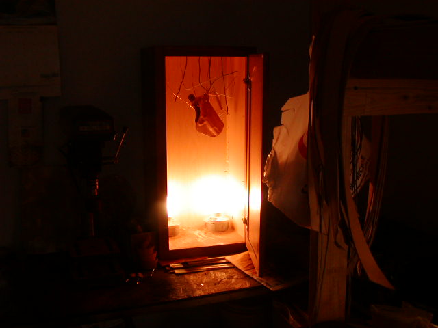

Having a means for speeding up the drying process can save a lot of time, making the production process more efficient. Here is one way to do this.
Kitchen wall cabinet 15"W X 30"H X 12"depth, found in a home supply store as a "demo" model, purchased for $20.00.
2- porcelain lamp fixtures, keyless type.
2- 4X4 electrical boxes.
1- single gang switch box with rheostat (dimmer switch) to control current to lamps
2- 100W incandescent bulbs.
2 feet of Romex wire, #14-2 for connections.
1-pigtail cord to plug into wall outlet (salvaged from old extension cord).
Electrical boxes are mounted to cabinet bottom shelf with wood screws. Switch box mounted to outer side of cabinet. 12 holes of 1/8" diameter drilled in cabinet top with pieces of copper household wire dropping down to interior. Dimmer switch controls current to bulbs, allowing control of heat produced. Gaps all around cabinet door allow air flow to interior, while holes in cabinet top allow heated air to escape, resulting in convection flow.
With rheostat at highest setting this set-up maintains interior temperature between 104 and 109F. Holsters and accessories are affixed to the wires after forming and boning, and will be sufficiently dry to proceed to finishing processes in about 3 to 5 hours, whereas I used to set everything aside for overnight at least.
With a capacity for 12 pieces I can let it run all day in the shop during production cycles, just adding 2 or 3 at a time as they come out of forming & boning, then rotate them out of the cabinet and more can be added.
Total cost as shown was about $40.00 with production time of about 2 hours. Can be used on bench top or mounted to wall, anywhere an electrical outlet is handy.
