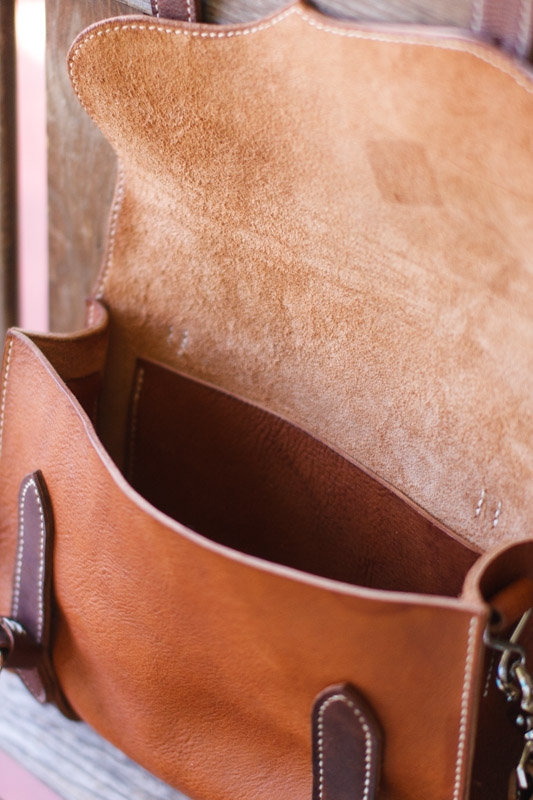

I made a bag for myself a few years back when I first started leatherworking. Ever since, I've gotten a flood of compliments on it. However, once I joined Leatherworker, I got enough better that it has been getting downright embarrassing to get compliments. I always felt the need to say how everything I make now is so much better, really. I decided I was doing a pathetic marketing job, and it was a legitimate business expense to make myself a new bag. Besides, I used scrap pieces left over from other bags, so it's almost free.
All hand sewn, 9 oz. Austin leather and stoned oil tanned leather, doubled, for the straps.
My new bag:

Beautiful bag! Also, I agree that the old one is lovely too. I'd really recommend gifting/selling it to someone rather than modifying it. I know tons of gals that would be thrilled to sport it. Your new work is undoubtedly nicer, but don't discount the character of your old one!
Very nice work Monica! The only small critique I have is the interior pocket stitching showing through to the back of the bag. And that is a very minor critique. It may have looked just a bit cleaner to catch it up in the stitching attaching the gusset to the bag.

@Joe - Yes, I see what you mean. I'll keep that in mind for the next one. In the past, I've been leary of adding it to gussets because I thought it made the seam look messy, but I'm open to being told that it looks better than an extra seam. Especially if I skived down the lower edge so that it melted in a bit. However, you're still left with the seam at the bottom of the pocket. So, I dunno.

I just realized you got "U" shaped gussets on the bag...hmmmm that makes my suggestion not so good. LOL.
You could do a hanging pocket on the inside and line up the vertical stitching rows with straps maybe?

@Joe - No, you're right, with some more thoughtful planning I could have completely hidden the stitches. Thanks for the suggestions! I'm going to move more towards zippers, so I'll keep that in mind as I change my pockets a bit.
