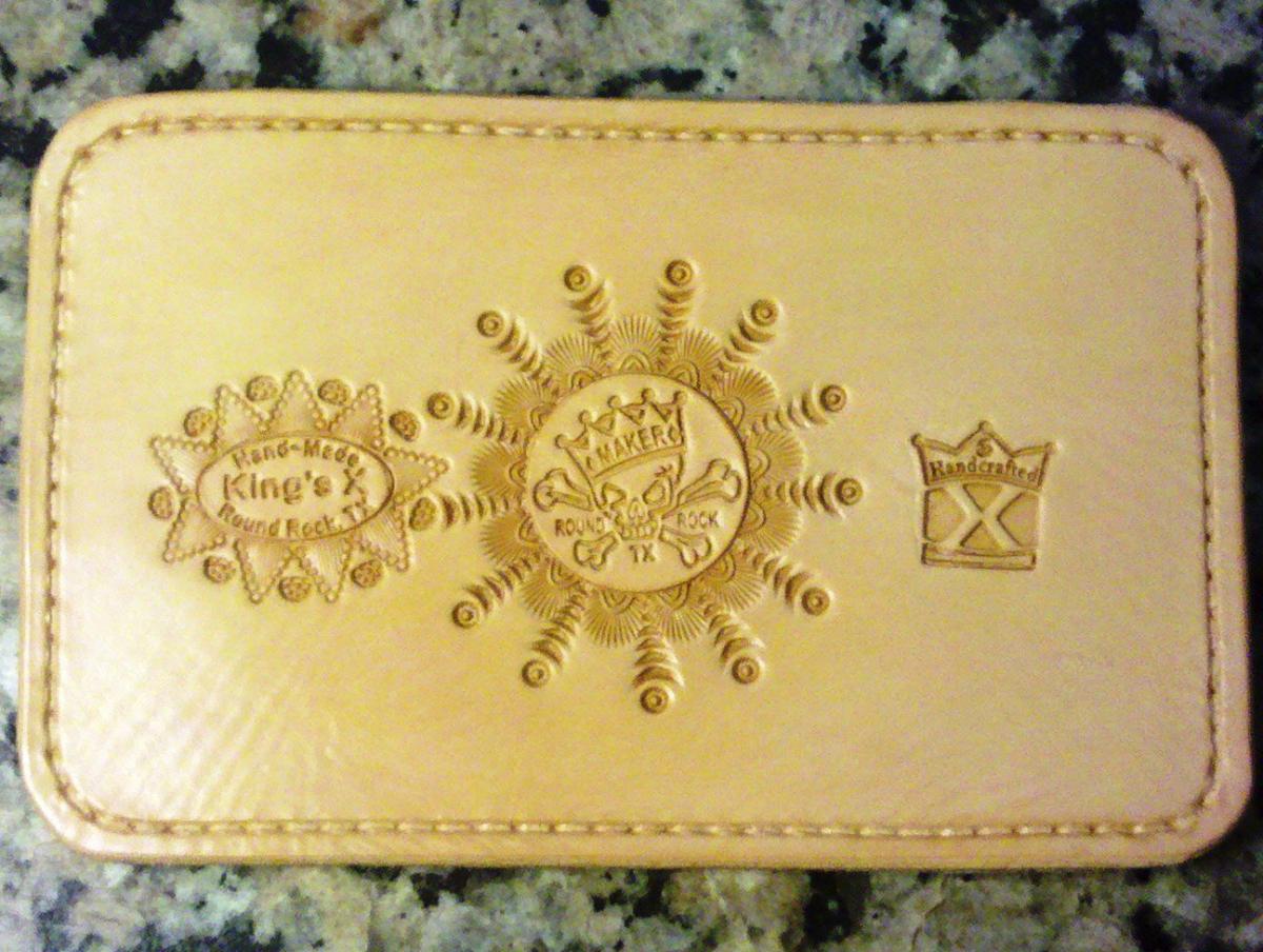

Here are my three older ones that I have been using for many years. I recently made a new one.
post-6330-0-78512700-1412969008_thumb.jp
post-6330-0-09281700-1412969023_thumb.jp
Greetings from Central Texas!
