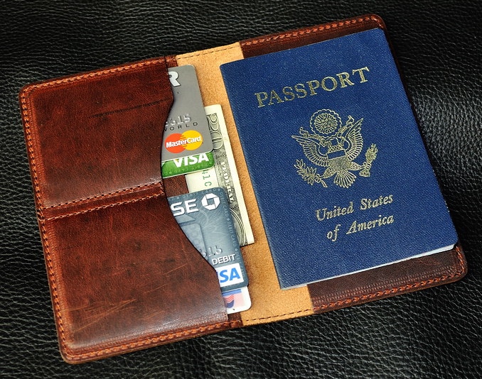

Im looking for a quarter round ( or less) punch set- somewhat like end strap punched or round punches in order to consistant create corners on several items I would like to make. I have attached a picture of what I need the punch to do- make nice corners as in this individuals passport wallet.
Is there a source for these- or do I just need to get round punches and grind off a portion of it to create my own home made quarter round punch set??
