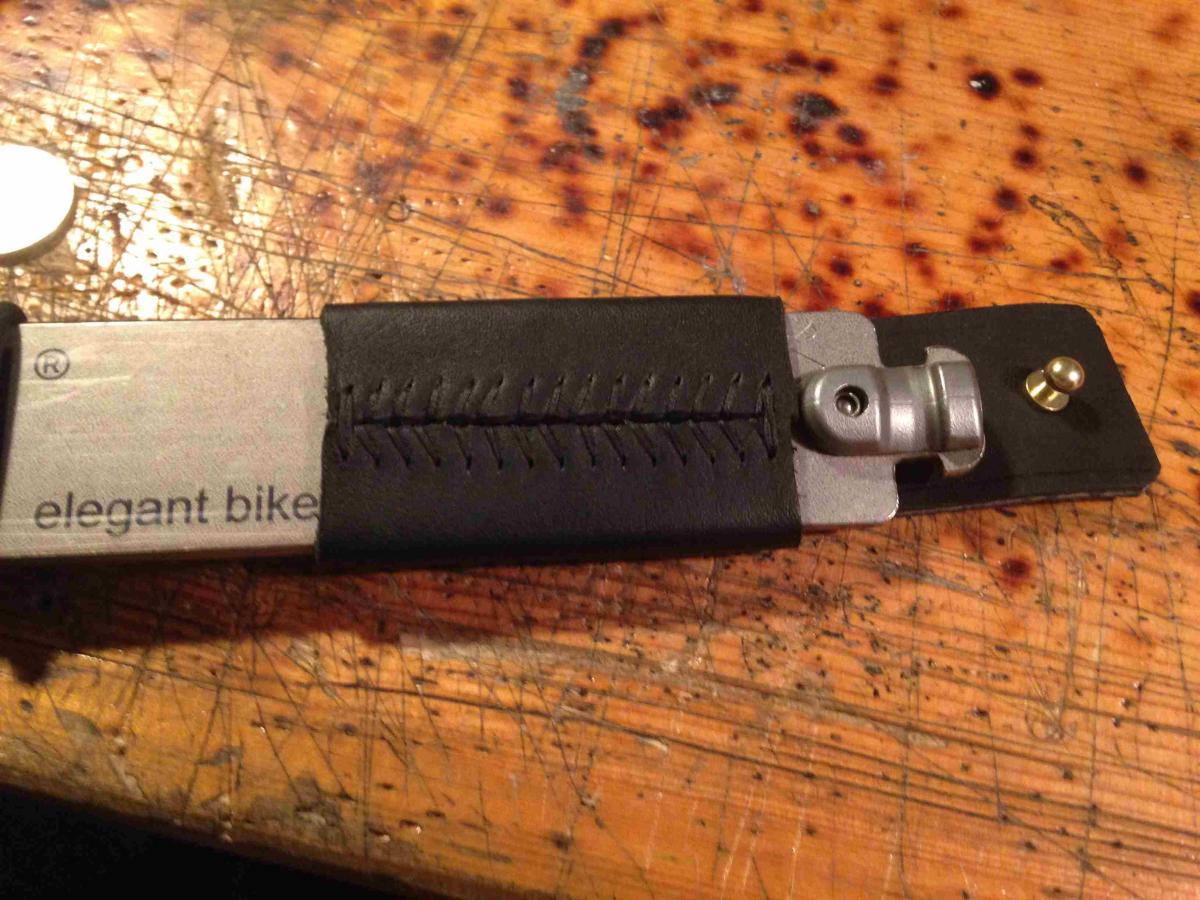

Baseball stitch 7 oz chrome tan stretched around a titanium bike lock. .6mm tiger thread.
post-60185-0-79441300-1432226113_thumb.j
post-60185-0-59163500-1432226110_thumb.j
