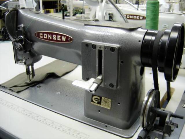

Members MG513 Posted November 13, 2015 Members Report Posted November 13, 2015 Wiz I couldn't add this photo on the last reply, but I think I figured out the lever you were talking about. You said keep it straight but mine is no where near straight, not sure if it's obvious enough from this angle. I don't have anymore rod to try and straighten it out with and I like the position of the pedal... What could I do to make this straight? Or would I have to just move the pedal over to straighten the rod? Thx everyone Quote
Moderator Wizcrafts Posted November 13, 2015 Moderator Report Posted November 13, 2015 That rod is more than straight enough. The problem I had was caused by a huge angle of about 30 degrees off center exerting a side pull at the bottom of the travel. The machine was on a pedestal table that positions the motor rather far away from the speed pedal. I have not experienced the slowdowns on machines mounted on standard industrial sewing machine tables. Quote

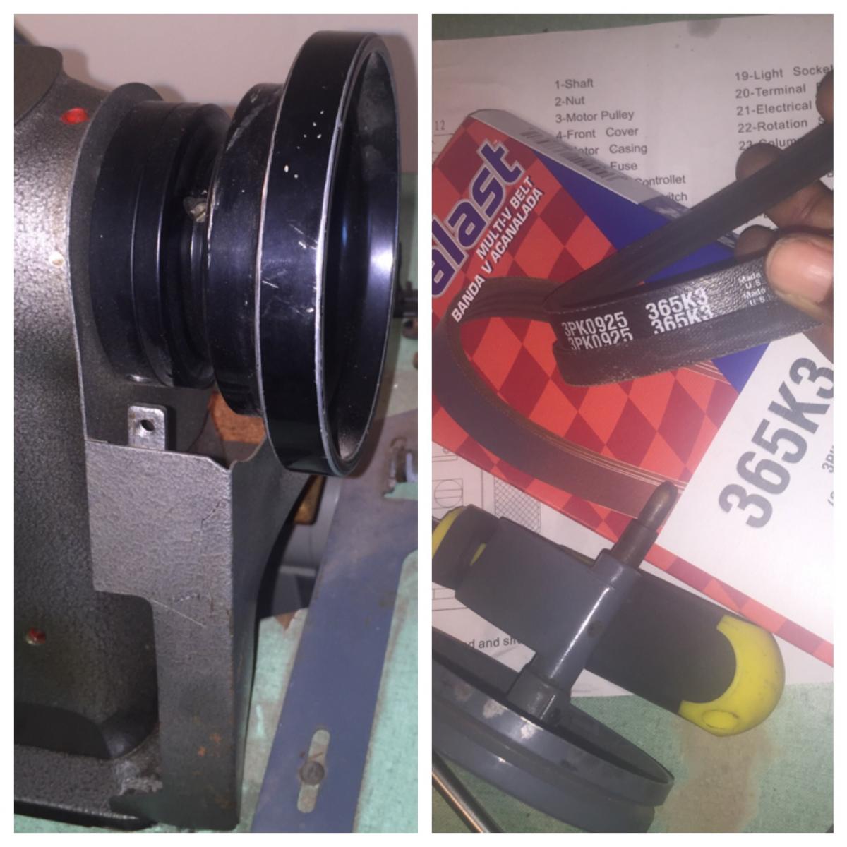

Members MG513 Posted November 14, 2015 Members Report Posted November 14, 2015 Ok. Been 2 auto zone 3 times the last hour and a half trying to get the right belt. I decided to hold off going back only because my bobbin winder is suppose to come in tomoro... And from all the photos on Google of it attached the right way, it looks like the belt is what drives the winder to fill the bobbin. But I have the plate thing (left picture) and I can't figure out how to get that off! I took the screws on the handwheel out and tried pulling but nothing happens. I've seen 206s with that thing not on there, it also make it hard to get all these belts I keep trying on and off... Any help? Please Quote
Members MG513 Posted November 14, 2015 Members Report Posted November 14, 2015 One more angle. What is this called, the belt guard? Annoying little bugger. Quote
Northmount Posted November 14, 2015 Report Posted November 14, 2015 Mounting the bobbin winder is the last thing to do. Ignore the bobbin winder when sizing and installing your drive belt. Your belt length should be 2 x the centre to centre distance of the pulleys, plus 1/2 the circumference of the 2 pulleys. Position your motor about halfway in the adjustment range so you have space to install and adjust. The pulley size is the outside diameter of the pulley. Tom Quote
CowboyBob Posted November 14, 2015 Report Posted November 14, 2015 There's a screw in the center of the wheel(look from the outside) rightside, that is probably holding it on. Quote
Members MG513 Posted November 14, 2015 Members Report Posted November 14, 2015 Mounting the bobbin winder is the last thing to do. Ignore the bobbin winder when sizing and installing your drive belt. Your belt length should be 2 x the centre to centre distance of the pulleys, plus 1/2 the circumference of the 2 pulleys. Position your motor about halfway in the adjustment range so you have space to install and adjust. The pulley size is the outside diameter of the pulley. Tom There's a screw in the center of the wheel(look from the outside) rightside, that is probably holding it on.Tom, good to know that the winder should be last in my to do list!! Thx for that. Now as far as everything else u said, sounds like your speaking Mandarin. 2x this, circumference that, I don't get any of that unfortunately. But I'm determined to figure this out so... I will try and make sense of what you said. To be quite honest I do t know if the motor is in the right "adjustment range" or not. With no experience I don't have a clue how to figure that, so I will just be making adjustments until it's right! (See pic, yay or nay)?Bob, I did remove that screw.. I removed all the removable screws from the handwheel and pieces surrounding it and there is no give. I mean I'm not sure how much harder I could pull. That seems like the only logical way to get that stupid piece off but as of now I can't get the wheel off to get to that part. Im gonna have to scour the web to find more articles and hopefully some videos on this. I also think my tension assembly isn't out on correctly so I'm gonna spend my whole day tomoro trying to get this thing running properly... Quote
Members pcox Posted November 14, 2015 Members Report Posted November 14, 2015 mine takes a 40 inch belt, but a 39 will also work. Quote
Northmount Posted November 14, 2015 Report Posted November 14, 2015 Now as far as everything else u said, sounds like your speaking Mandarin. 2x this, circumference that, I don't get any of that unfortunately. But I'm determined to figure this out so... I will try and make sense of what you said. To be quite honest I do t know if the motor is in the right "adjustment range" or not. With no experience I don't have a clue how to figure that, so I will just be making adjustments until it's right! (See pic, yay or nay)? ... Looks like your adjustment is roughly centred. For the simple math part, draw a sketch to scale and reread the instruction. Tom Quote
