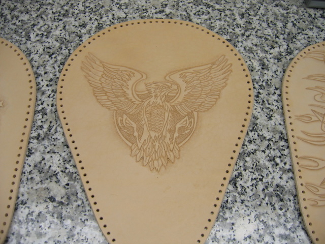

Thanks guys,
The artwork was requested by the customer. Feathers are tedious. I hope they turn out ok.

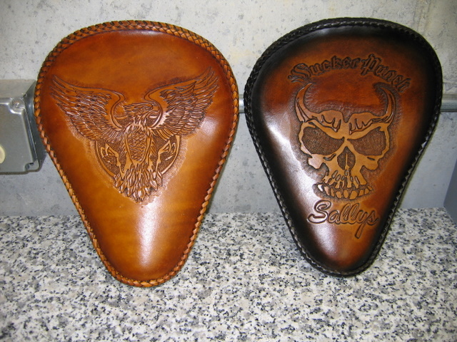

The war eagle seat is finished. A simple buckskin/medium brown stain with a sheridan/medium brown antique paste to bring out the pattern. Finish is leather balm with atom wax on both seats.
There is also shown a standard Sucker Punch seat with the same stain and antique as above but with black stain fogged around the edge.
Hope you enjoy the pics

Hi Dave,
Beautiful work! What do you do to get that foggin look? lol
Do you use a wool dauber? Whats the technique? Hope I'm not being too intrusive!
Thanks
Freddie

Freddie,
Not too intrusive at all, I'll tell you anything and everything I know.....that would take all of 10 minutes..... :lol:
I apply my stain with a touch-up spray gun used in body shops. Mine is an ingersol rand. I run it with a small Campbell Hausfeld compressor.

Thank you for all the compliments, they are much appreciated.
Beaverslayer, the padding is 1/2" neoprene. I buy it from Foam and More in Michigan. They supply it with an adhesive backing (extra charge) and the stuff is just perfect for bike seats. The neoprene is closed cell so it won't hold water, doesn't mildew or rot....pretty much the perfect outdoor padding.

Posted (edited)
Nice David,
Do you think it is easier to use a touch up gun or an paasche airbrush? Im still stocking up on tools and what not so Im curious if I need to purchase both? Can't find that buckskin/medium brown stain anywhere, where are you getting it from.
Edited by JustWakinUp
I certainly wouldn't purchase both.... oh wait, I DID purchase both....mmm I guess if you have one of them, learn to use it well. Only get the other when your original tool isn't working for you. The touch up gun puts a lot more stain on the seat....and in the air than an airbrush would. I use it because I can get a much more even tan color than I can with an airbrush. This is probably due to my lack of skill with an airbrush. For me it only becomes a problem with the tan colors they seem to streak easier with an airbrush.... Black for instance can be applied with anything...broom....mop....etc. :biggrin:
Seriously a single spraying means should be sufficient.....just practice until you are actually good with it.
