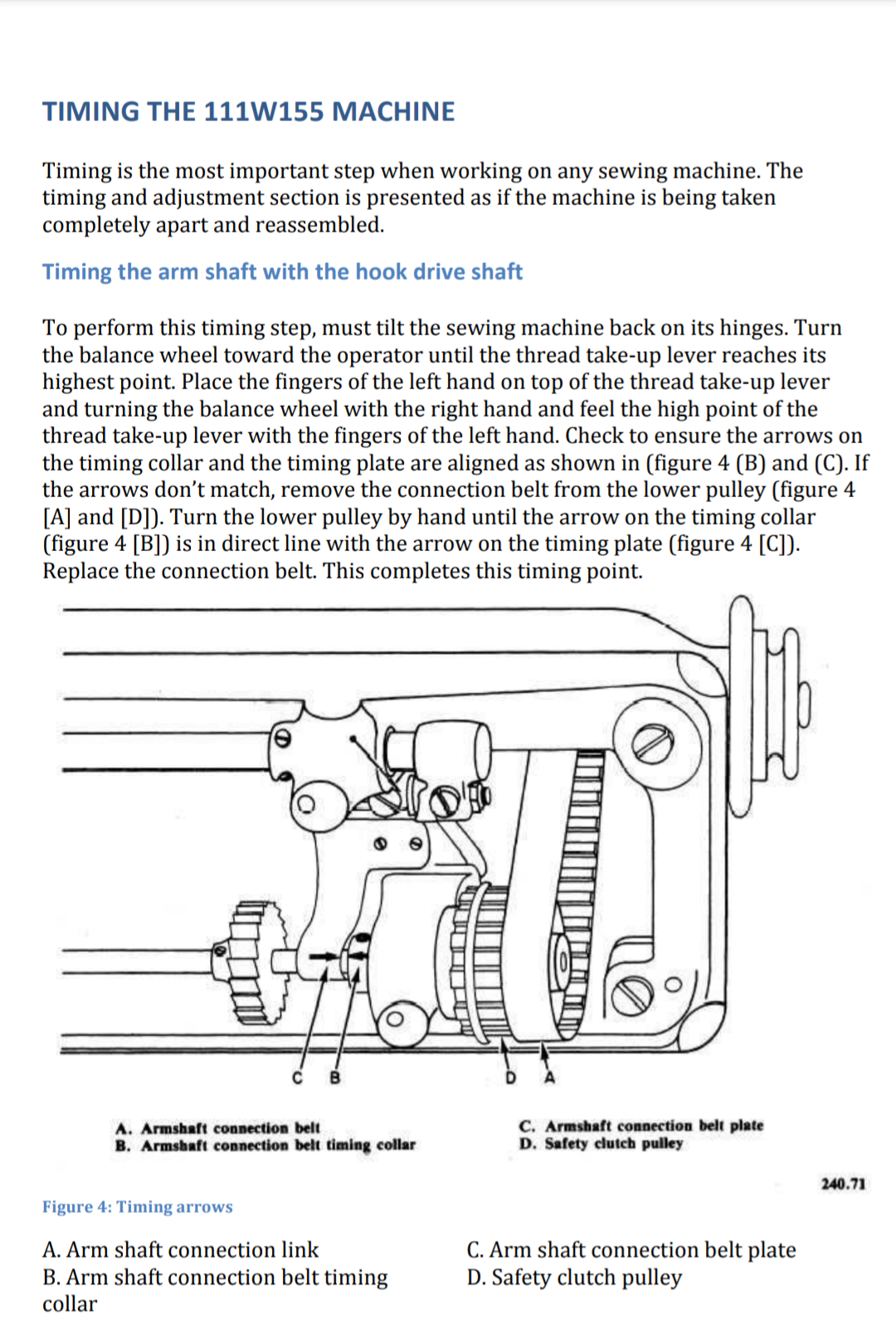

  2. Looks like the belt is one tooth off.

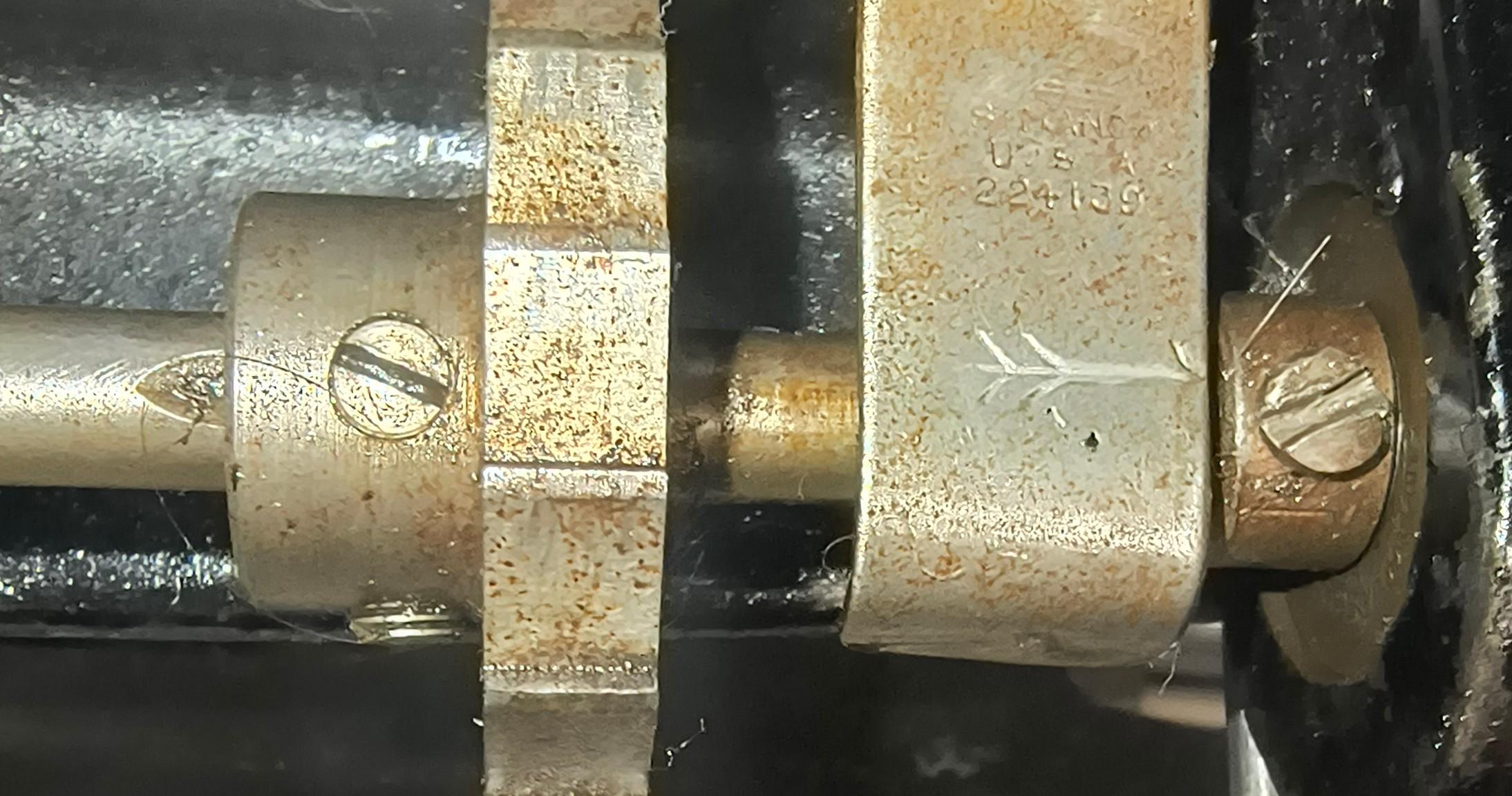

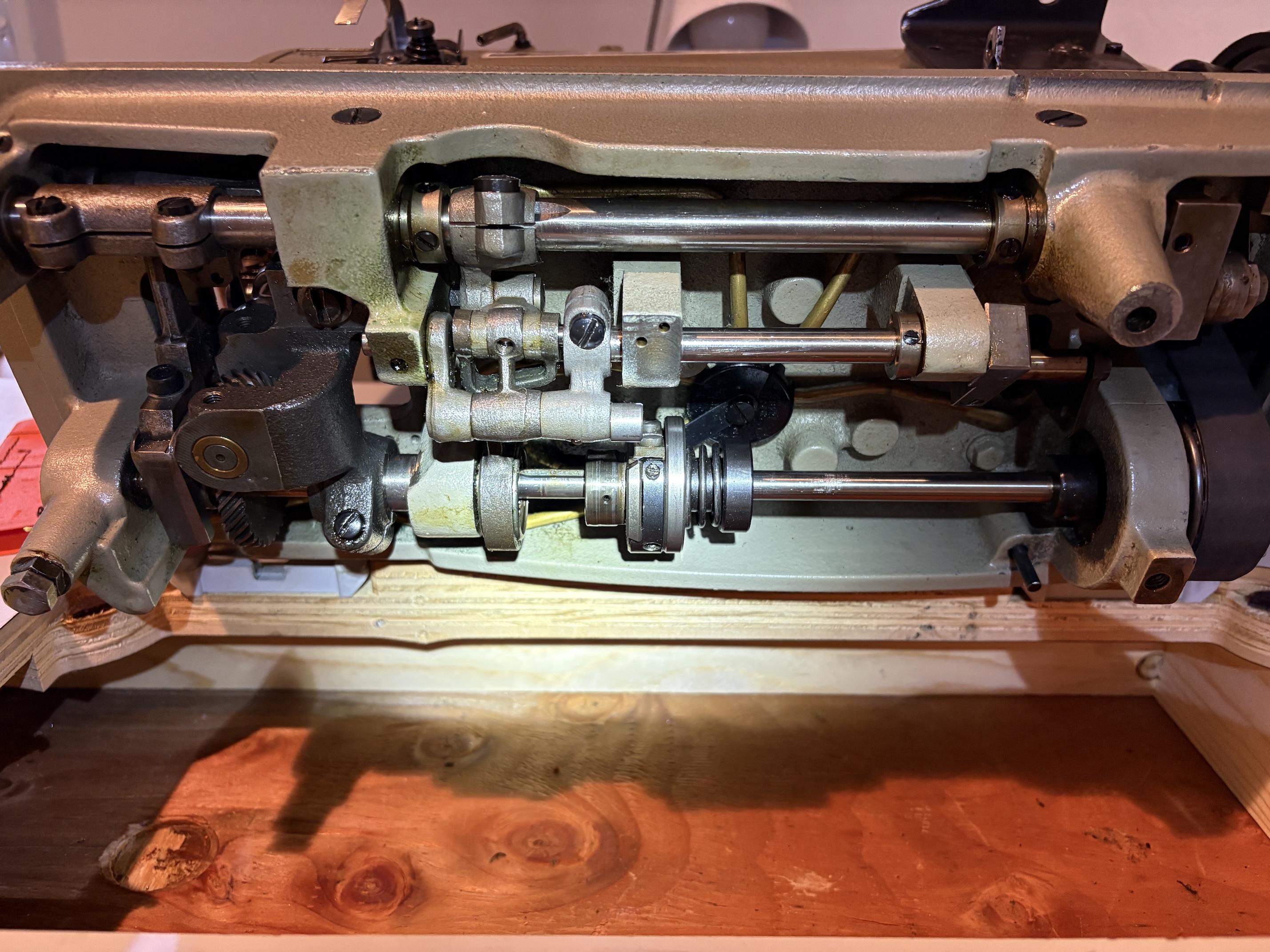

  3. My arrows don't line up, the collar could be locked into any position
  4. Here is left of the drive belt

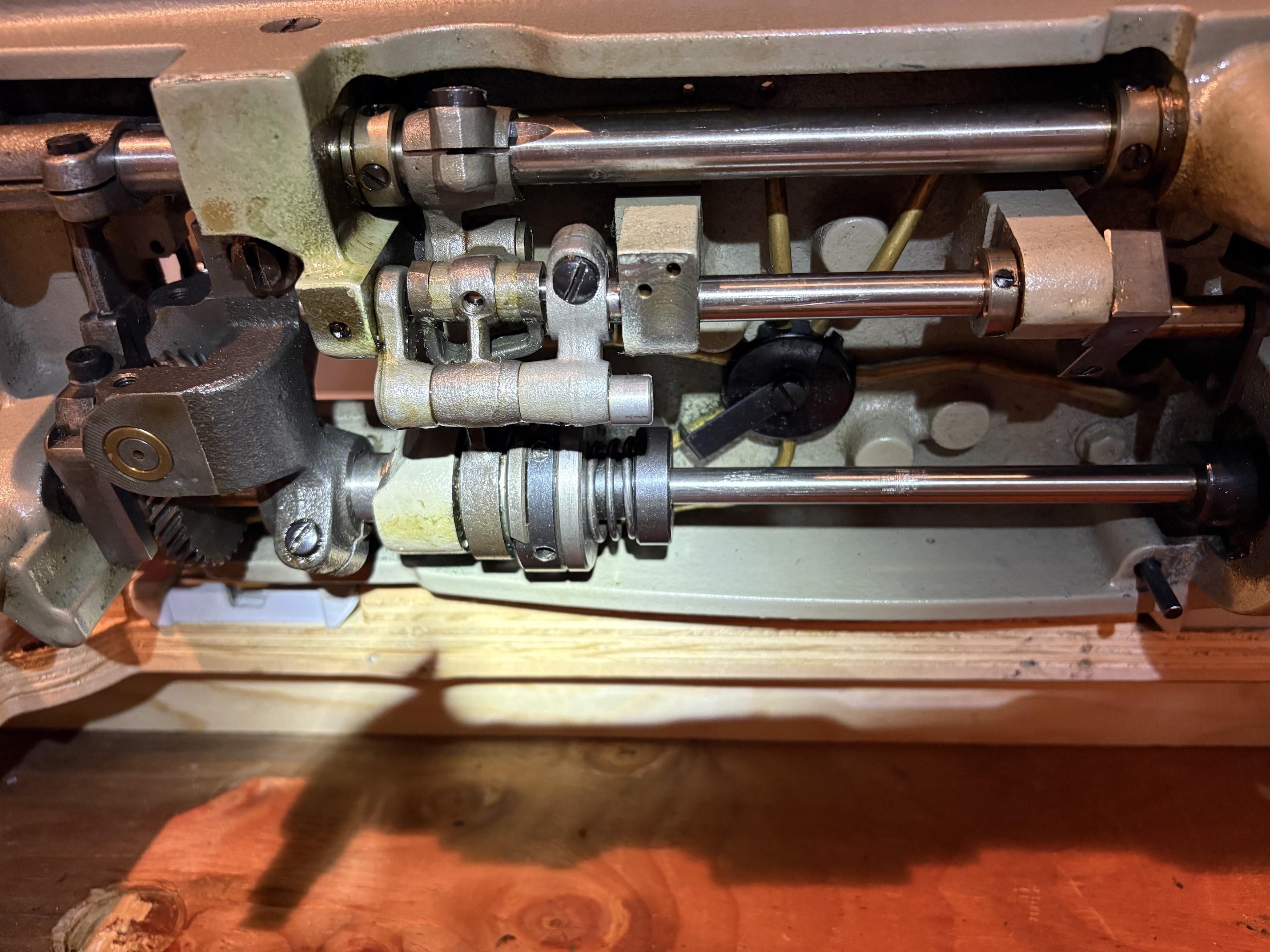

  5. I realize my lower plate is loose. Here is the underside pic of the adjustment made. I'd like to verify this entire shaft is timed correctly. Anyone know at a procedure?

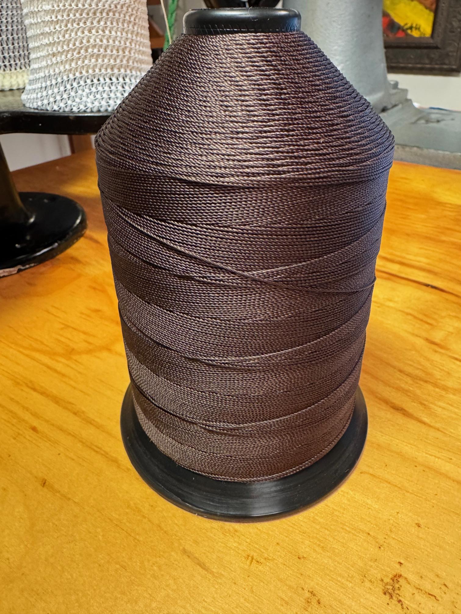

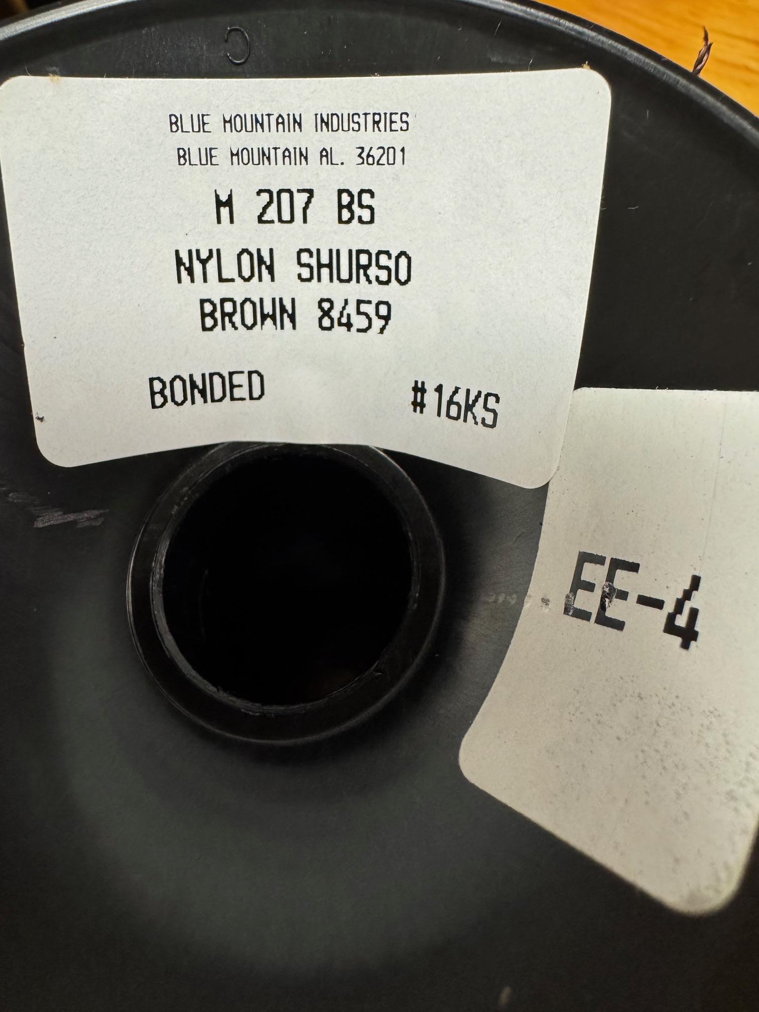

  8. Does anyone know anything about Blue Mountain Industries threads? I was given 6 one pound spools of 207 "Nylon Shurso" bonded thread I cannot find any information about the manufacturer... thanks...

  12. Oh I see.. The feed eccentric slid about 1.25 inches to the right, exposing the actual cam lobe. Based on the manual page 24, "Feed Eccentric Adjustment", I think you are to slide the feed eccentric to the left so the cam lobe goes inside the pushrod, then apply your chosen amount of pressure to the left to compress the "feed driving eccentric adjusting disc spring" to achieve your chosen amount of spring pressure. Then tighten what appears to be set screws in the collar that holds the spring.

  14. It looks like I spoke too soon. It did seem to "walk", so I tried adjusting the stitch length (still without thread, just trying to get a bigger "step"), and when turning the wheel with the button pressed, it seemed to have no resistance, and the results were very flaky. Sometimes it would walk more-or-less as expected, sometimes almost not at all, and sometimes it would even go in reverse (without the reverse lever pressed). So I started looking at the "Feed eccentric adjustment" on p. 24 of the manual, and that thing in the 2nd picture slid out of place, and doesn't seem to be attached to anything. Is it supposed to be like that?

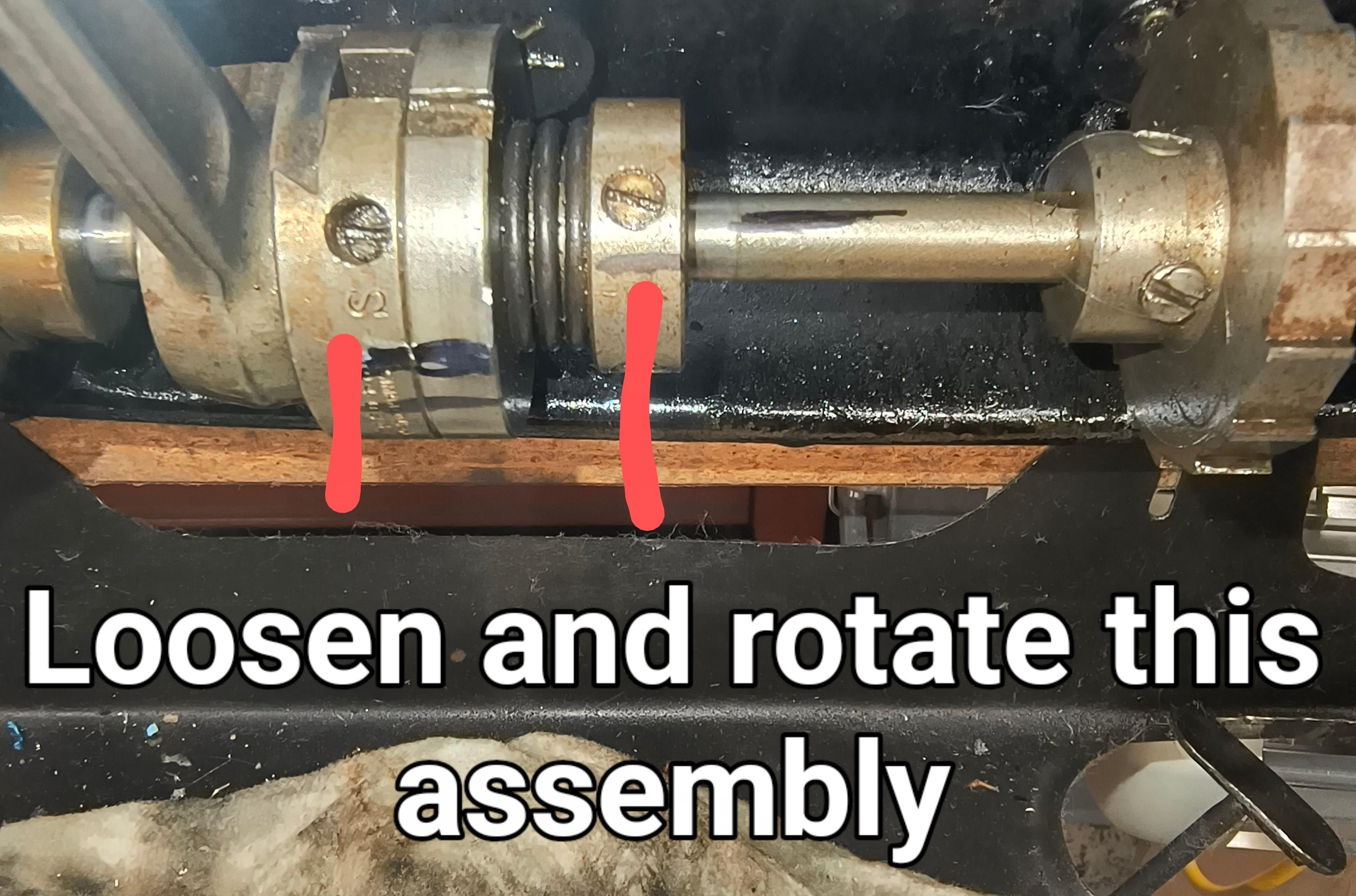

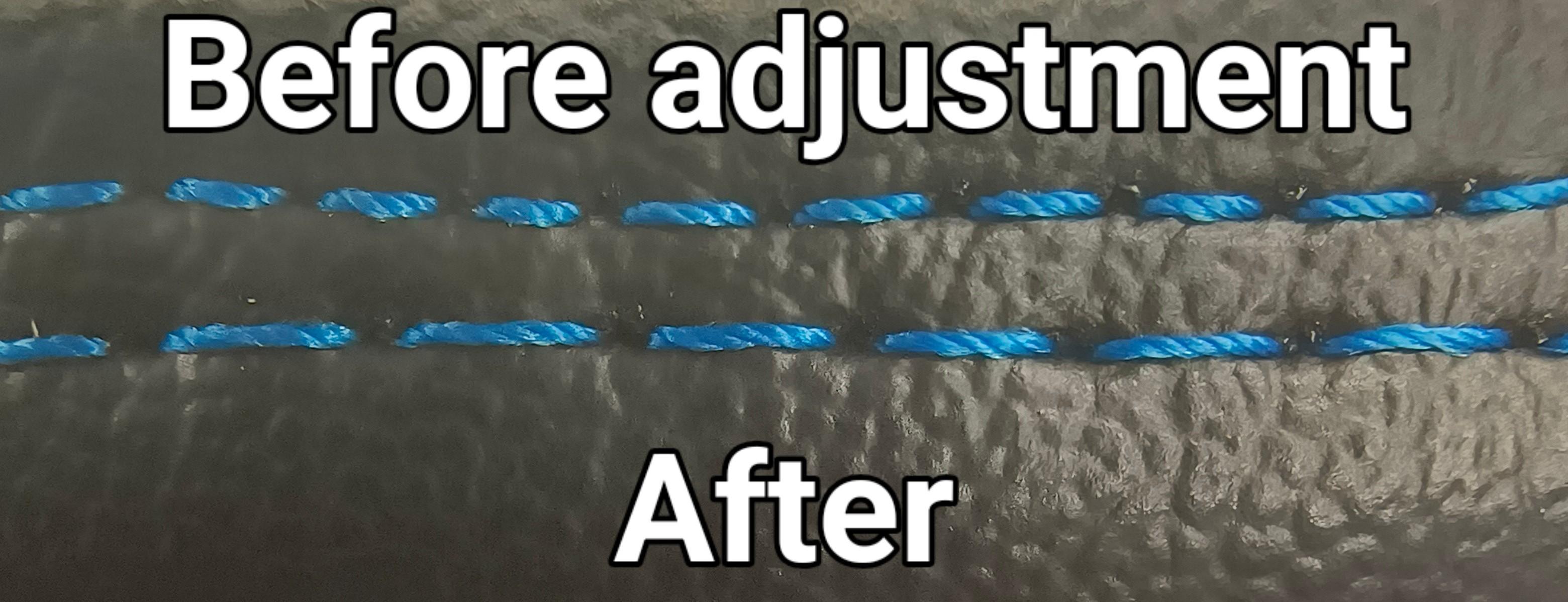

  15. friquant, Yes I can adjust the stitch length, from the longest stitch all the way back to zero. Yes it hits a positive stop rotating either direction. Reading a naval manual it mentioned to set the take up at the highest point. Loosen the dovetail cam assembly and rotate forward. The pics and video I'll be attaching soon are after this adjustment, it's yield is about 5.5/in. VID_20250902_165612895~2.mp4 VID_20250902_165612895~2.mp4 VID_20250902_165612895~2.mp4

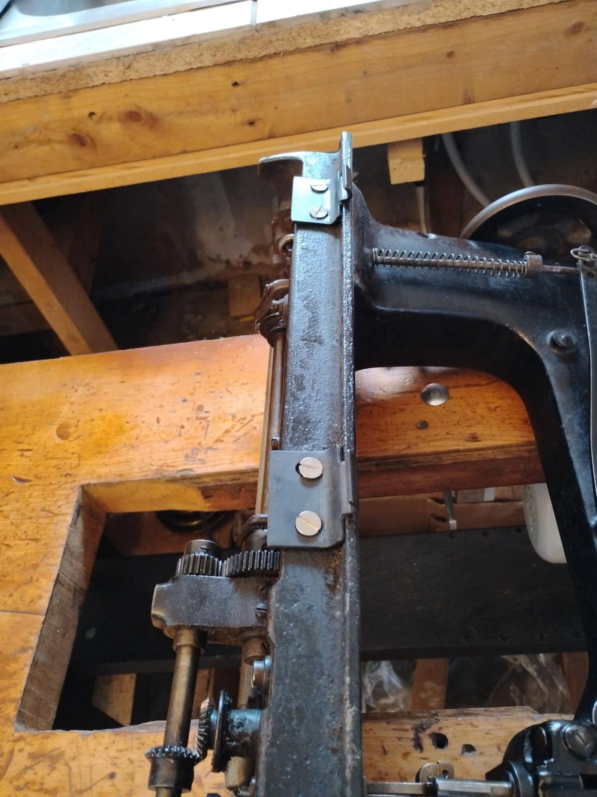

  17. They even match the paint job! 🤩 Does your machine have a piercer? That manual that Bob linked shows a piercer on page 22. I wondered what those are for..
