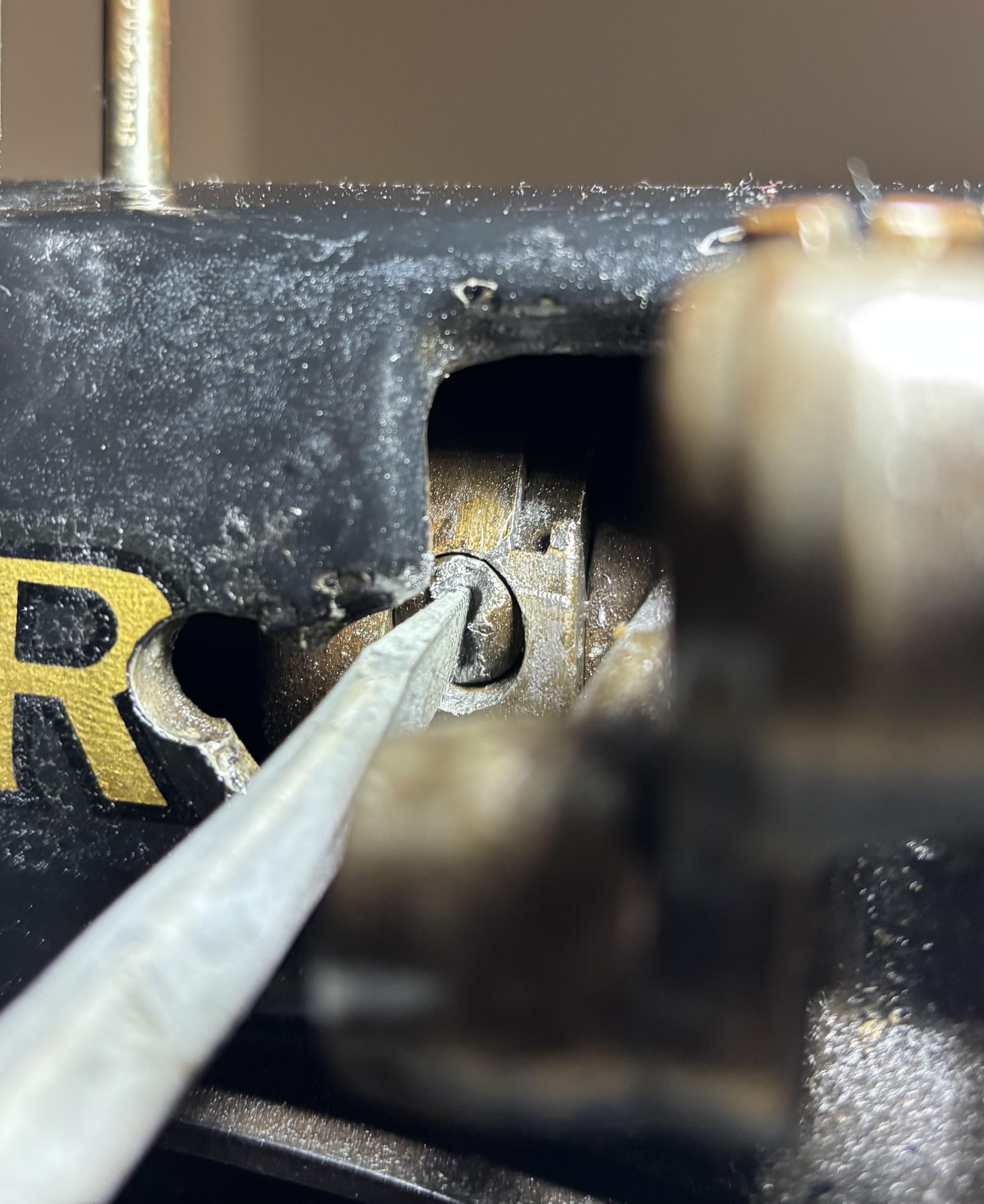

You guys rock! Thank you so much for all the amazing advice. Friquant, thanks for the heads up about adjusting that clamp screw in back. I did try that one first, but I ended up with the machine binding before I could get enough lift out of it, so I figured the next step was the stripped screw "C" in question for the eccentric. Great point about extending the filing to the edges of the screw...I think that should help a lot. I will try a flat sided carbide burr! I posted a pic of the screwdriver in the screw groove. As you can see, it's not quite tall enough and definitely not thick enough. I will either search for one or work on filing down a piece of metal to serve as the new driver. Dikman, I love the idea of drilling out the center of the screw with a small bit but still keeping the flathead groove on and use that to loosen it. I never thought of "coring" out the inside of the screw to relieve the pressure like that, but it totally makes sense and sounds like it will work! I think laying the machine down on its front is a great idea and will be very helpful. Alzilla and Friquant, do you think the impact driver is too much force against the shaft that this all rests on? I have one of those things but hesitated to use it. Thank you all again!! -

I wouldn't heat those parts. I don't know what that would do to the hardness. But I would lay it down and build on what looks like a pretty good dimple almost dead center. I'd get a punch and make that bigger and deeper. Then I'd start with an 1/8" drill bit and work up. You'll need to determine how long that screw is so you don't drill through it. -

A straight-sided carbide burr to try and get a deep slot with a flat bottom and parallel sides. Try heating the screw again and then hit it with a freezing spray. Drill through the screw, sometimes this can relieve pressure on the threads and allow it to move. Doing this first and then heating should allow better heat penetration to the threads and then a screw remover tool. Just a few ideas, of course the screw will need to be replaced and if you can't get a replacement then re-tap for an allen-head grubscrew. -

When dremeling the slot, I would go all the way to the edge of the screw head. If you overrun and go into the eccentric a little bit that's okay too. Make the sides of the slot as vertical as possible. Do you have a flat-ended burr? You may be able to scrape the sides into better shape (with a flatter bottom) using a smaller flat screwdriver or the pointy end of a file. Can you post a photo of the screwdriver bit that you are using, next to the screw you are trying to remove? Ideally the bit would be the full width of the screw head, and the full thickness of the screw slot minus just enough to get in there. I would lay the machine on its front (make sure it's supported well, not resting on any delicate parts) so you can press down from above using your body weight. I've started using a drop of diesel instead of PB blaster. When removing stuck screws, I go one way then the other. Add more heat. We're talking kitchen-sized torch, not cigar lighter. And consider the manual impact driver. -

As for removing the screw with the mangled head, has anybody tried a manual impact driver on their sewing machines? https://www.amazon.com/LEONTOOL-Extractor-Reversible-Screwdriver-Fasteners/dp/B0CTXD91YW -

Thanks Constabulary! I agree that the screw extractor could work. I'm trying to postpone that option because I feel like maybe deepening the screwdriver groove might still be a viable option, but I admit it's hard to get the contour good enough that a screwdriver will really bite. I appreciate the suggestion! Anyone know if replacements for this screw are available? I'm open to any and all ideas! Thanks again -
