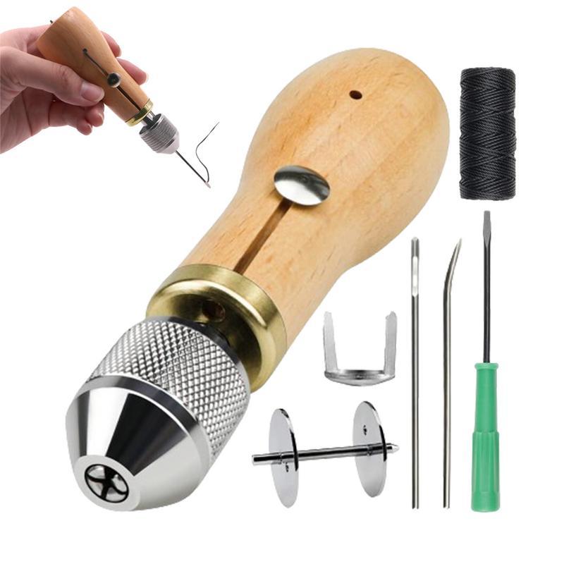

  3. The 'Speedy Stitcher' does a lock stitch and I've used it a few times. In places where I wasn't able to do a saddle stitch
  4. It never occurred to me to try making a lockstitch by hand. I can't remember what this gadget is called but it does a lockstitch.
