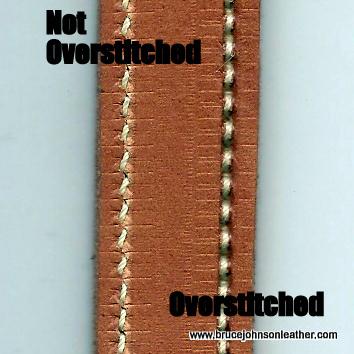

Yes, but only in the sense of the older hook and awl machines. They have an awl that prepunches the hole followed by an needle that carries the thread. They can pull a tighter stitch by nature and a cleaner looking bottom stitch. I know that is not your question but it is my answer. As far as the closed needle machines I don't think that one particular machine will shine above the others once you get to decent machines. The variables of thread size overall, one size smaller thread in bobbin vs same thread top and bottom, needle size, type of needle (straight vs slanted), stitch length, leather thickness and consistency, chrome tan will pull in tighter than veg tan, bottom feed dog, tension top and bottom, and probably more all affect the appearance of the bottom stitch more than the model and mechanics of the machine. We have three closed eye machines - Ferdco 1245, Ferdco 2000, Cobra 26, and have had others. I can make one look better than the others if the others aren't set up optimally. I can make them all look the same too with the changes above. What does improve the bottom stitch on all of the closed eye needle machines? Overstitching. Roll the bottom side stitch line with the appropriate size overstitcher. It sets the stitches, rounds the stitches between holes, and gets as close as you can get to the top side appearance. It is the 2 minute time difference that makes a big appearance difference. This example I did on the fly several years ago. I purposely put an old needle back in the machine to get some "blowout", probably 207 thread, 9 or 10 SPI, same size thread top and bottom. hard leather, heavy presser foot pressure. I think it looked pretty rugged right out of the machine. The right side looked the same as the left in the picture but was then rolled with an overstitcher. All it needs after that is the presser feet marks rubbed out to be pretty nice appearing stitching.

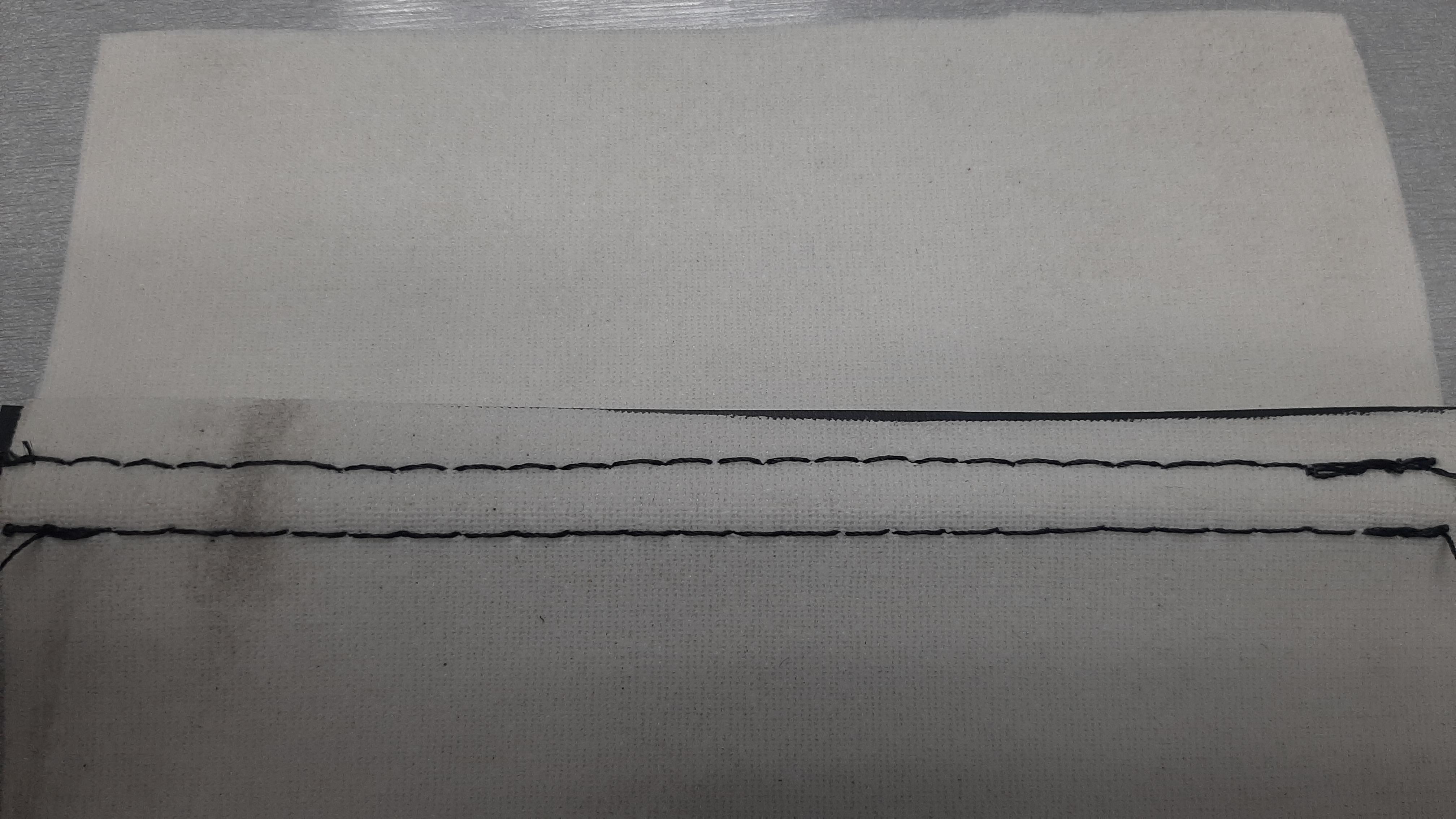

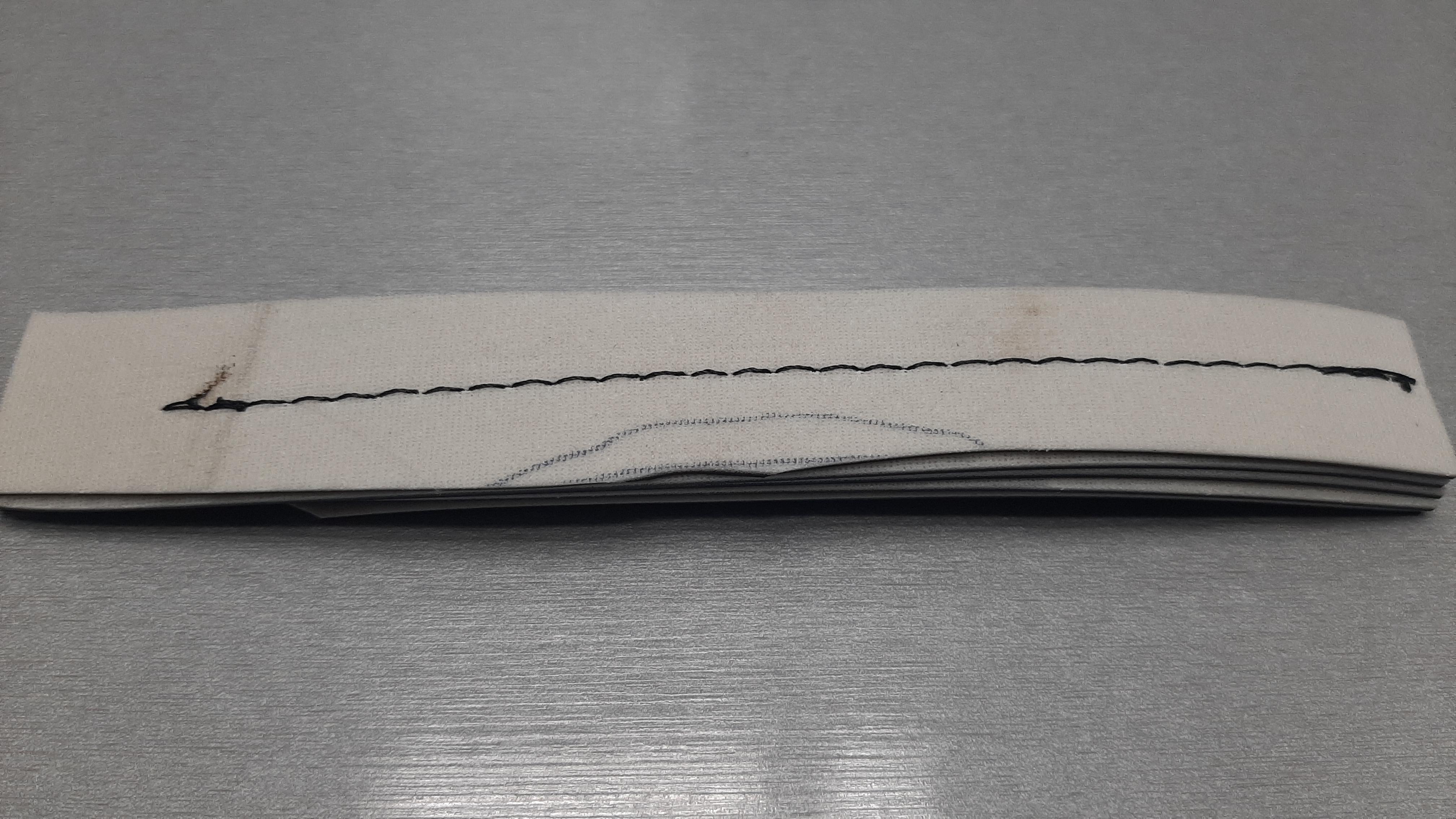

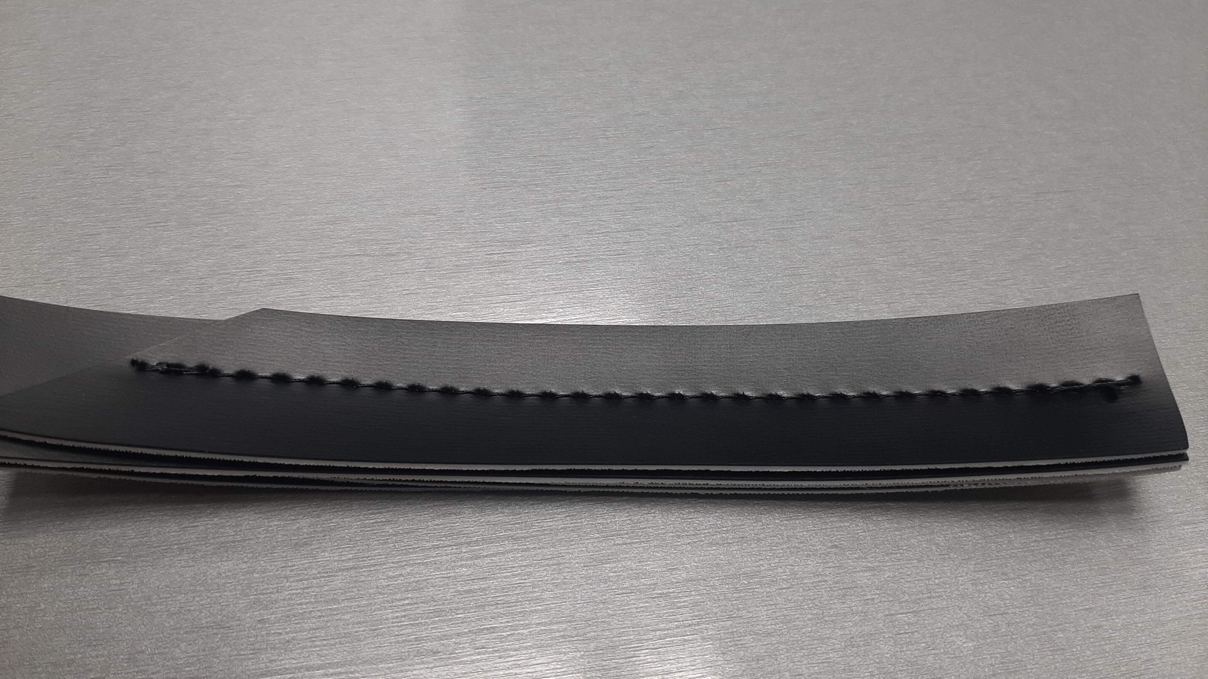

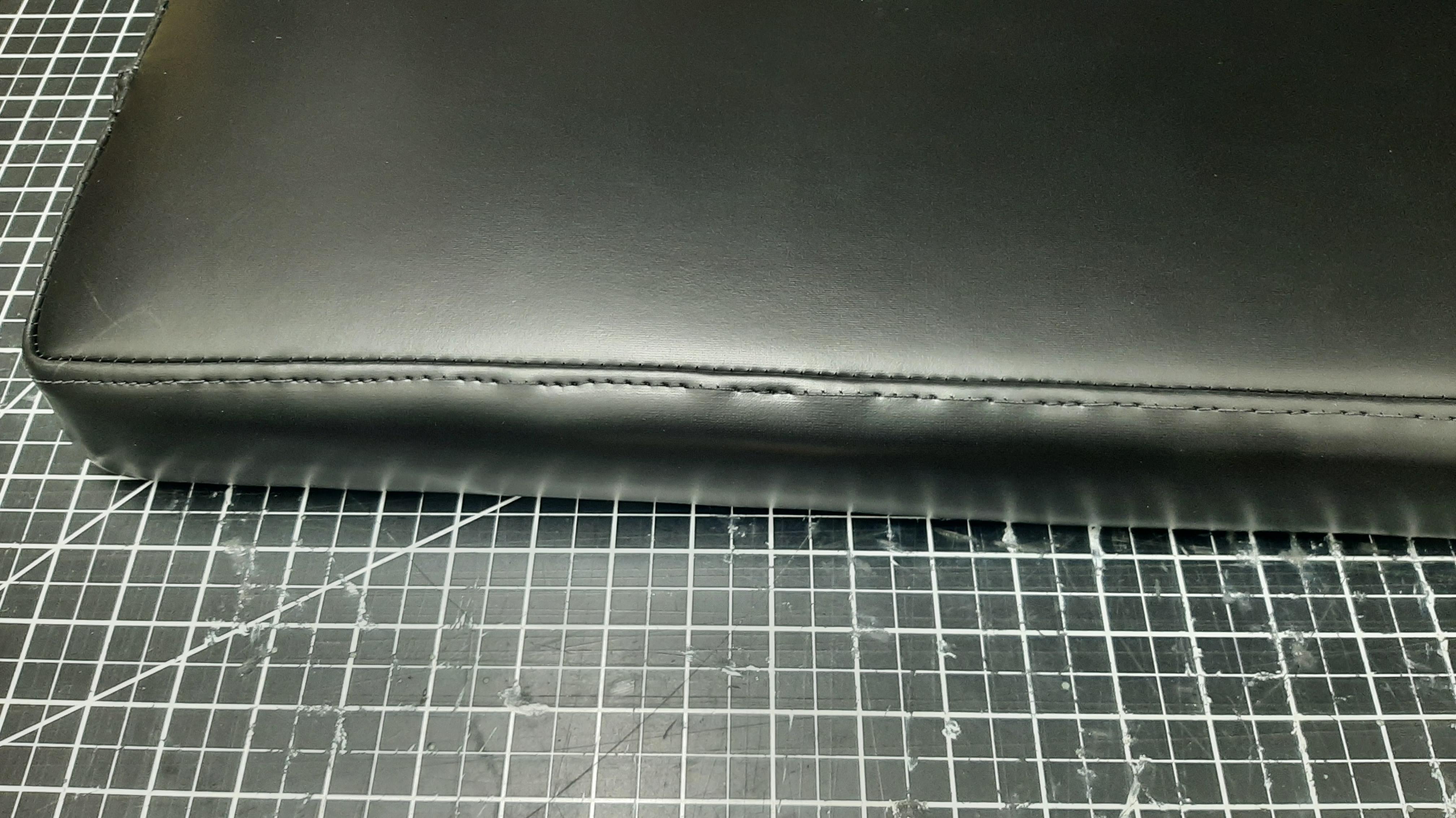

Ok, congratulations are in order for missing some stitches. Especially that last photo of the prototype cushion! 🌠An informative exercise would be to put something like that cushion seam back under the machine so we can see some skipped stitches as they form. Then tilt the machine head back so you can see the underside of the machine. Get a good light or a flashlight, and reading glasses if they help. Then turn the handwheel by hand to make slow stitches, but watch what's happening from underneath. Pay attention to what it looks like when it actually makes a stitch, and to what happens when it skips. Let us know what you see! (More to come)

Sorry for the delayed response... My needle is a brand new 135x17 size 20 69# Nylon thread for bobbin and top Material is 1/16" thick. So, 3/16 for the two pieces and a top stitch. The first two photos are of five pieces of material sewn at once 5/16" with no skipped stitches. Top and bottom The third and fourth photo is of a top stitch with only missing once. Top and bottom The fifth photo is of an example of tons of missed stitches with the same setup.

I doubt if any of the machines generally used for things like notebooks will be much different in how the reverse side stitching looks as they all operate the same. If you want the best looking stitches and the reverse-side is a concern then hand-stitching is the best option.

Has anyone noticed the attractiveness of the bottom stitches to be machine-dependent?
