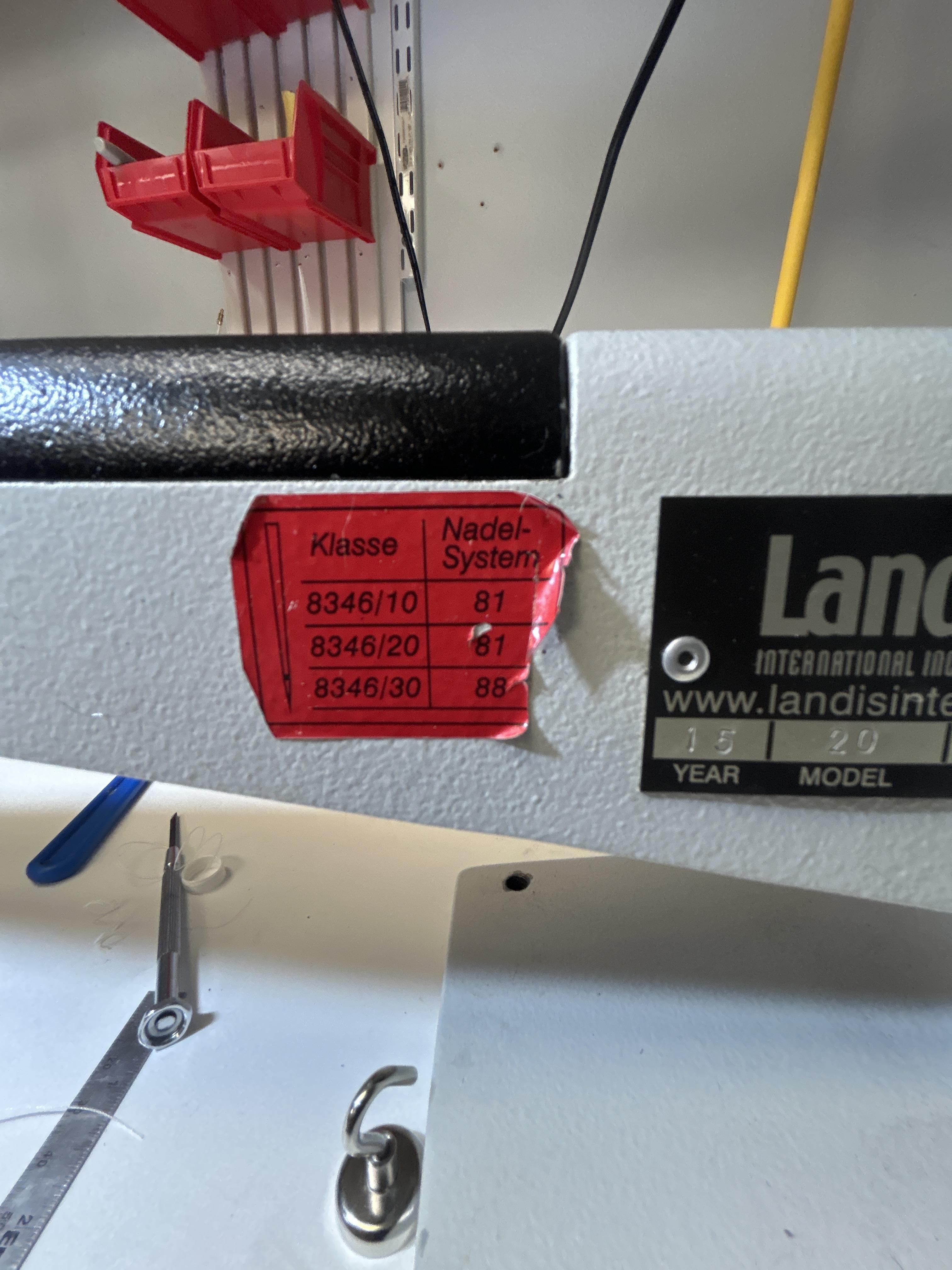

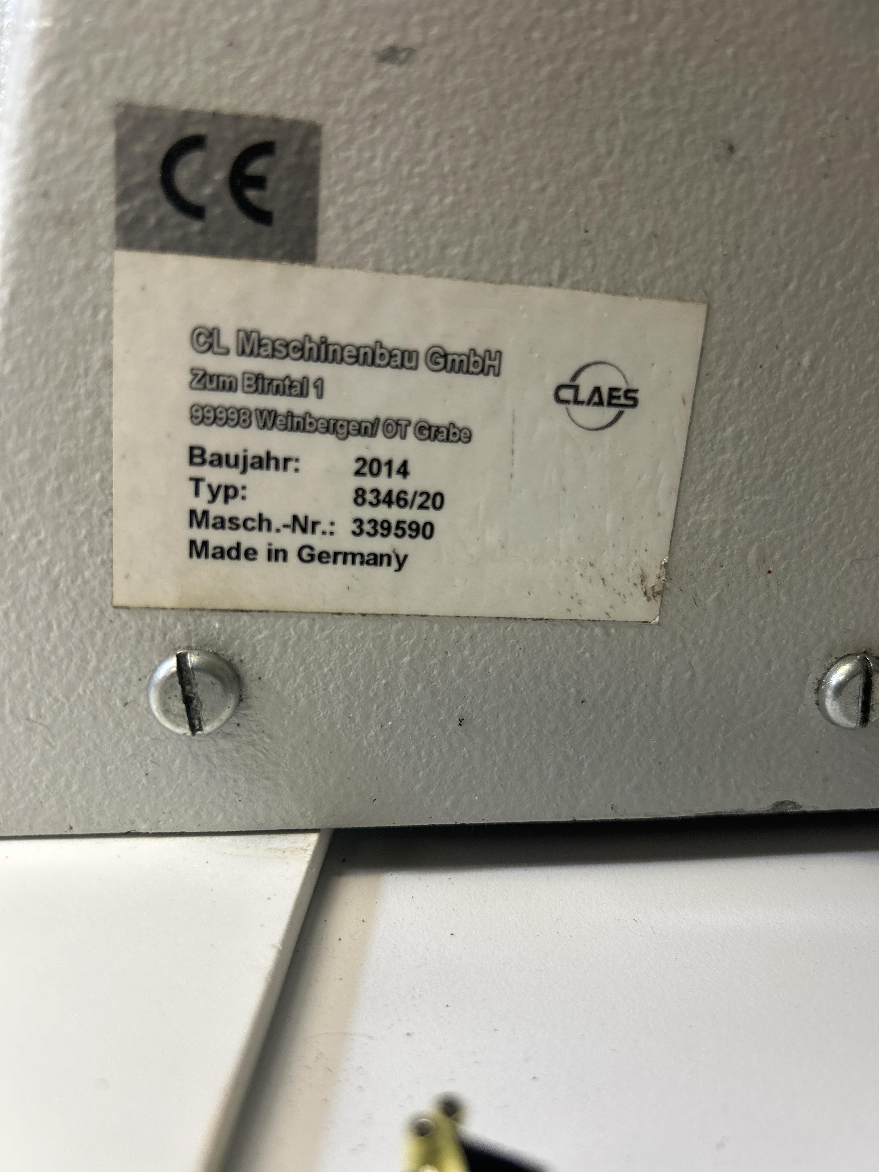

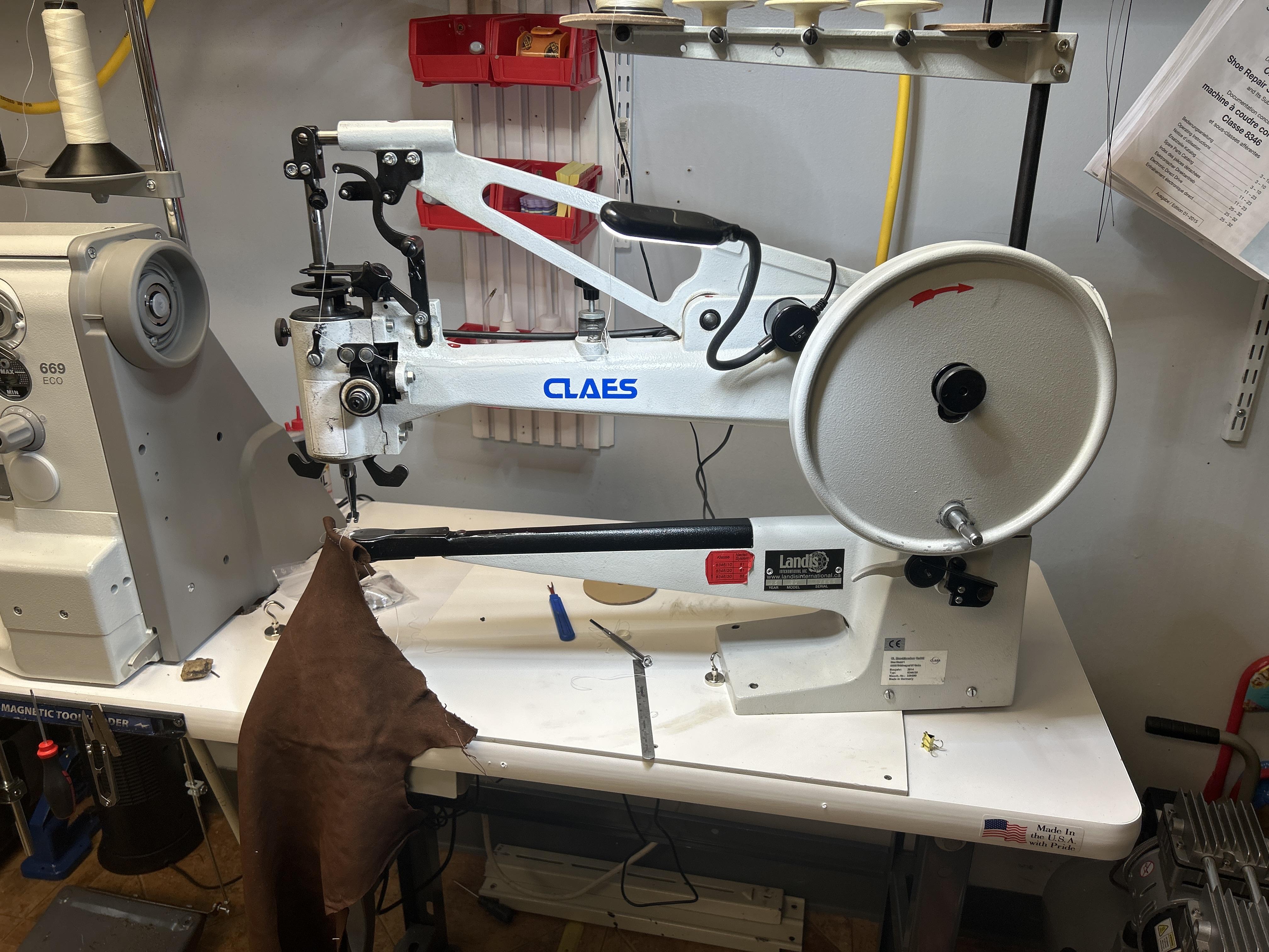

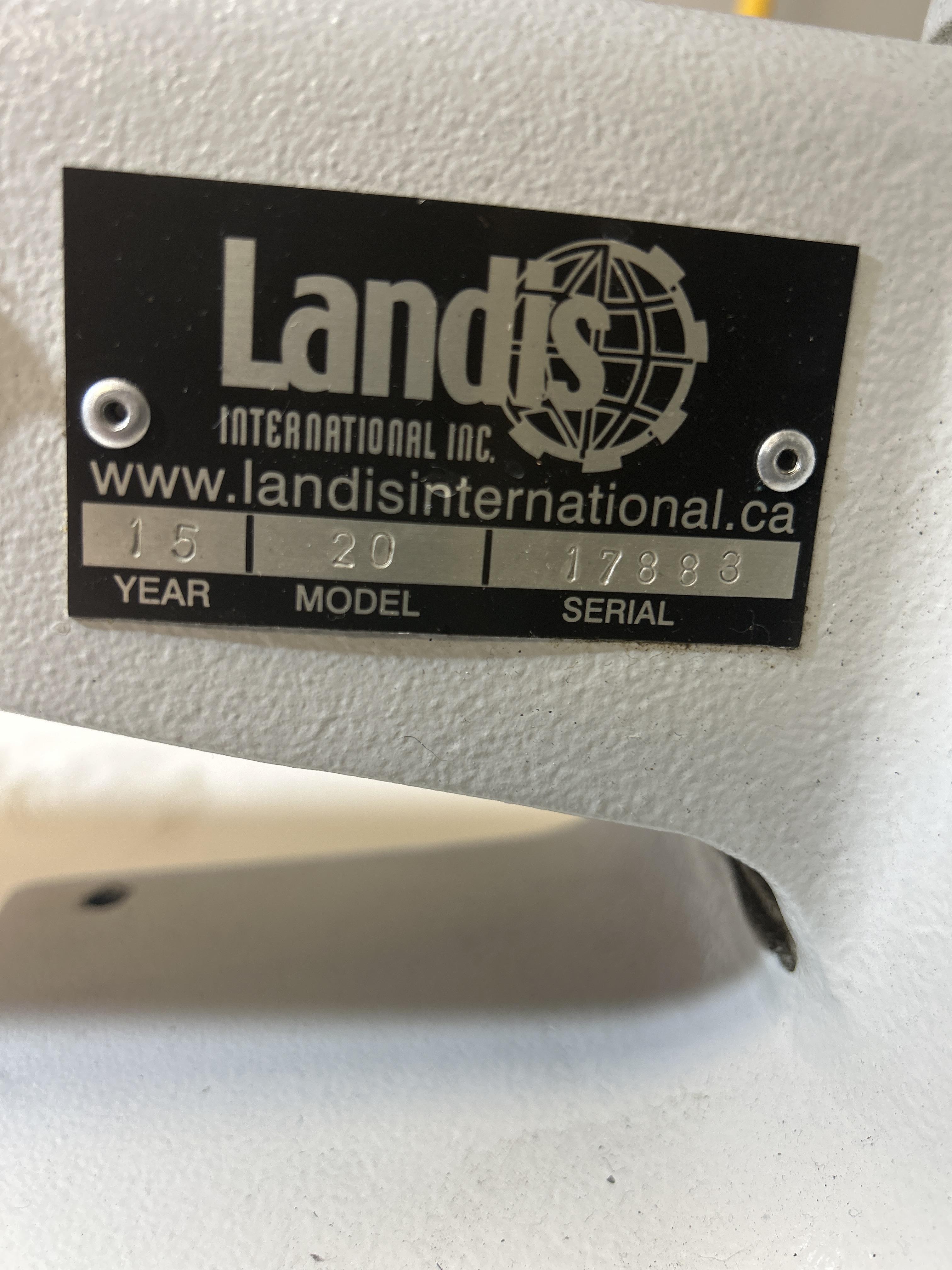

  2. My apologies to you, I was so in a hurry to show you and tell you what was going on. I forget to send that information.
  3. well they are not all the same, thats why I asked for the model - CLAES has a long history and made patcher machine for many decades. Beside the even older "COLIBRI" and "Patent Elastic" machines they had the Model 201, RPX, 200, 8345 and 8346 - I assume you have the latest 8346, right? Just from the picture I would say you have a tension problem but no timing problem. Can you post pictures of how you have threaded the machines? I assume a loss of top tension for what ever reason.

  5. I really appreciate your help. So we won’t get confused the first machine we will call machine #1 It’s not working 95% correctly. The second machine we will call machine. # 2 , which I purchased 10 years ago. I’m having timing issues with it. Since all Claes machines are the same, I tried to adjust the timing of machine #2 to the same timing as #1 but no success. please note the second and third photos are the same but from different sides.
