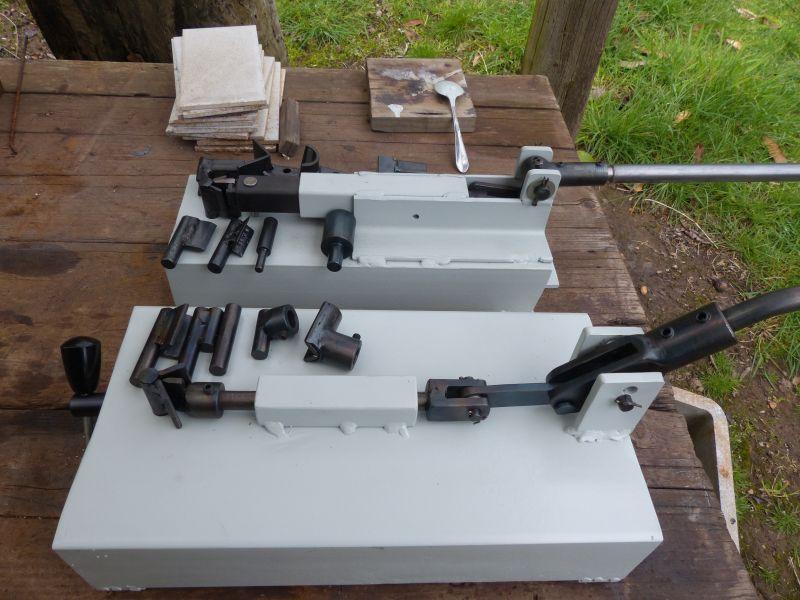

I made another die bending jig. I had the idea to make one with a simpler linkage so just had to do it. Unfortunately while the linkage looks simpler it took a bit of messing around to get it to work, and the angle of the handle is too high which meant I had to put a hefty downward bend in it to get it to a comfortable height. I might re-make the handle linkage as my original idea seems to work better. The other difference is the push slide, the original square tube sliding in a square tube has a bit of slop in it, the rod version is quite a snug fit, but it meant attaching the fittings to it was more complicated. I now know how to make an even better one - but I won't as it will require too much machining and there's nothing to be gained.
