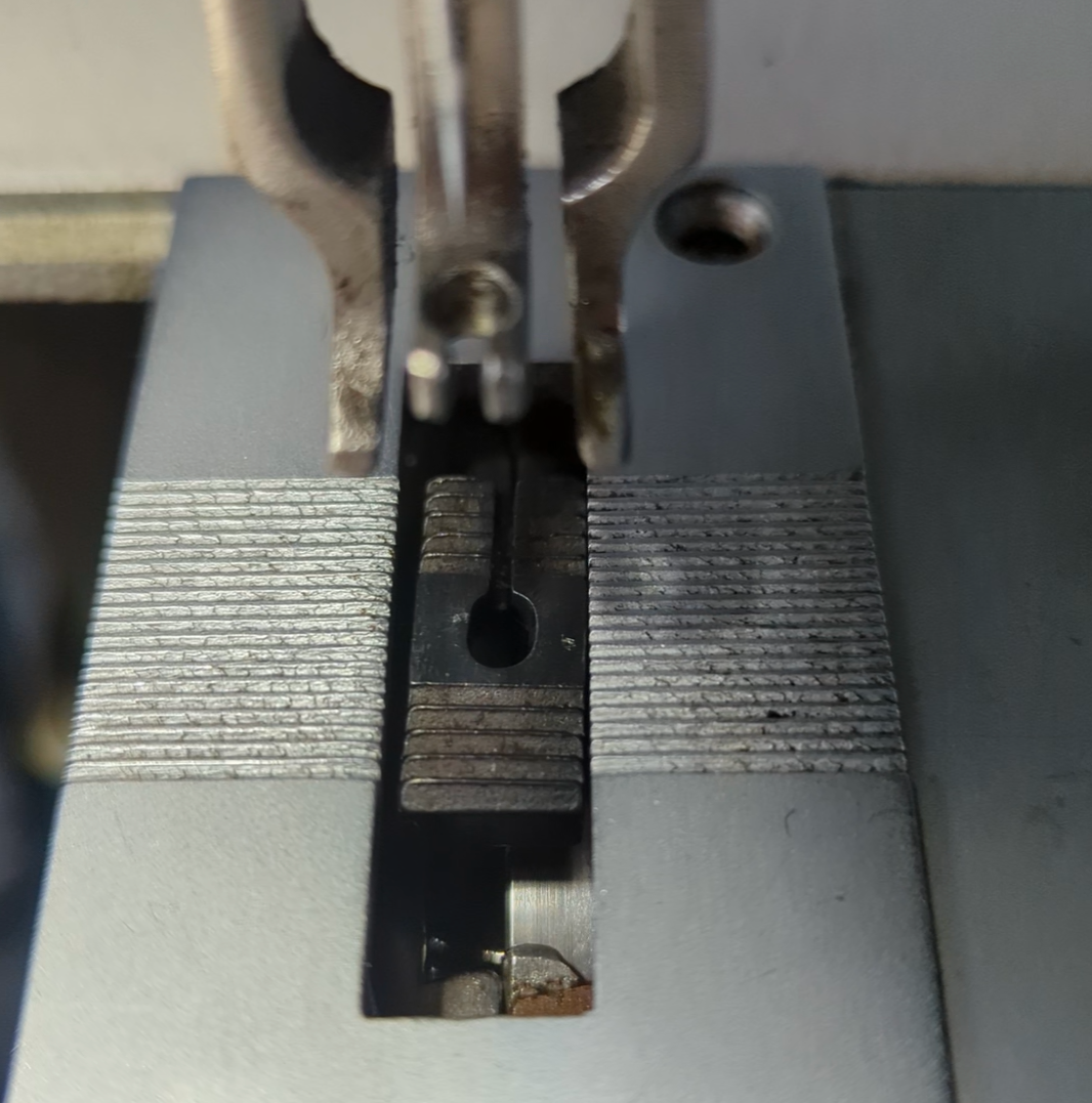

  2. You can move the feed dog holder a bit sideways.The feed dog holder is attached to the feeding rod with 2 pointed screws (one on either side). When I look at this picture I think the feed dog seems to be misaligned. What I would do first is loosen the 2 feed dog screws and try to align the feed dog. Then I would try to move the feed dog holder to the left. It should be the same as on Singer or 45K or Adler 104 flat bed machines. I´ll take pictures tomorrow... Then I would try to move the feed dog holder to the left. It should be the same as on Singer or 45K Adler 104 flat bed machines. I´ll take picture tomorrow

  11. Not totally banned in UK yet. In the UK its the weapon of choice for gangs. To be killing other gangs or often innocents (yes, real innocent people). We don't have any real wild areas where a machete is needed but a few groundsmen and gardeners have them in their tool boxes

  13. @AlZilla It's in the post below the one you mention that I am wondering if it's bent or not (post is still visible on previous page). I cheched it and can not decide if it's bent or not... It's hard to tell when you have nothing to compare to so I ordered a new one but won't get it before two weeks Meanwhile, I put a 230/26 needle in the machine (I normally use 160/23), as asked in engineer's manual and needle was rubbing on the shuttle point so I set "needle to shuttle clearance" accordingly, it's not rubbing anymore I am now trying to set up "needle to shuttle driver clearance" but I am confused trying to understand what I have to look at. Is it the part of the shuttle circled in red in my pic ?

  20. Your first version of this post said the feed dog was bent. Have you decided it's not? Maybe drop the foot and lower the needle to evaluate the position of all 3 (foot , feed dog and needle) to get a better idea what's going on.
