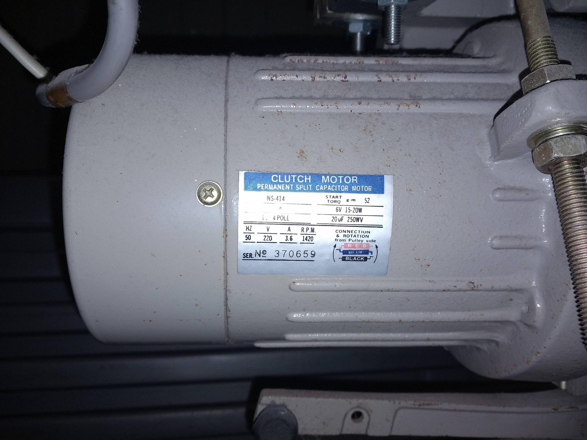

checked the clutchmotor and it runs at 1420 RPM thats gonna be a bit extreme for me so i ordered a smaller pulley and see if thats gonna be enough gonna be a big difference hopefully as there was a big one on there.
