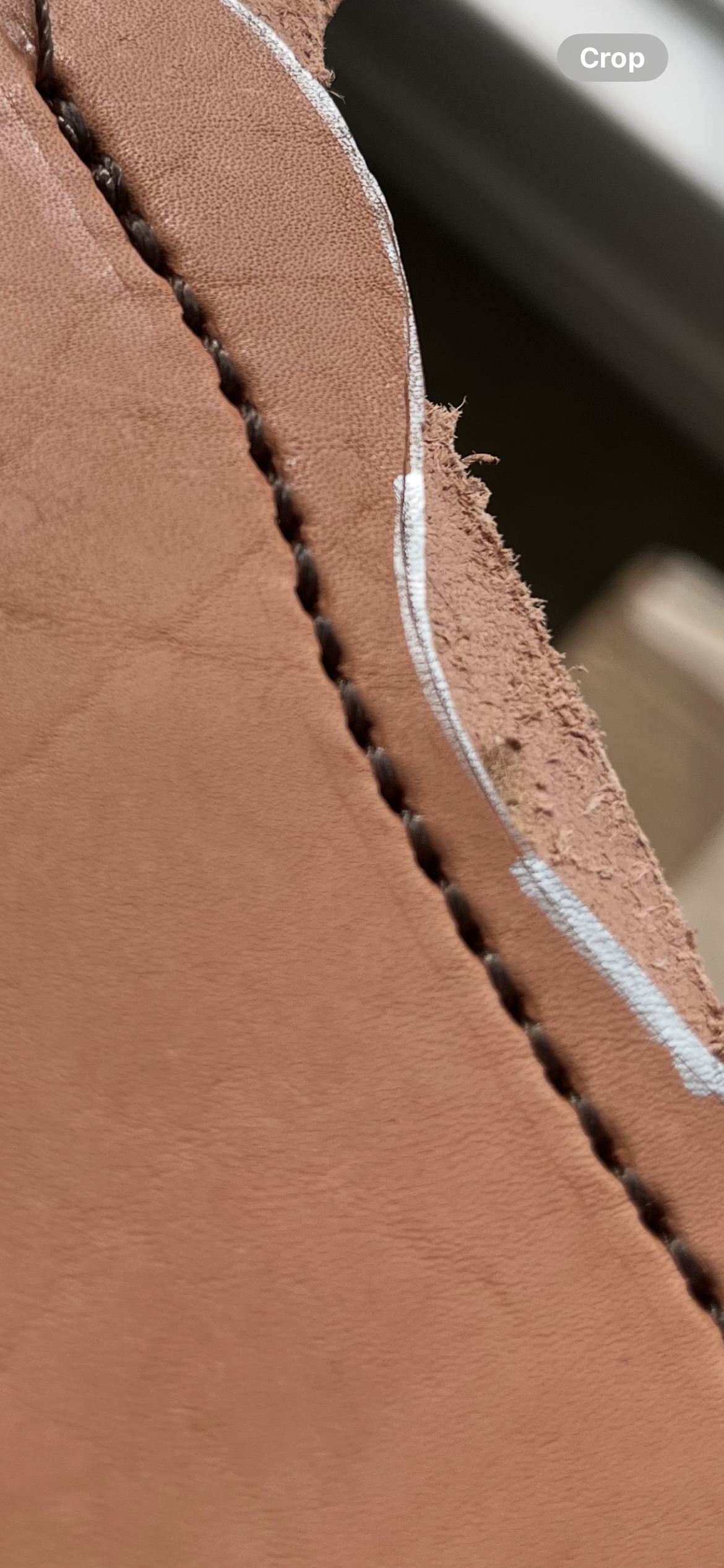

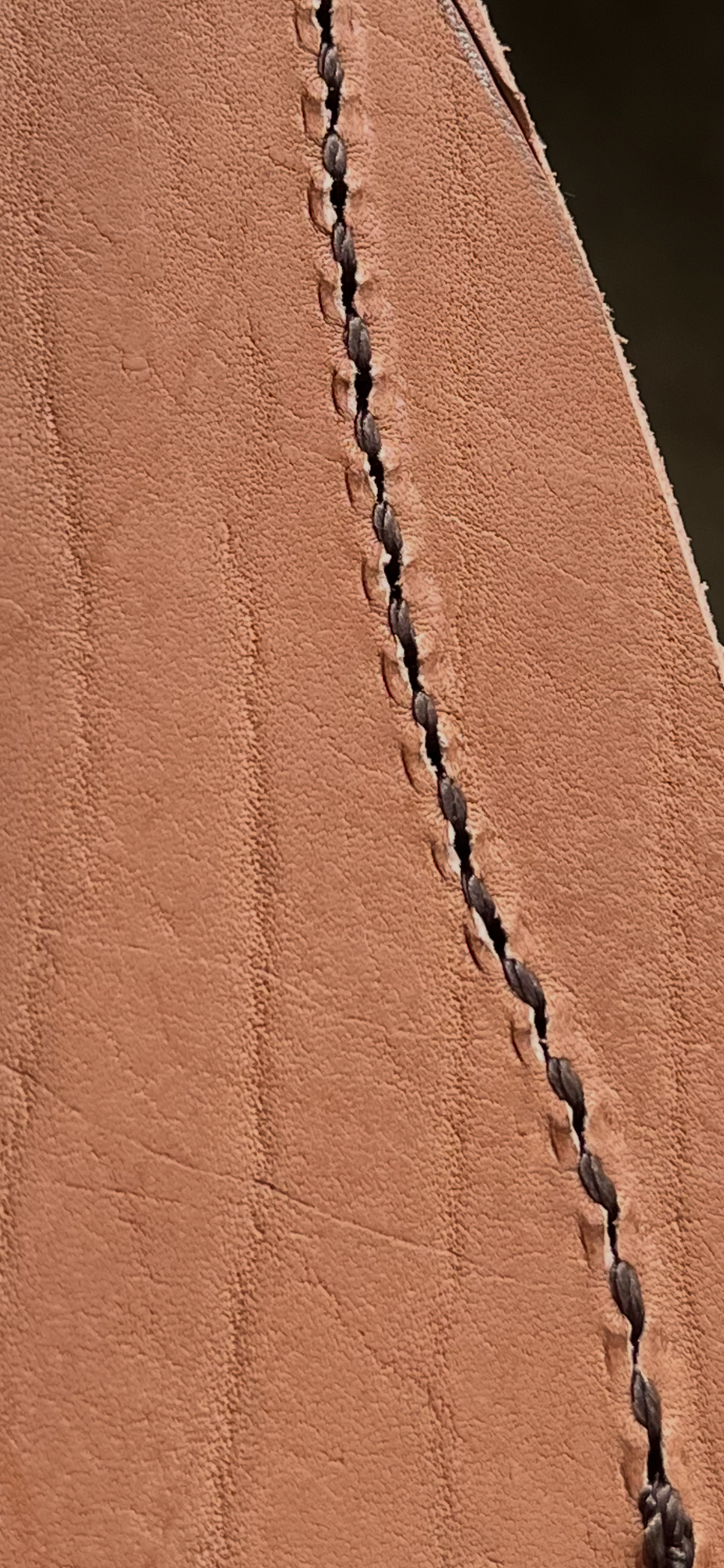

Hello! My Cobra Class 4 just arrived. First machine, and I'm trying to get the tension right. Will usually be sewing 5-6 oz - 10-12 oz, so I'm hoping to hit the right tension that can be used for most of my projects so that I don't have to mess with it too much. Will probably stick to 277 bonded nylon thread. The top stitch looks okay for the moemnt, but the bottom stitch looks whacky. Should I loosen the bobbin/bottom tension a little bit? All I've done so far is loosen the top tension about 1 full turn (achieved through small increments). I turned both top tension knobs.
