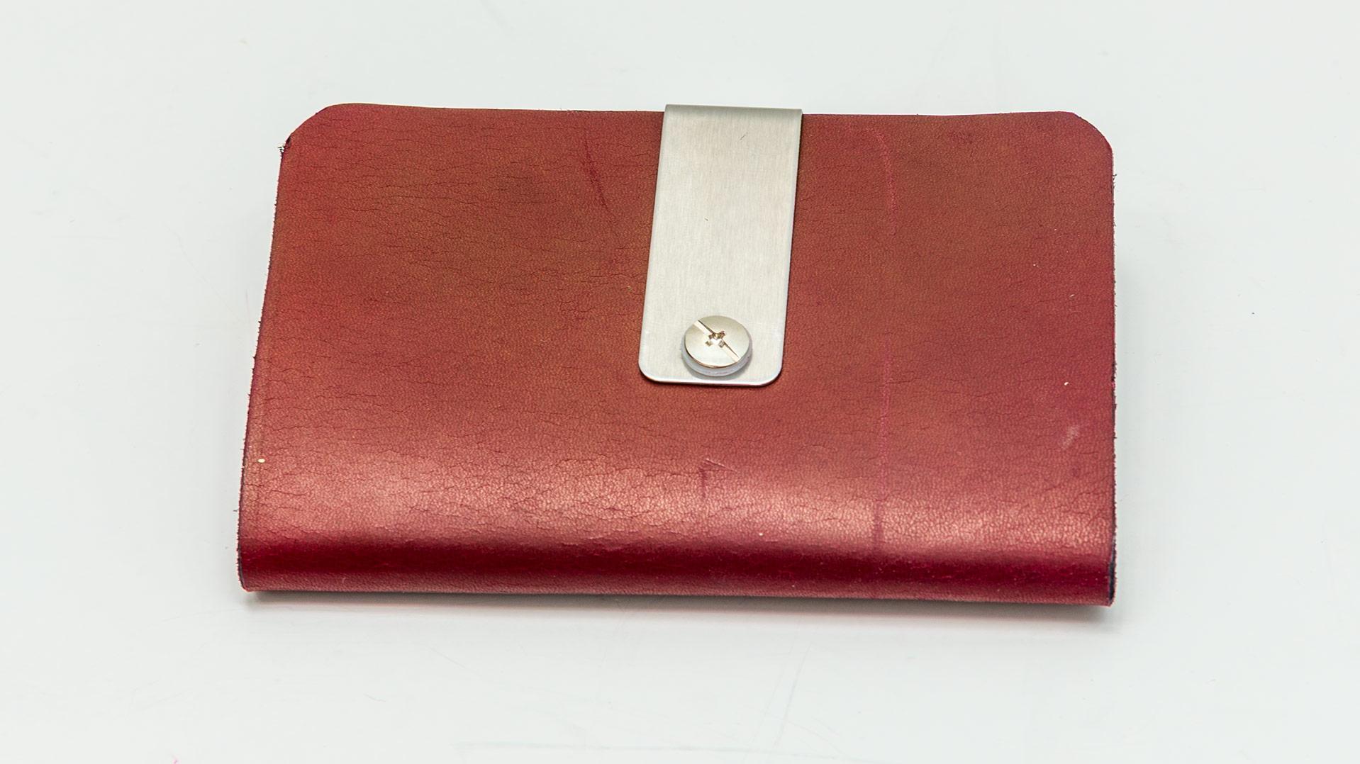

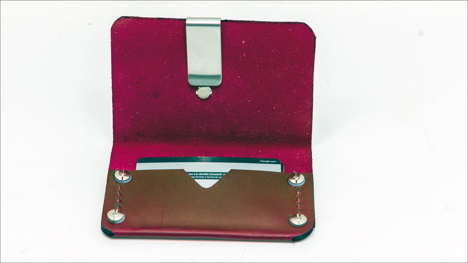

I decided to replace my current veg tan fold-over wallet. Not because it failed but didn't like how the copper rivets held up over the last 4 years. This was done over the last few days and will be my daily wallet which lives in my front pants pocket. I keep my wallet pretty basic, drivers licence, credit card, health card, dental card and cash. How I done it: i) Leather used was 4/5 oz natural veg tan. ii) The raw veg tan leather was airbrushed with 100% pure organic JOJOBA oil with no dilution at 34 psi on the exterior first and sat for 24 hours. iii) The oiled veg tan leather was airbrushed with OX Blood at a 50/50 dilution of dye at 34psi iv) The wallet pattern was cut, the cutout for the credit card was cutout and the fold over glued using LePages Heavy Duty Contact Cement. Let it sit for 24 hours under clamp compression. v) The wallet was cut to final dimensions, Chicago screws and corners were punched. vii) The interior was airbrushed with JoJoba oil let to sit for about an hour. viii) The interior was airbrushed with OX Blood at a 50/50 dilution of dye and sat for 24 hous. ix) The stitching in the credit card section was done with V138 bonded nylon using a Juki LS-341 clone with a 3D printed table top attachment x) The Chicago screws were installed in the credit card and the money clip. xi) The raw edges dyed I got to touch up a couple parts on the corners.
