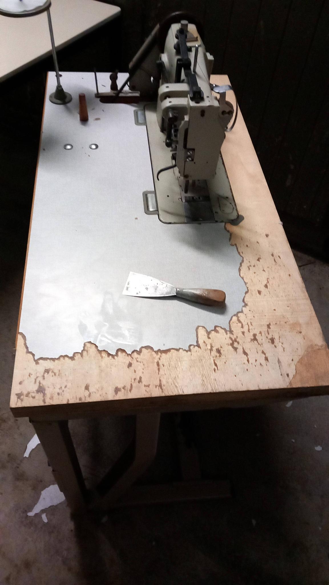

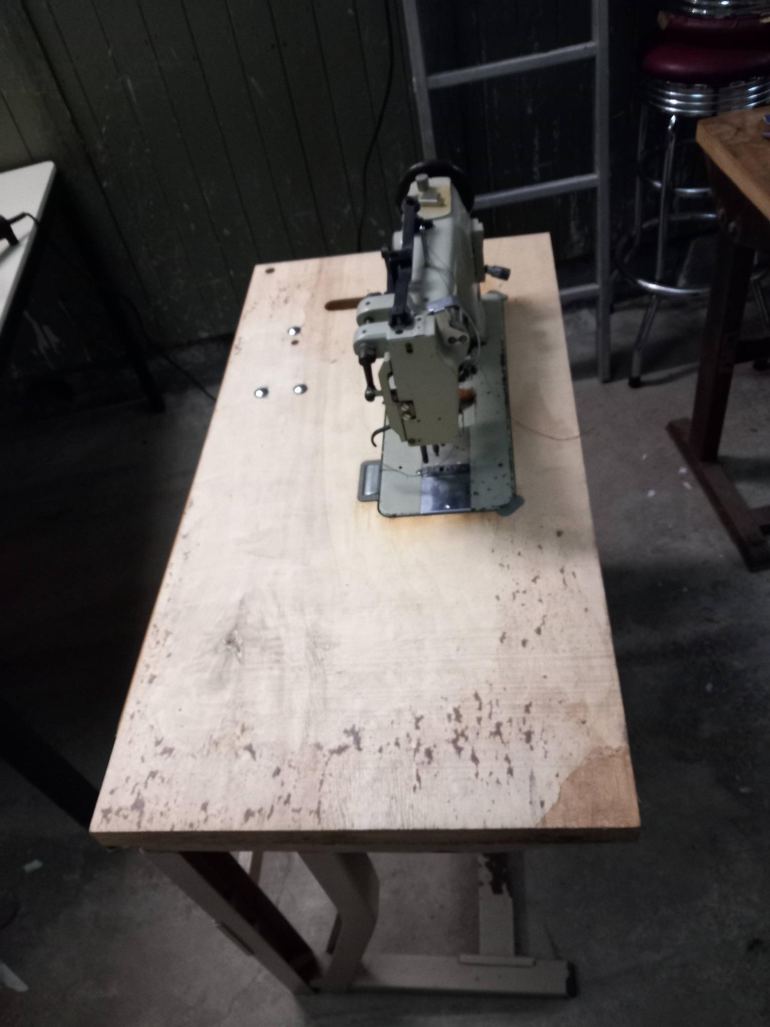

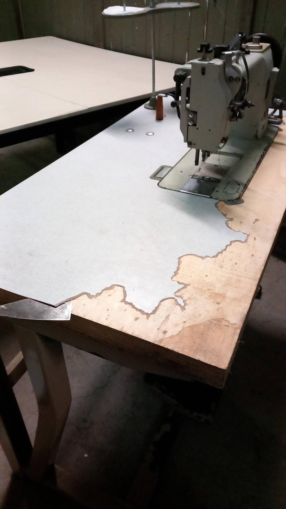

little update. wel a few updates. i got the right needles and learned whats what with those. i took of the tabeltop. it was damaged and ugly so got it down to the wood and waiting for a new top
